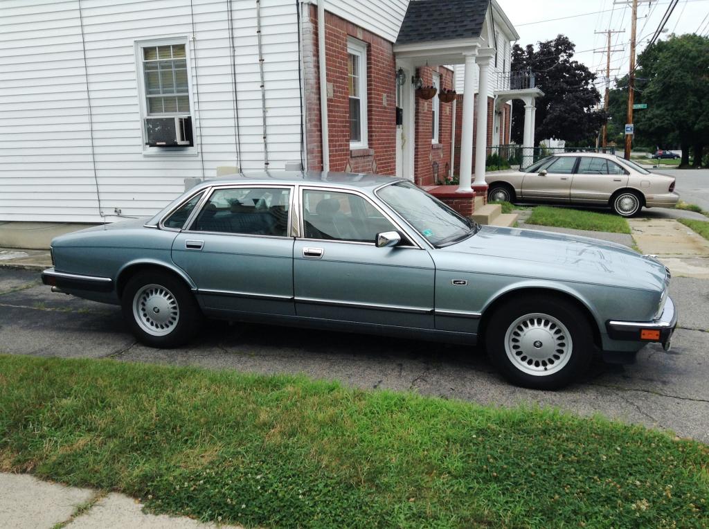

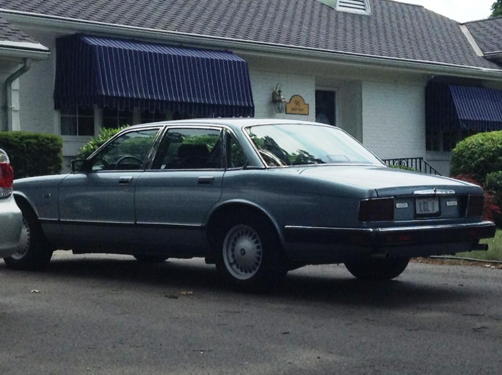

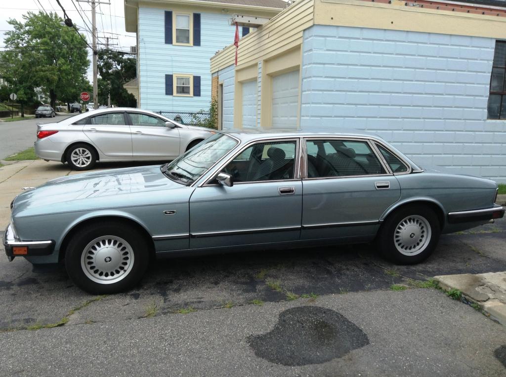

So went to see the car today. Drives amazing! Perfectly smooth ride. Car still has hydraulic suspension system, it has never been touched.
The only work they've done has been complete break job, costing $800. All records.
The car needs a windshield washer nozzle and antenna mast. Has a tiny rust bubble on the rear right D pillar near the chrome trim.
Wheels are perfect, tires are new. Slight puff of smoke, only lasts about 5-10 seconds. No smoke when driving. Transmission shifts well no issues.
Oil pressure on start up jumps up 3/4 on the gauge. After warming up, idling in park, right in the middle on the gauge.
Sunroof, windows, seats all work. Has 5 disc changer. No VCM codes I could pull up pressing the button. (I did it while the engine was running, can't remember if that matters with code retrieval). Air Conditioning works perfectly. Blower fans blow fine on high, both blowers should be functioning fine. All doors lock fine, and the automatic seat belts do too.
Pulled up the carpet in the trunk. It smelt a tiny tiny bit damp, but no rust or anything there. The chassis is very solid as well. All jack point plugs are there too.
Forgot to take pictures, snapped one in the car before I left.

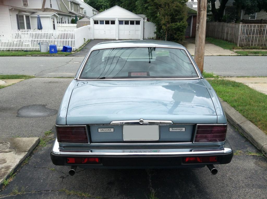

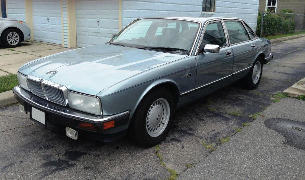

The car has been great. So far, I've replaced: spark plugs, distributor cap & rotor (plug wires are on order), Oil Change with Jaguar filter and drain washer, Differential Oil Change with Royal Purple oil, and Greased Axle U-Joints.
I just got back from a road trip to New York, about 700 miles round trip. The car was flawless the whole way.
There are a couple small things I'll need to address. The plastic coolant expansion tank is seeping very slightly at the seam. Also, I'll need to bring the car into the dealer to check the automatic seat belts, which are under lifetime warranty.
Other than that, small stuff. Windshield washer jets are missing. A washer cover was missing. Windshield has fine scratches where the wiper wipes, causing glare at night. Might need to polish it. Ordered new wheel emblems and a new center cap.
So far, so good!
