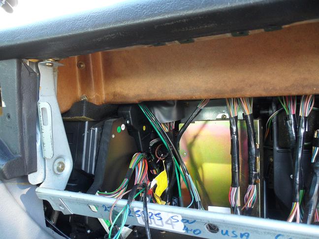

That is very helpful. Thanks. I will try that tomorrow if at all possible. I believe I can remove the motor/gear through the opening where the glove box was? The first pic shows the opening and the second the upper blend flap motor (outlined in white). This is the part I need to remove and check?

Yes! that is the servo motor that controls the upper rotating air duct.There is a lower unit that uses the same part so swapping them is also an option. Remove the A/C control unit (the grand piano looking unit) and it is behind it. The servos are held in place by (2) #1 pozidrive screws.
