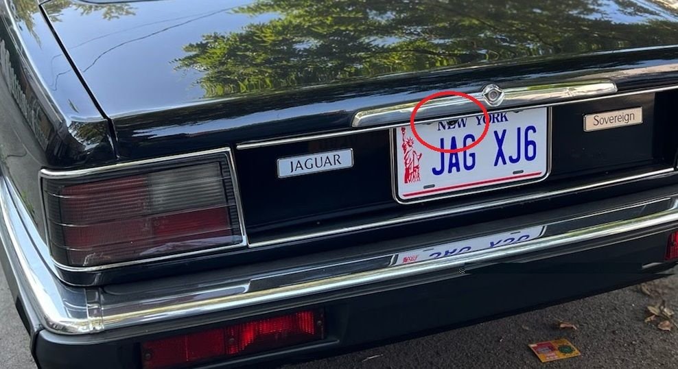

I didnt need to drill any holes into the car, just make one of the holes bigger to accommodate the camera mounting screw. I removed one of the 4 screws holding the metal trim under the trunk lid where the latch is to open it and placed it there so as to not affect the ability to revert everything back to how it was originally if i ever wanted to. I included an image below.

Heres a better picture on where I placed it using an existing screw hole.
