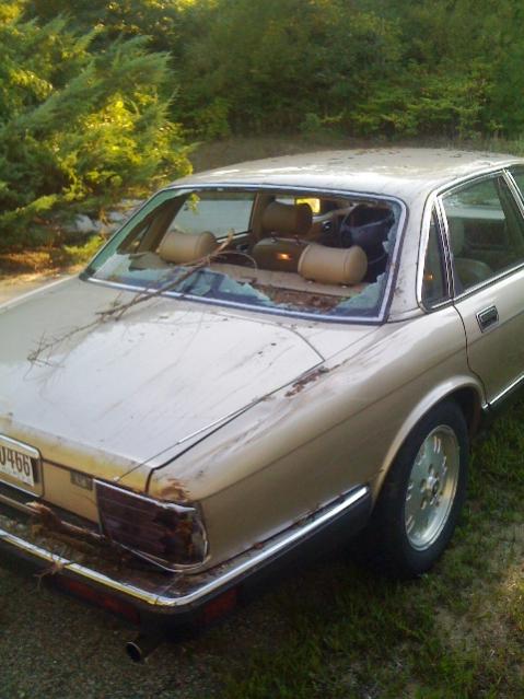

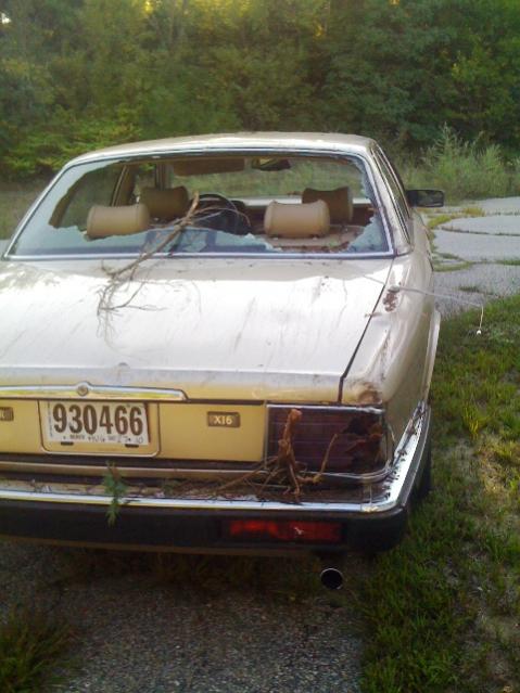

Old Aug 28, 2010 | 06:46 PM
mrtalkradio's Avatar
Posts: 863
Likes: 106
From: New Hampshire
Default Have a Nice Day!
What a lovely sight when you take your car home to show your wife huh??
Old Aug 29, 2010 | 03:41 AM
Thank you for posting the pictures, I only wish that you had not needed to.
At least no one was hurt.
Keep us posted about the repairs, and certainly if you get to the bottom of it, let us know why it happened.
