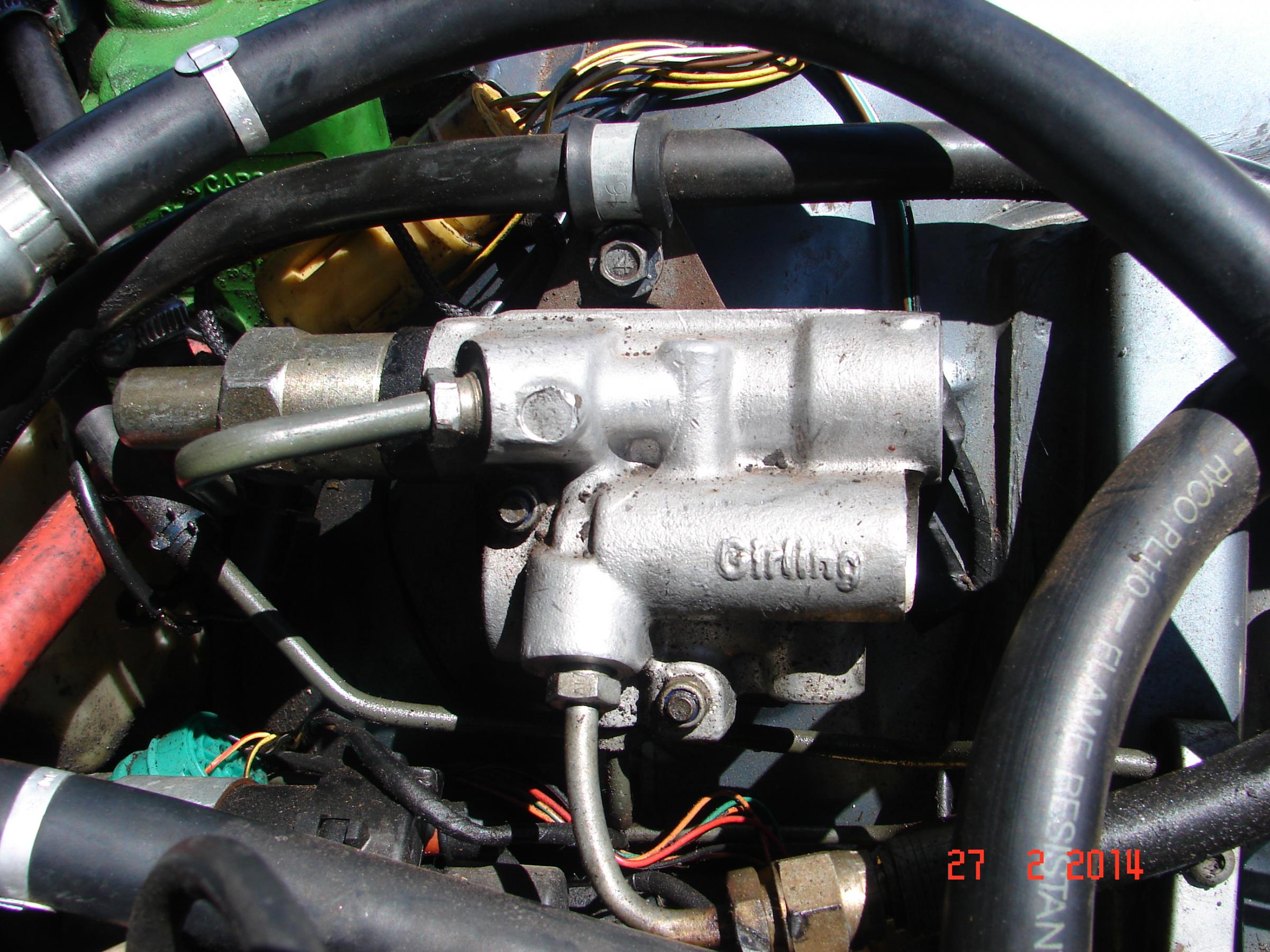

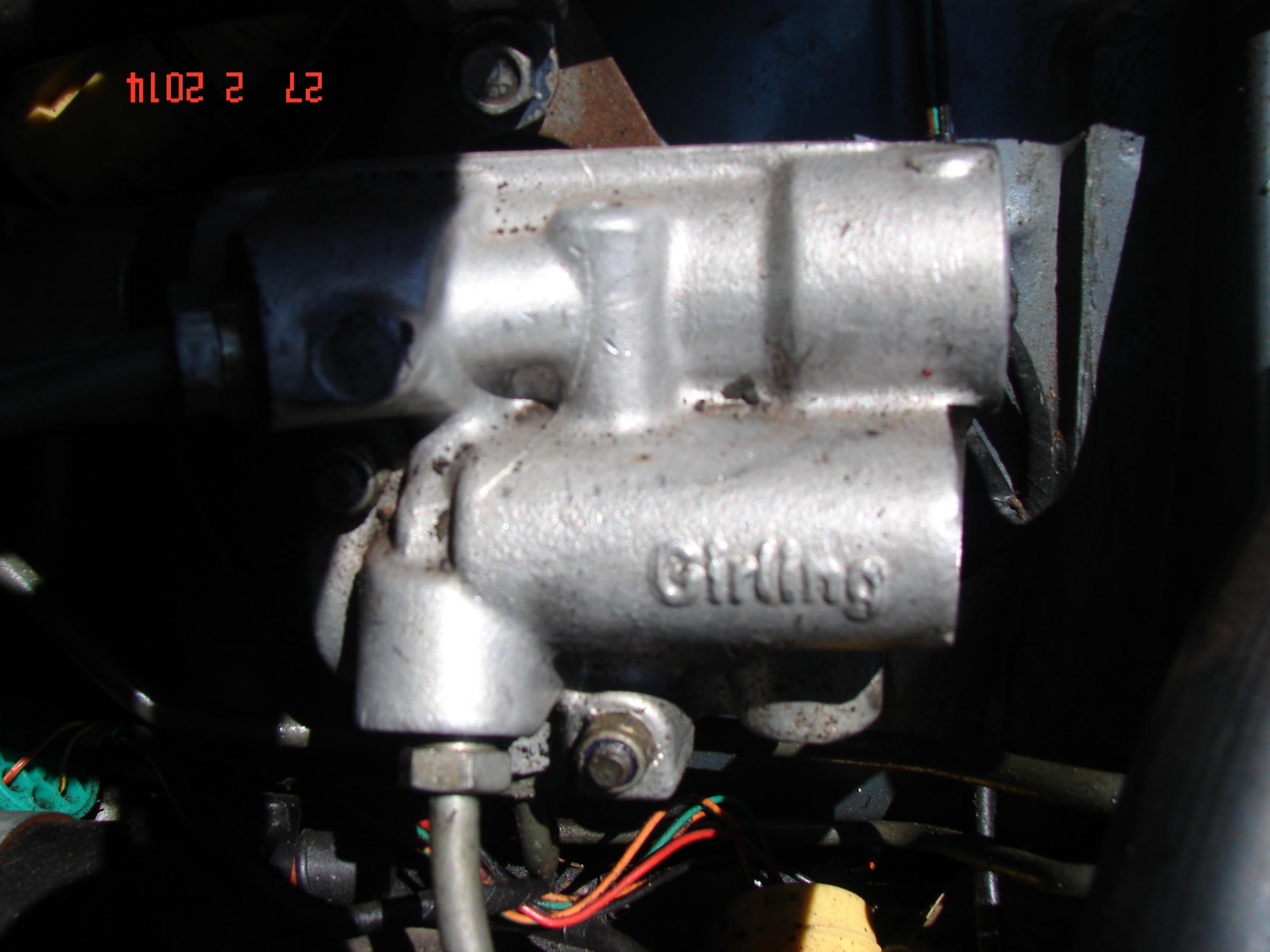

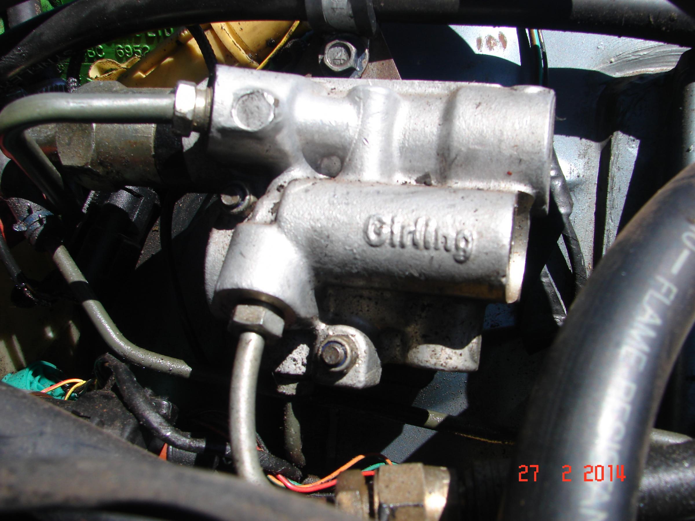

I still haven't had the chance to jack her up and look under yet... So I will confirm later as to presence or lack of SLS.
After preliminary checks (just under the bonnet) it does appear to only have three brake lines running along the subframe and down the firewall and under the car... there is also a couple of mounting brackets that cater to five lines but only three are occupied.
Looking at the valve block, again this looks to have the rear line missing also. I found the reservoir indicator you mentioned and after giving it a wipe so I could see it... it is indeed red....

To attach pics, there is a little paper clip icon in the posting window (the window that opens when you reply to a post)... see it up there just right of the little smiley face? click on this, it opens a new window where you can browse your files and upload your pics... easier said than done!
Yep, my suspicions are correct. The red indicator tells me that you don't have much, if any, green fluid HSMO in the system. Chances are all your seals will be kaput because of this and chances are if you do add any fluid then it will just leak out of wherever the leak may be. Also explains your dash warnings and the hard brakes that you describe...
Time to rip it all out and replace it with a more reliable Vacuum system. Let me know when you get started on the project and I can try and help you with any hurdles that you may come across... I.e. finding somewhere on the manifold to take your vacuum from. Some engines have a little hidden plug that is blanked off just for this very purpose.... some don't and you will need to drill one...

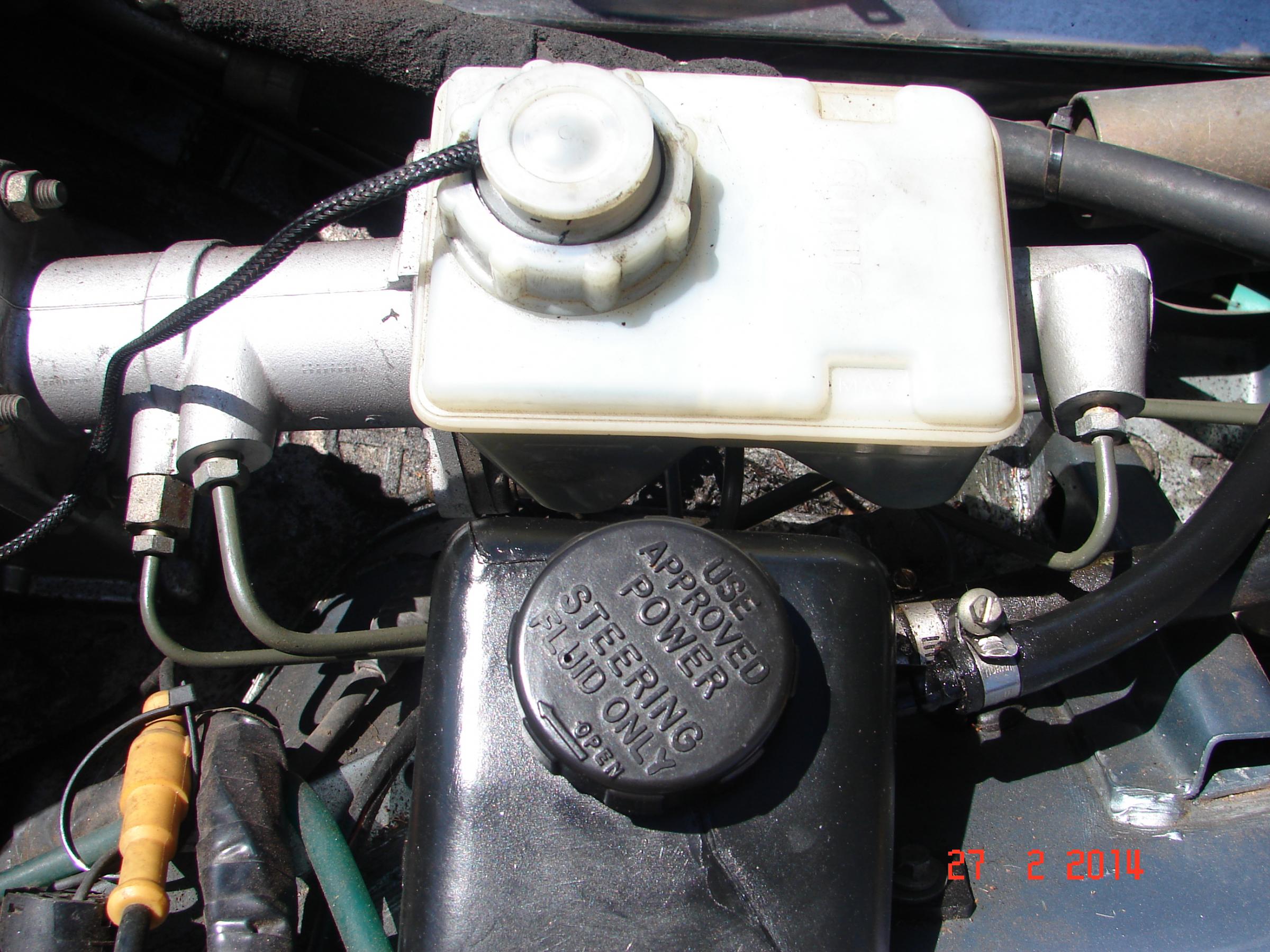

I have uploaded the pics of the master cylinder and the valve block

I looked again at the link on ebay and see it does in fact come with all the necessary adapter plate and the blanking plate for where the pump is removed.
