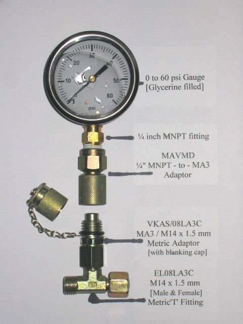

You can replace the filter baskets in the injectors with the proper Bosch kits. I think in the photo albums at the link in my signature there may be some photos of a puller I made to remove the old filters. I may also have photos showing how I clean injectors with Techron Concentrate Plus Fuel Injector Cleaner under 20 psi of pressure while activating the injector solenoid repeatedly. There are now inexpensive fuel injector actuators that make this easy. I have something like this and it works great:
https://www.ebay.com/itm/126185223113
I think I remember that you've checked the Fuel Pressure Regulator vacuum fitting for the presence of wet fuel. Have you figured out how to test the fuel pressure? The XJ40 requires some metric fittings to tap into the fuel lines nondestructively. Bryan N of the Jag-Lovers forum came up with this:

Ah yeah I have one of those. I planned on doing the filter baskets as well, I made up a little thing for getting them out back when I rebuilt my XJS fuel rail.
I figure an hour or two in the ultrasonic cleaner, plus some solvent or injector cleaner being blown though while actuating, and we'll see if it makes a difference. I'm betting no, but we'll have to wait and see, most likely sometime next week before I get around to it.
As for testing the fuel pressure, I just cut off the crimped collar at the end of the feed line to the rail, and used my gauge with two barb fittings connected to the old hose on one side, and a new piece of fuel injection hose on the other. Same thing I did when refurbing my XJS rail, just slid the hose back over the barbs, and secured with a fuel injection clamp instead of the old crimped collar

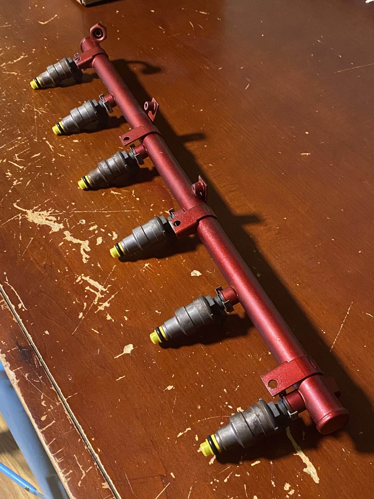

While I await the injector kit, I pulled out the rail and injectors to get started on cleaning.
The inside of the rail looked fine, no debris came out while flushing it. Smelled like varnish though.
The injectors were interesting. The tips of the actual injector looked clean, but the pintle caps were all covered in a thick layer of sticky varnish. I took each injector, hooked up 2 feet of fuel line to each, connected the injector to my little pulse machine, filled the line with some strong cleaner (acetone, toluene, etc), and flushed each of them with an air hose connected to the line.
3 of the 6 immediately had a nice spray pattern. The other 3.... they weren't blocked, but were just shooting a stream, not a nice atomization pattern. I flushed each injector with my mixture 3-4 times and they now all have good clean spray patterns.
I was going to toss them back in the car as-is to test, but fell asleep with them in the ultrasonic cleaner... and forgot to take the o-rings off before I put them in there with my industrial cleaner. They didn't like that as you can imagine, the o-rings didn't survive overnight in the tank. The kit is on the way, new o-rings, pintle caps, etc. I'll have an update probably Thursday, I believe that's when they'll be delivered.

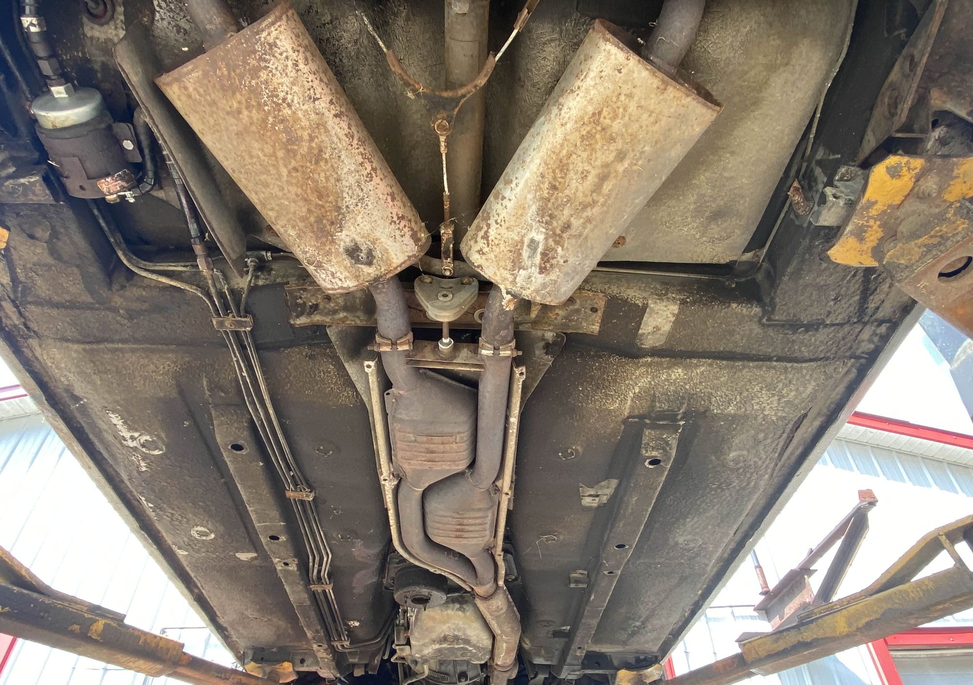

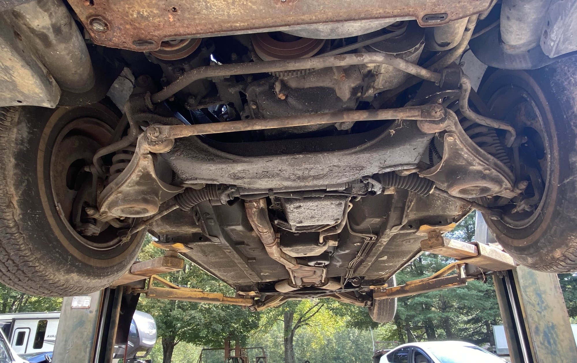

I looked at the diagrams and didn't really see anything that looked similar. I'm going to see about getting it on my friends lift and investigate where exactly the issue is and if I can easily cut/flare/union/etc it.

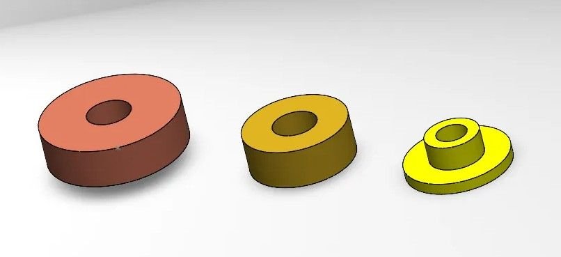

As for the 3D printing, I printed new bushings for the rear upper shock spacer donuts. I just bought the tophat bushing (CBC2933) because they were cheap and readily available. The spacers seemed to only be available through a couple of places (SNG and maybe Moss) and were bewilderingly expensive for a couple of pieces of foam... so I 3D printeed new ones out of TPU (polyurethane). I put the files on Thingiverse and Printables if you wanted to have a look, shouldn't be hard to find.
