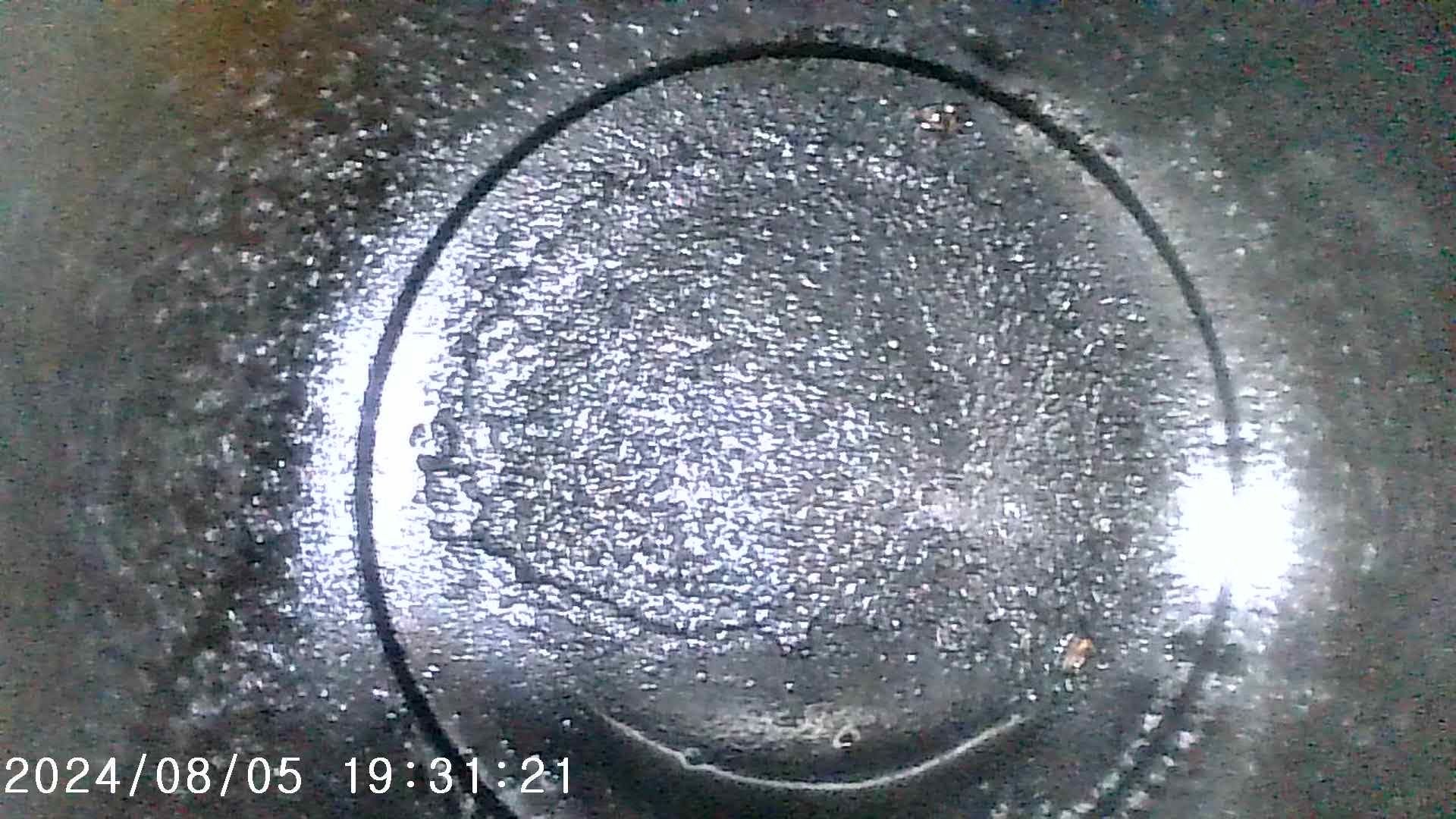

Thanks Guys. I finally found a credible local shop. Unfortunately looks like I need an engine rebuild :-( Super surprised as the previous shop said the engine compression test was excellent, then took me for over $4k to rebuild my rear differential (which i only did on the basis of a strong engine.). Insult to injury, the new shop were very surprised why the back end would need rebuilding, given the awesome condition of the Jag. Now I need to figure out to sell it as a mechanic project or LS swap it..... Rough classic owner day for sure :-)

@redtriangle that is why I'm so perplexed by this. I've owned the car for a few years & spent continually to keep it reliable as a daily driver. Having recently put over >$6k in work, as I was reassured by the shop that the engine was in tip top shape. It has around 140,000 miles. I'm finding it challenging to find knowledgeable folks in the region, & not being very mechanically minded, I'm rather unsure what is what now. Whilst I'm hesitant to do so, I might have to bite the bullet & sell it as a project car.
