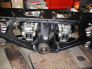

I have added a photo of my IRS.. note parking brakes in middle upper (two)
You should be able to compare to your IRS.. there is a cable that pulls the
pads that should be a easy rig for your application.
As mentioned, contact David at Everyday XJ for any needed parts.
