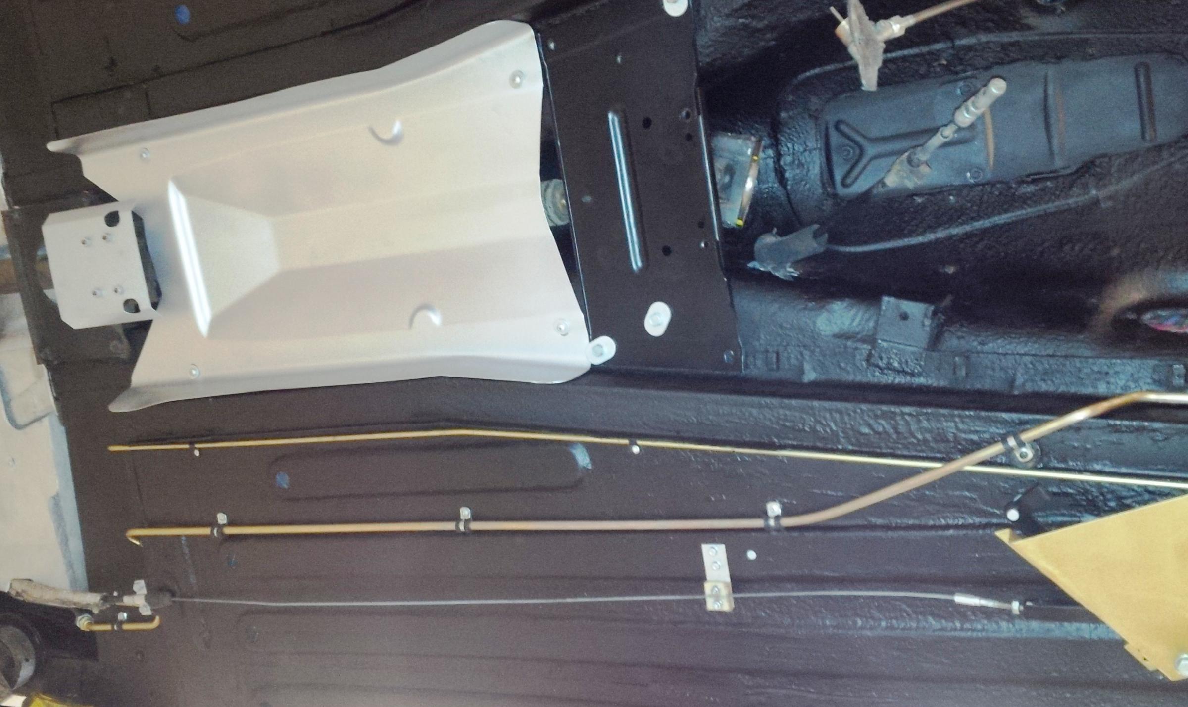

Hi Guys, Last weekend was full. 3 days non-stop.
The floor is getting some colors. The restored accessories look so great on a brand new undercoated surface.
We painted the gas tanks and we made the some new heat shields for the rear mufflers. (I didn't had the pics but I'll upload them too).

Thanks! If everything works as we expect... by the end of the summer. We have been working on the project for the last 54 weekends... and everyday at night for few hours. We really need finish the project. It is a very complex car. Lots of parts and each part needs work.
Tomorrow we are going to the muffler shop to fix some stuff... the exhaust is in pretty good shape but somebody welded the pieces.... we want to use the original clamps.
I'll keep you update.

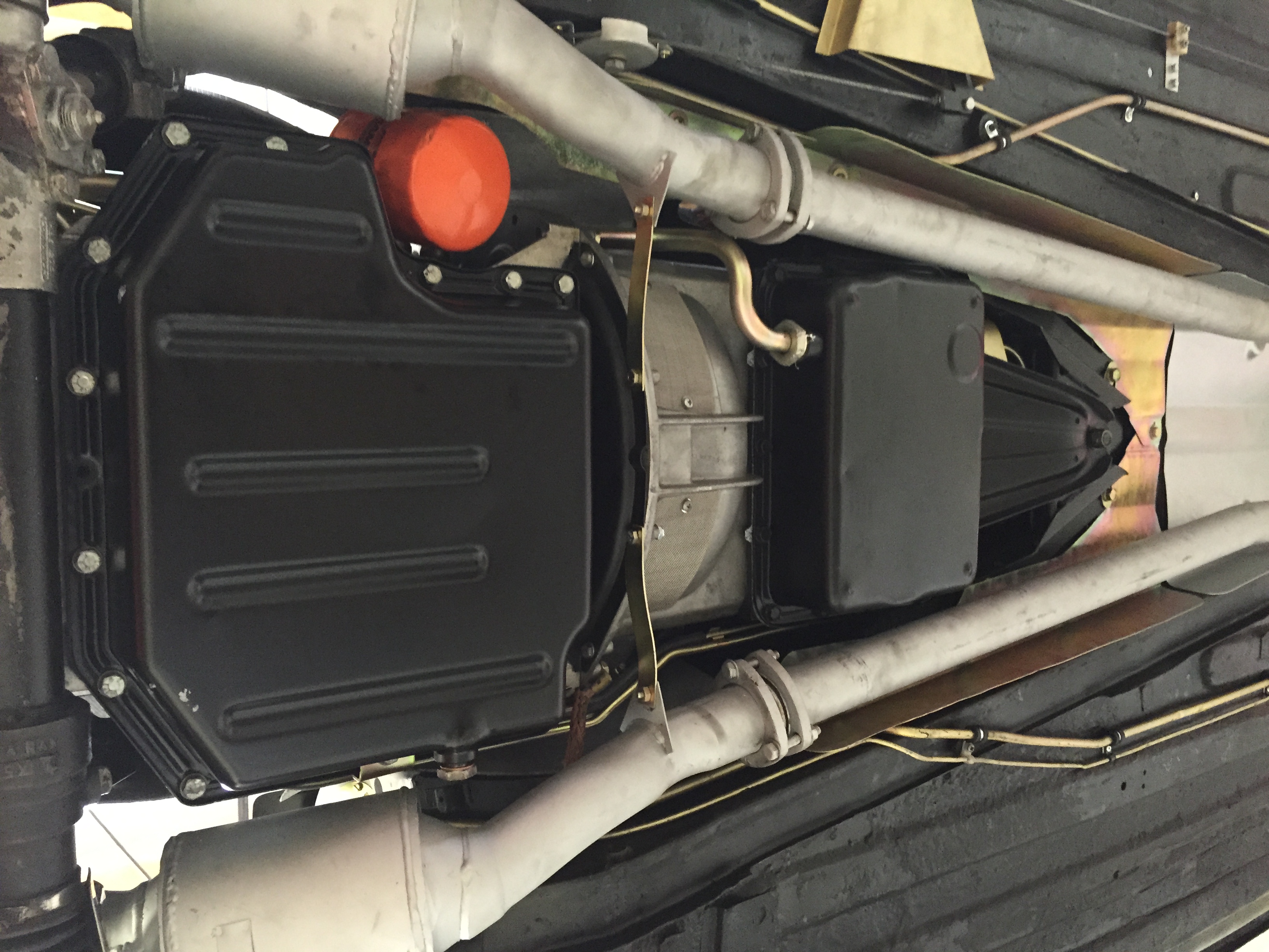

Hi Carl,
No, the entire exhaust system is in pretty good shape but the right pipe that is between the catalytic converter and the first muffler was 'home made' with some kind of water pipe or similar (very heavy!) and the ends were bad. Plus the unions were welded and I didn't like them. So, Mr. Ricardo from Dual Tone shop in Pacific Beach made a complete pipe with the same shape. Then I also brought the muffler and he adjusted the ends for a perfect fit. It looks nice.
Today I've installed all the brake and fuel lines and tomorrow I'm going to hang the exhaust on place, although I'm not going to final tight it till the engine and new the catalytic converters are on place.
Thanks to follow every detail of my project Carl

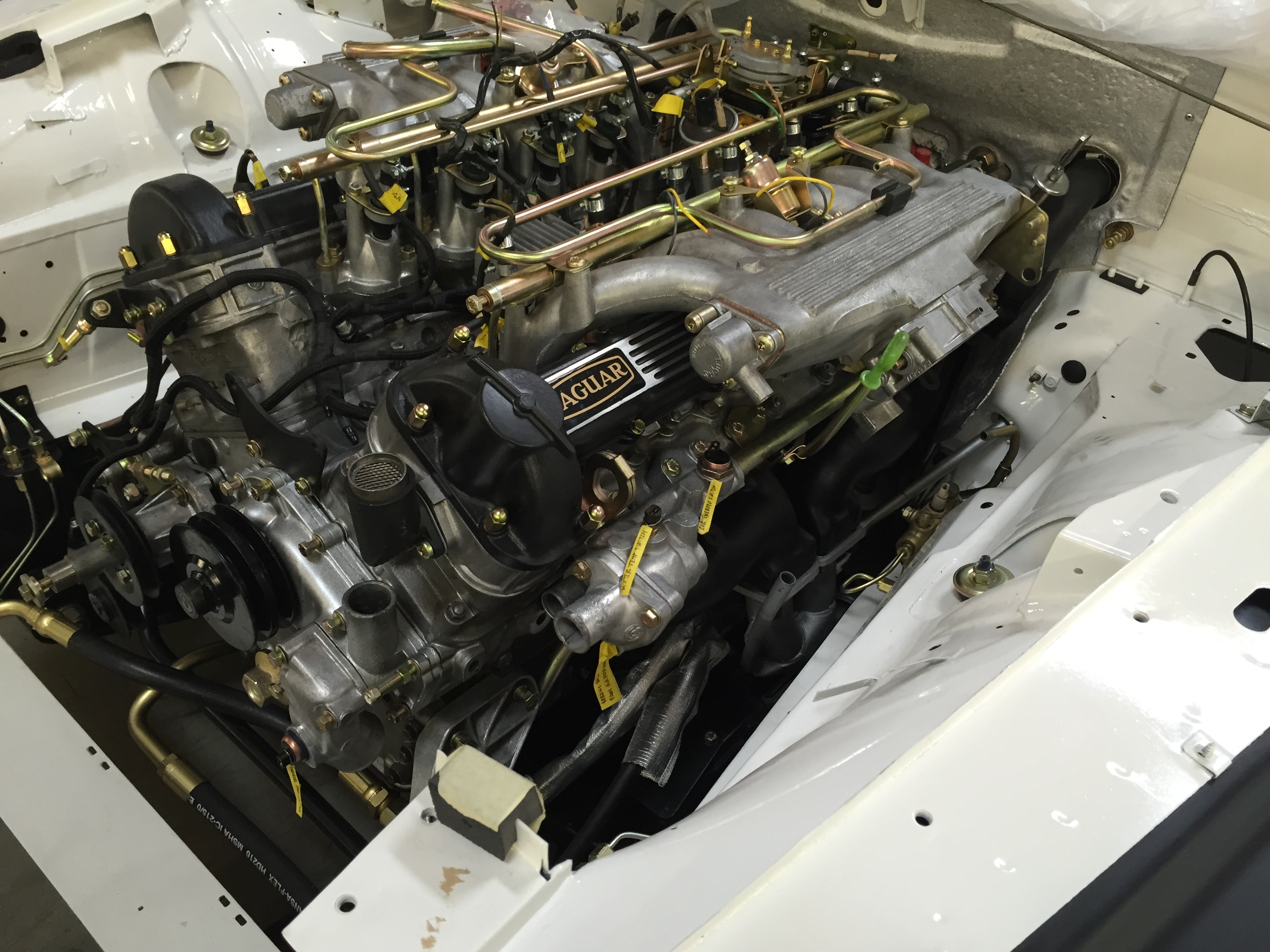

The engine is finally going back into its place! It was a very intensive weekend.

That is absolutely the cleanest engine bay that I've ever seen. Fabulous. An example for all.
Kudos +++++
