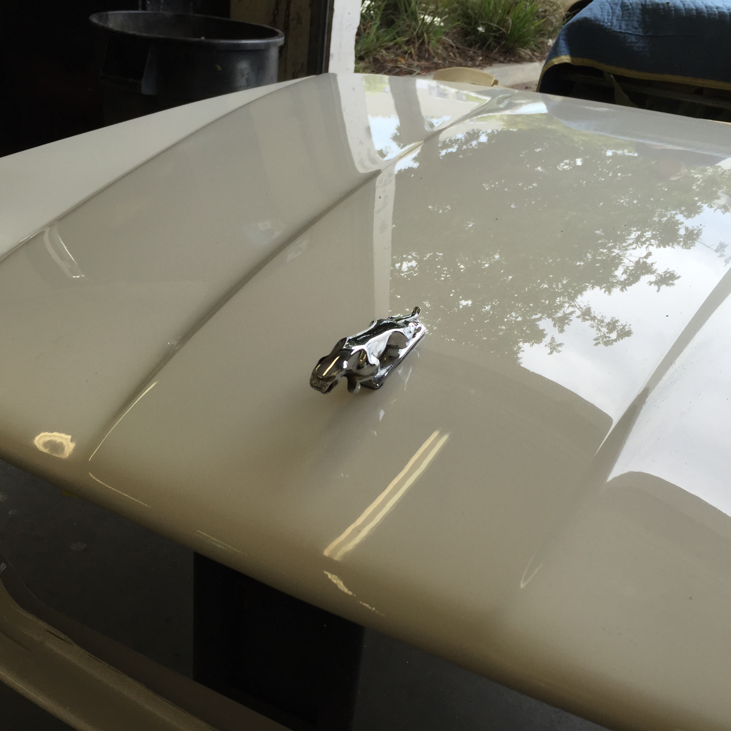

Smile The Jag in on!
The color sanding and the buffing was good! look at the hood, mirror effect

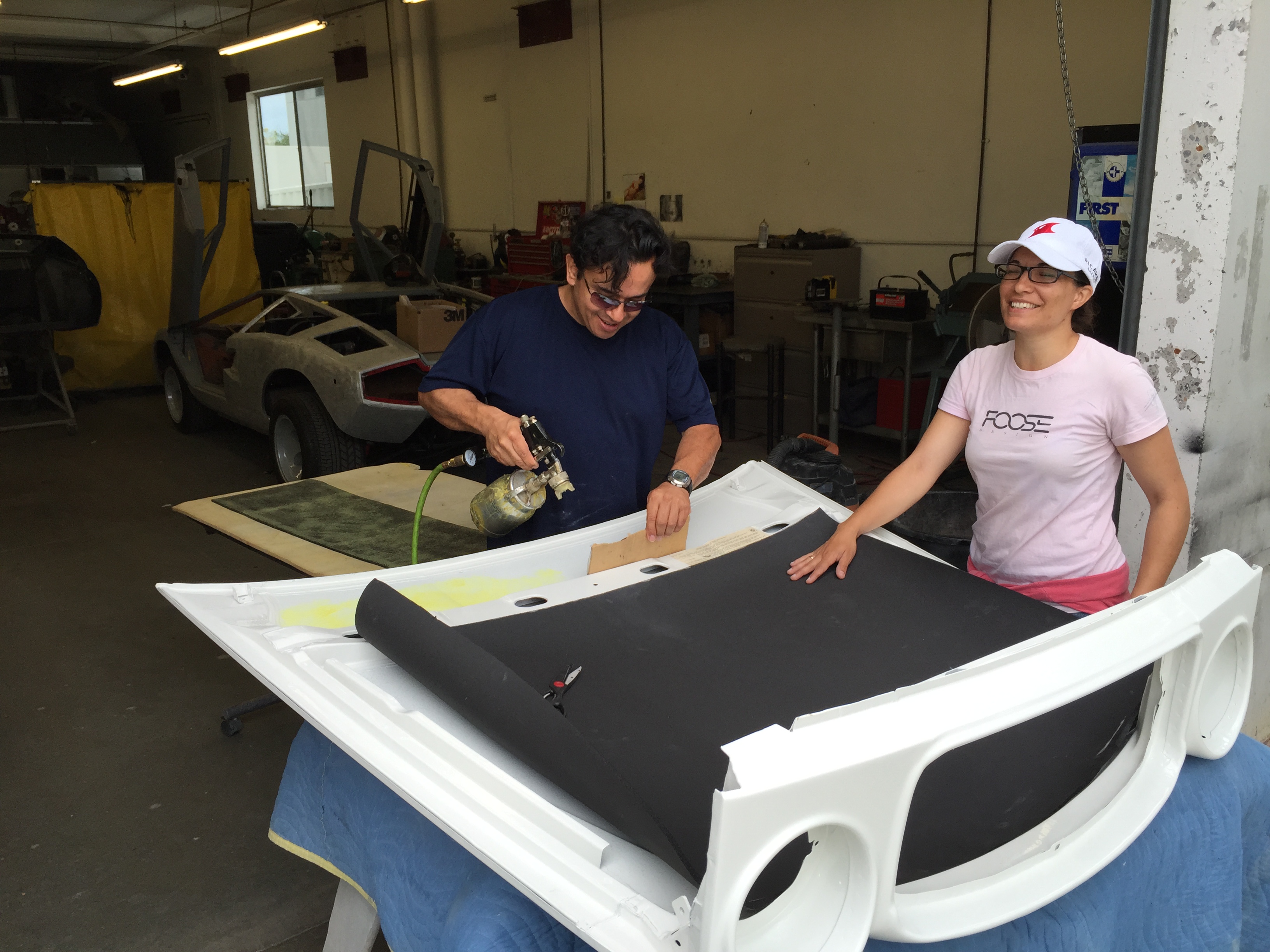

Default Hood liner
Joy from Euro trim gave us a hand to install the hood liner ( same stuff than the famous Jose used to install).

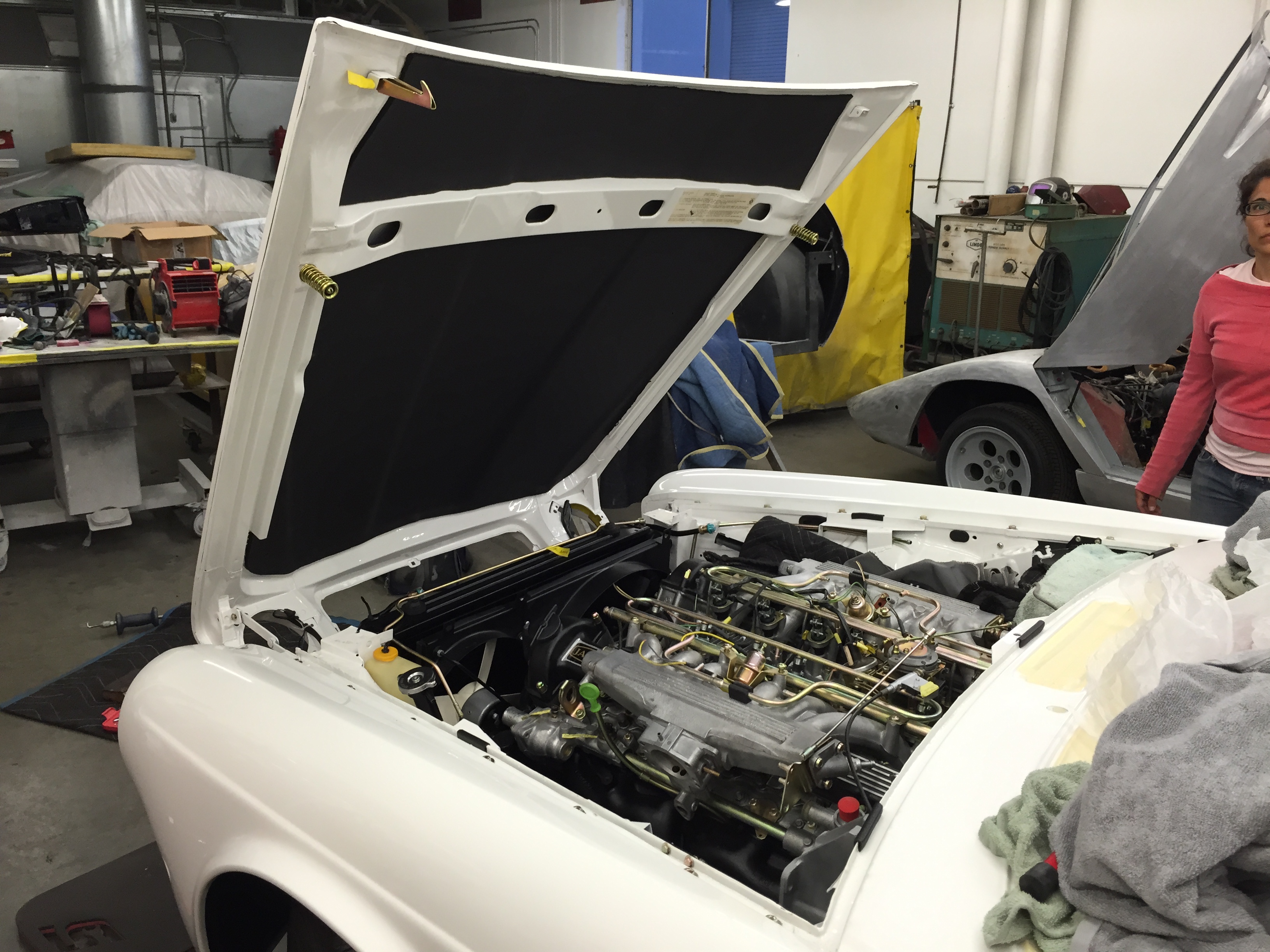

Cool together
We had some work to adjust the hood with the new euro hinges.

An experienced Jaguar master on another forum came up with a really slick way to align the bonnet/hood. Remove the grill. Work through the opening to attach the hinges to the bonnet. Loosely at first. Move the hood around til it is ion its best alignment. Then secure the bolts, through the grill opening. Open the hood/ bonnett. Install the grill.
A mostly all gal effort, huh? Slick.
So much nicer to work on clean parts.
