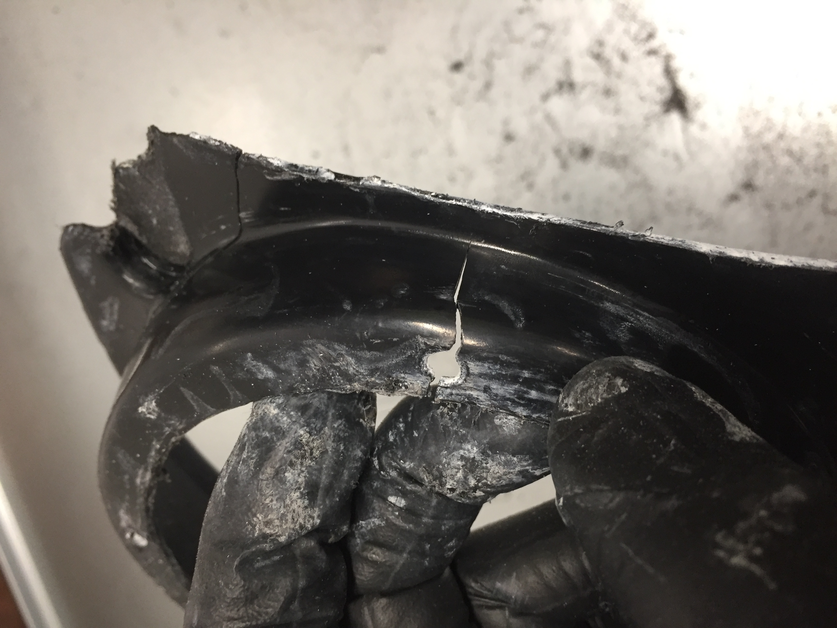

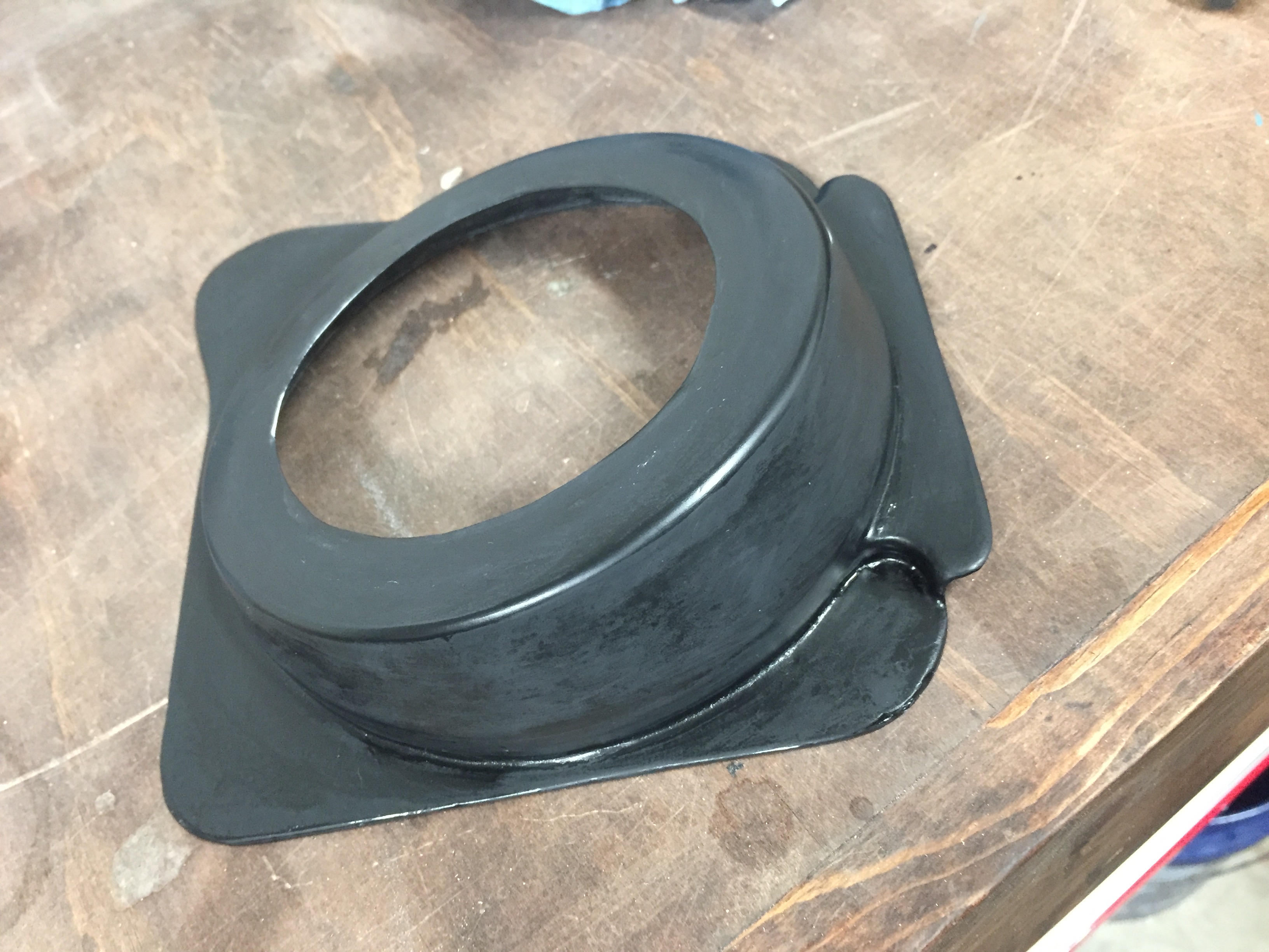

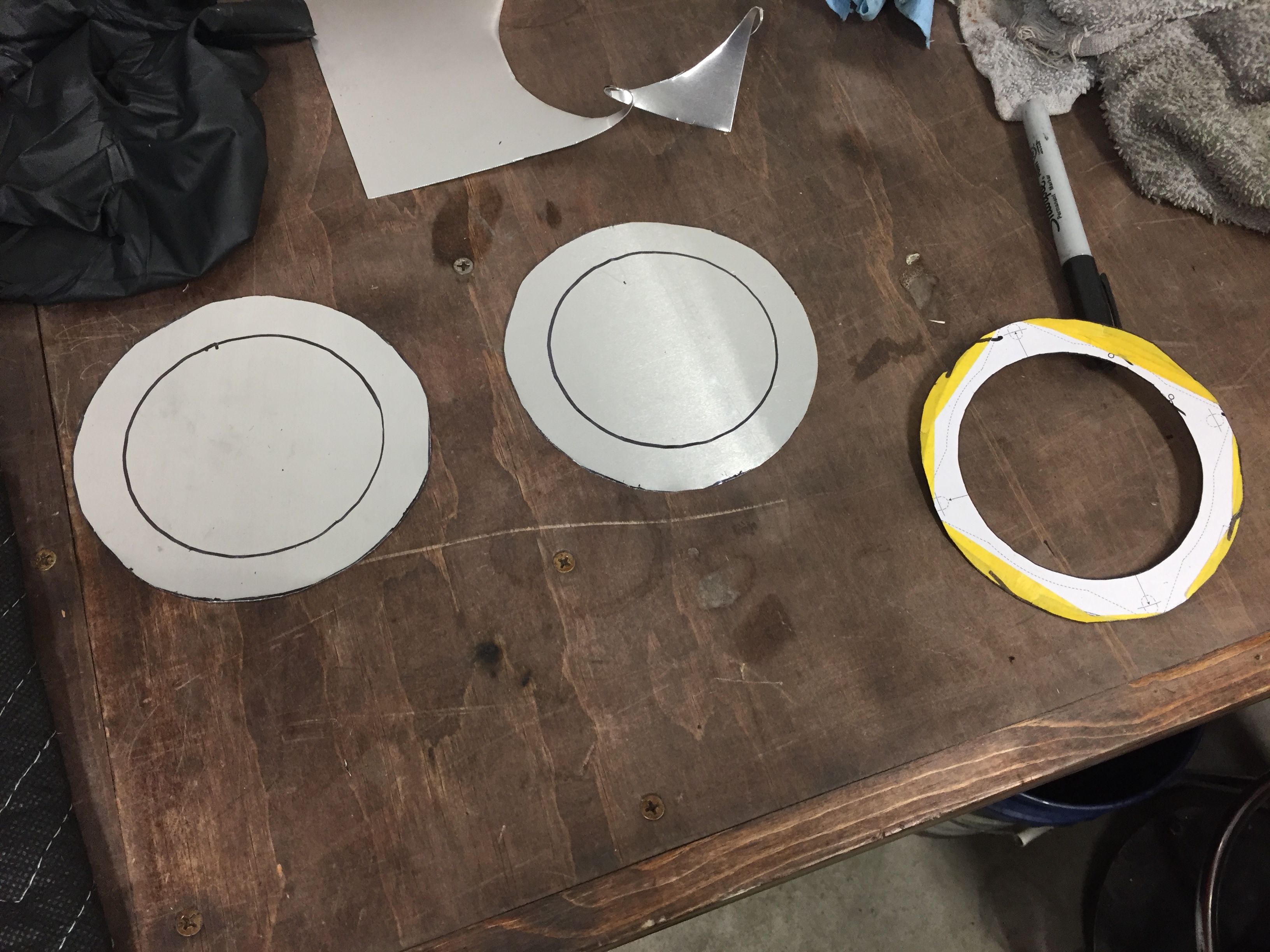

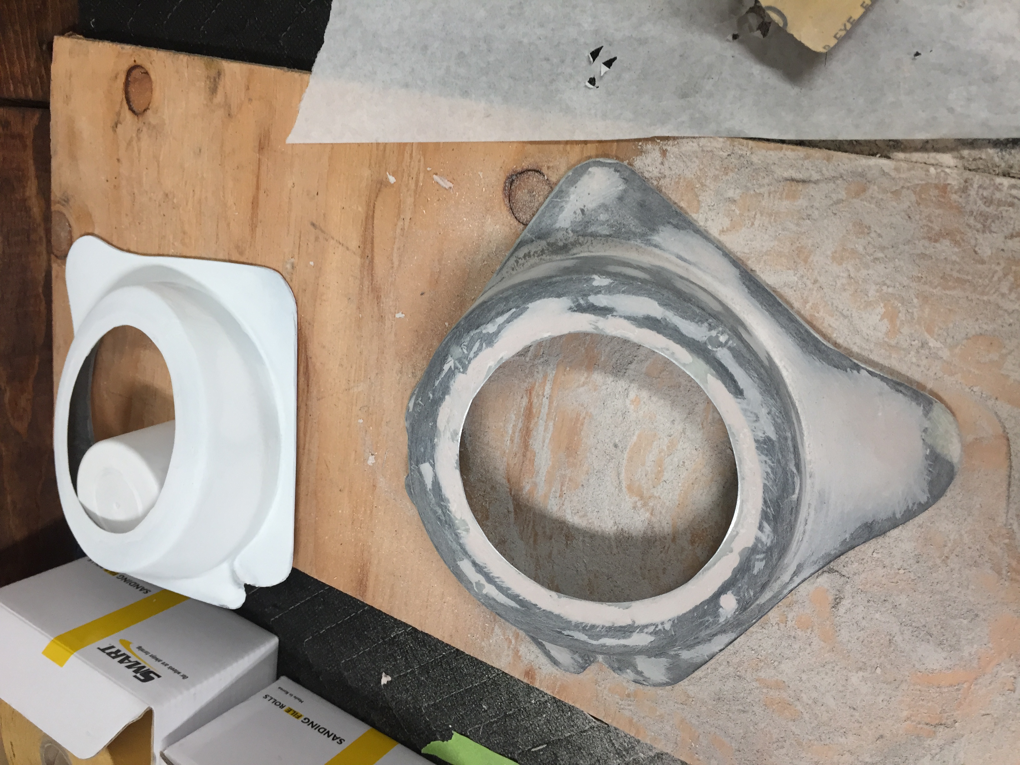

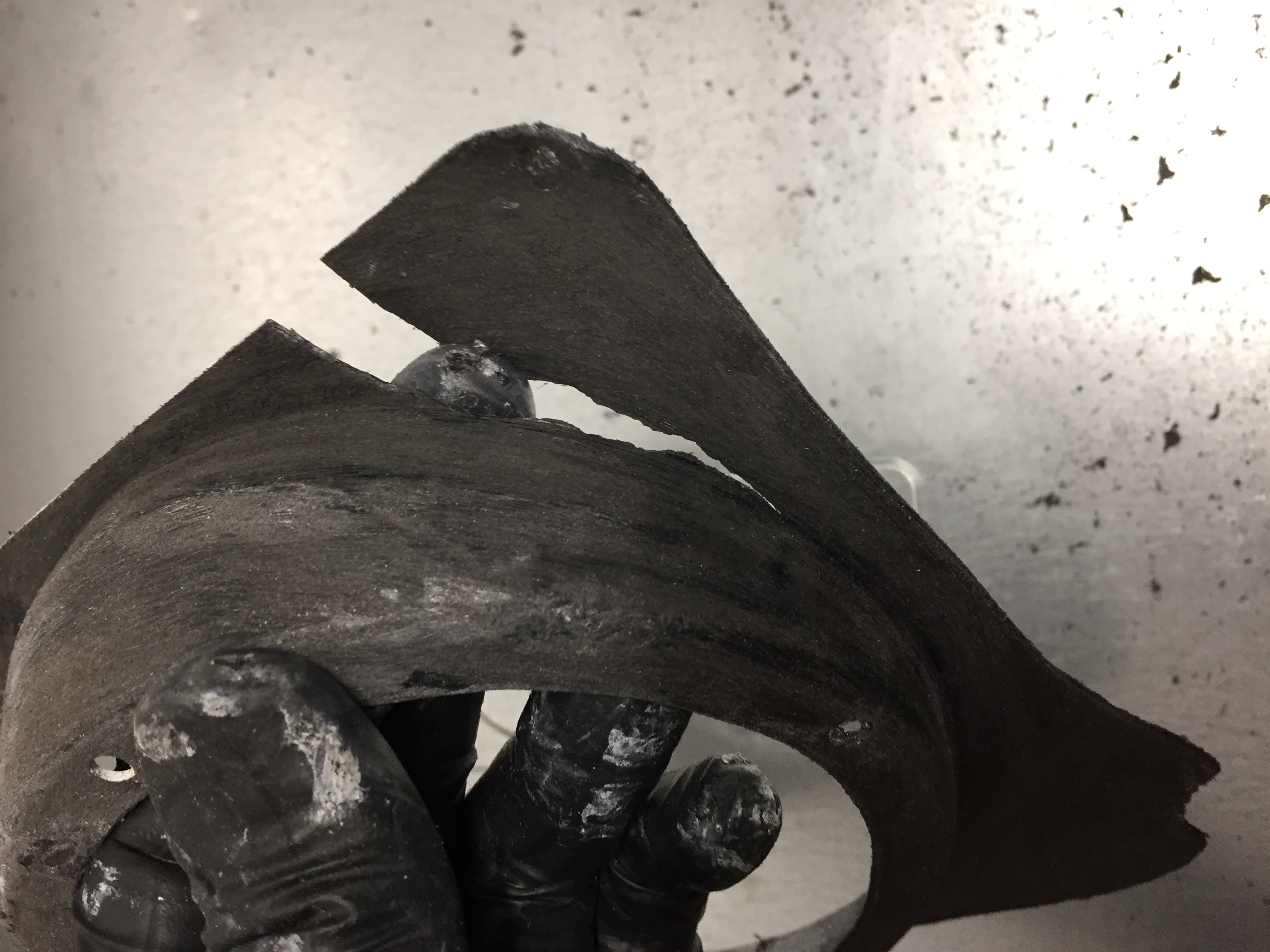

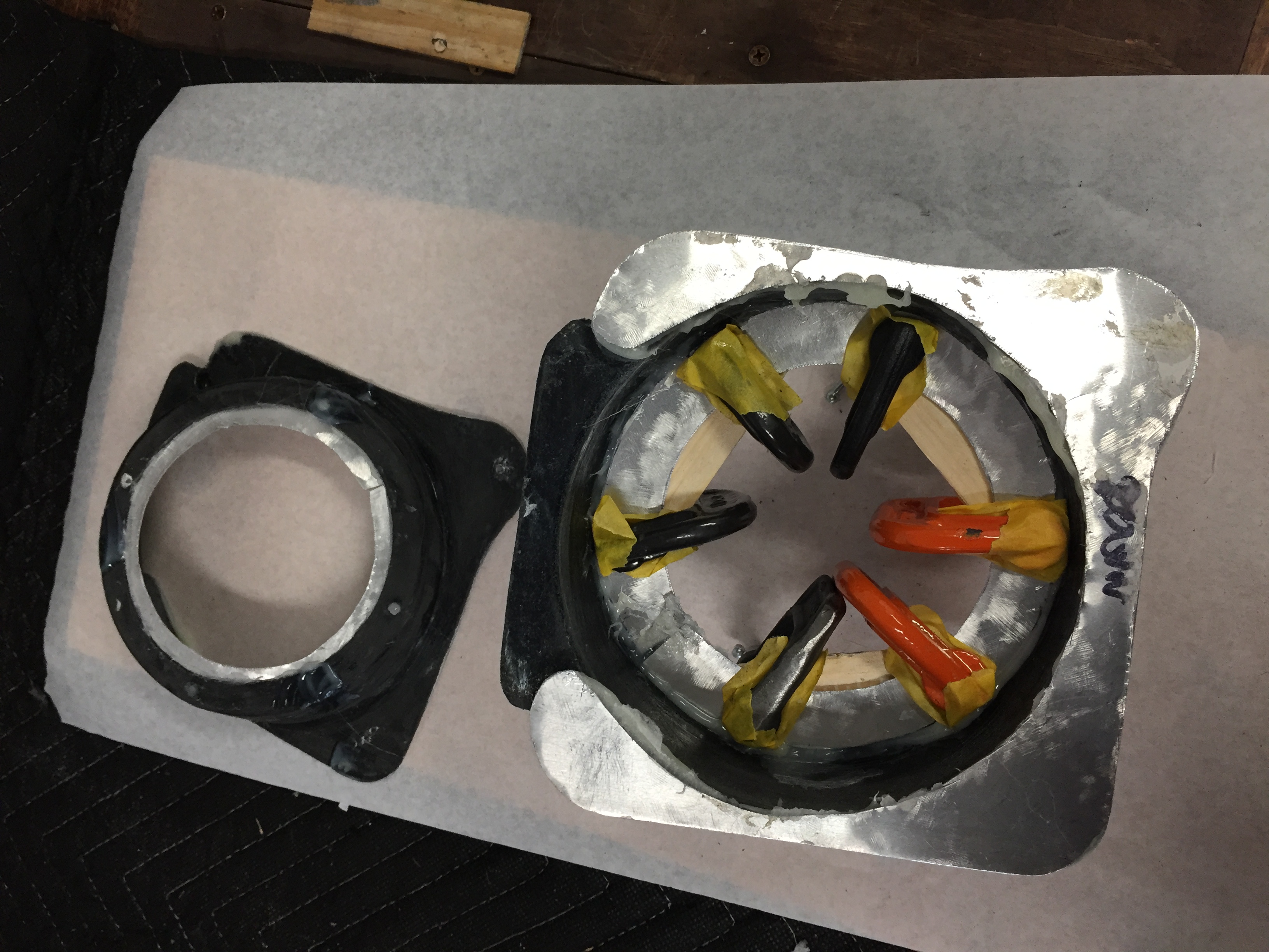

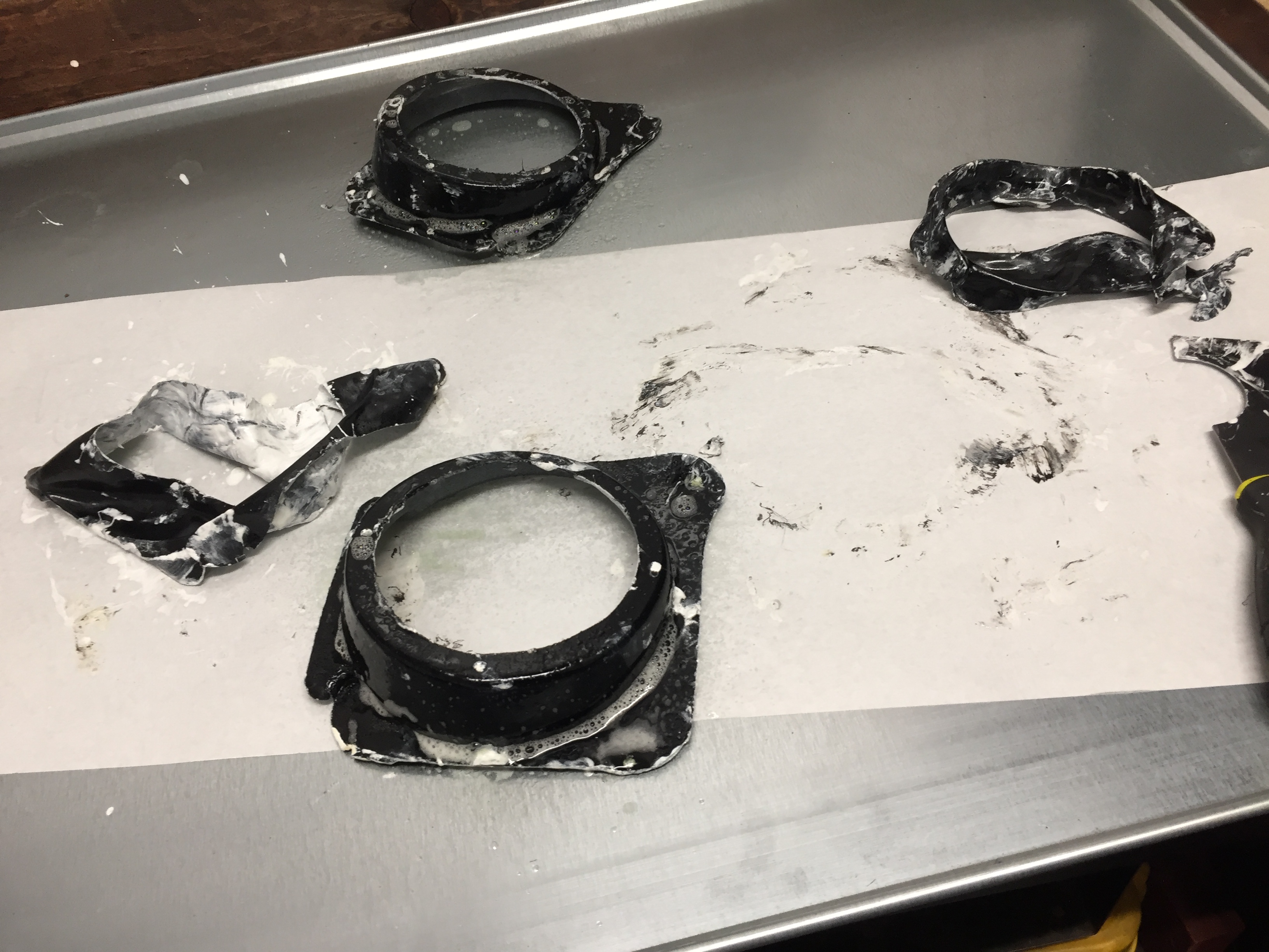

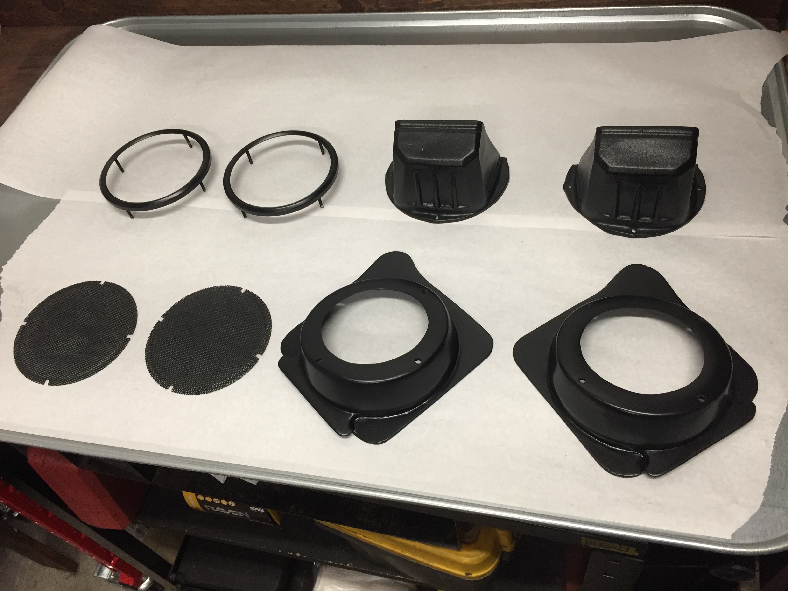

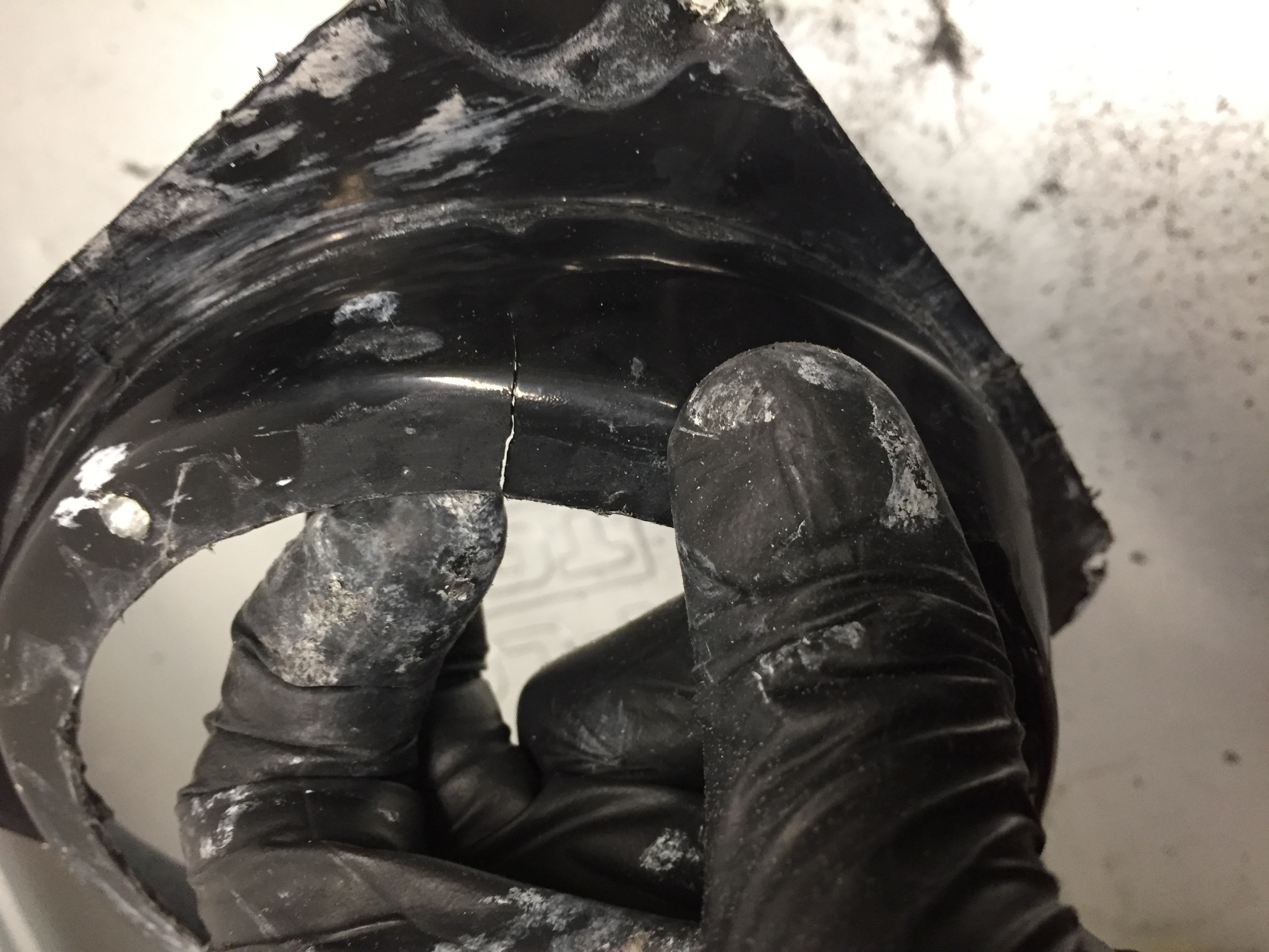

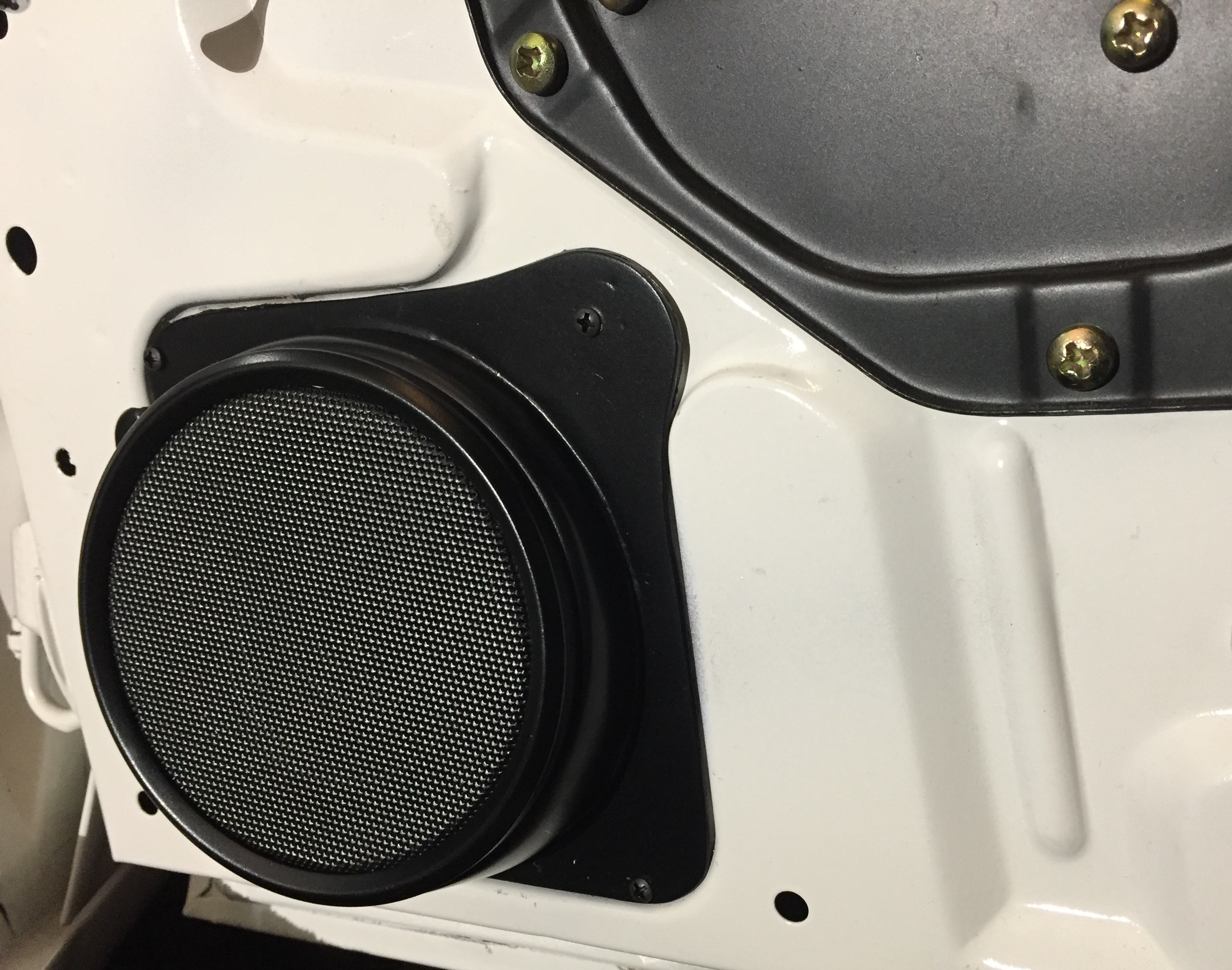

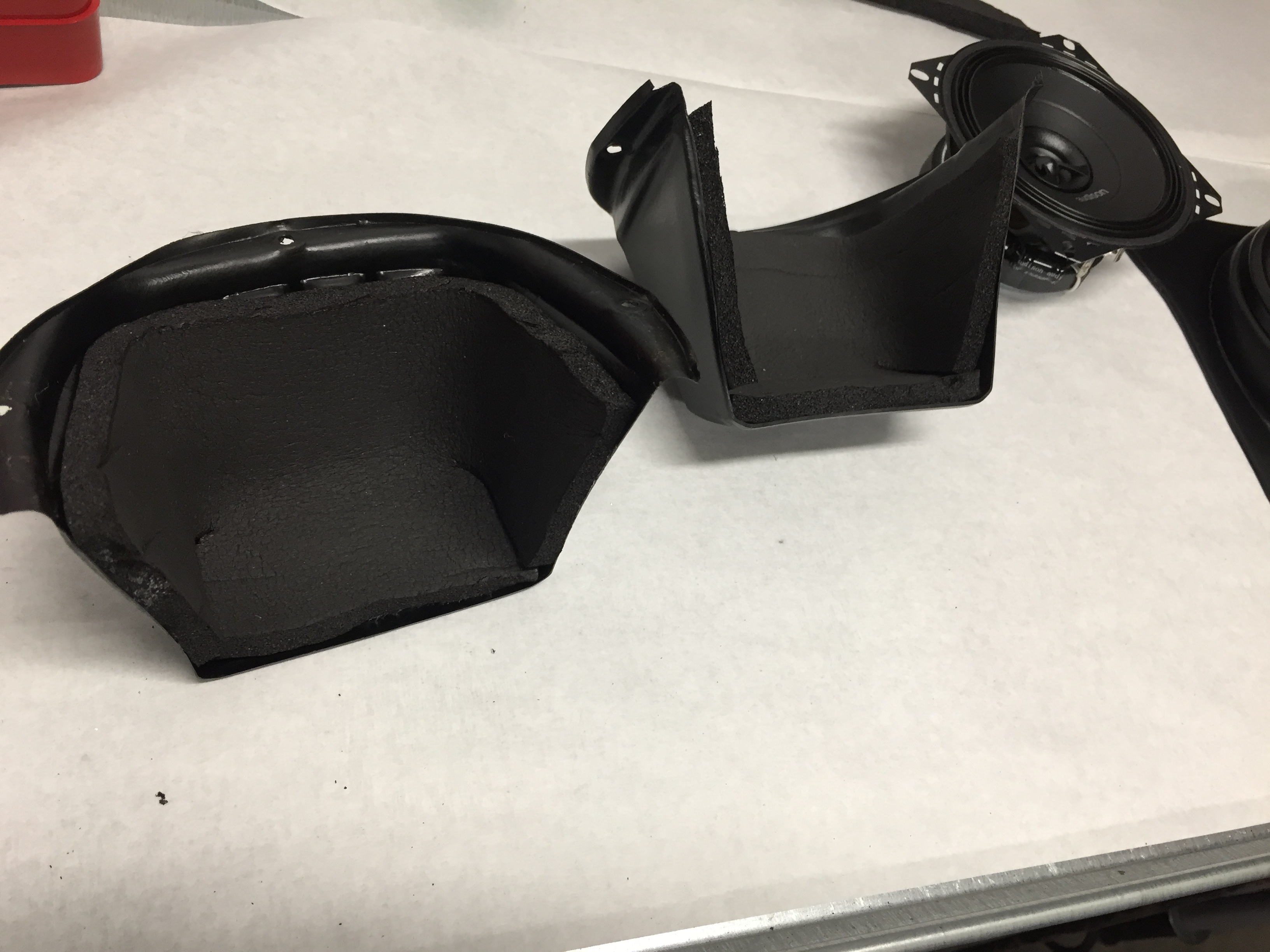

Yes, I understand what you say. Sometimes is difficult to take a decision about repair or make it new. This is a perfect example of this. during the process of repair of the speakers boxes I thought many times that I should probably make a mold and make them from scratch. Having the original it's always a good value though. Went first Emma got the car, I just was going to fix mechanically the car so she could drive it around, but I can't just fix something and go to sleep without having bad dreams about it. I have to fix it well.
The boxes were very cracked, I tried to repair them with a glue but I had a reaction on the top coat (it's a kind of dip rubber coat). So I had to striped... then was even worse, all the cracks were bigger and the speaker cases fall apart in pieces. Well, I cut a few aluminum pieces to make a reinforcement on the back of the plastic boxes and glue them together. Then I spent some time making them much nicer with some filler, then primer, sand the primer with a guide coat and paint. Finally sand the paint and buff till its shinny. The new insulation is better than the original but its same thickness. The speakers are Audison, They are good quality and the inner tweeter doesn't stand out of the cone. Most of the two way woofer have the inner tweet out, so, you can't use the original top screen.
