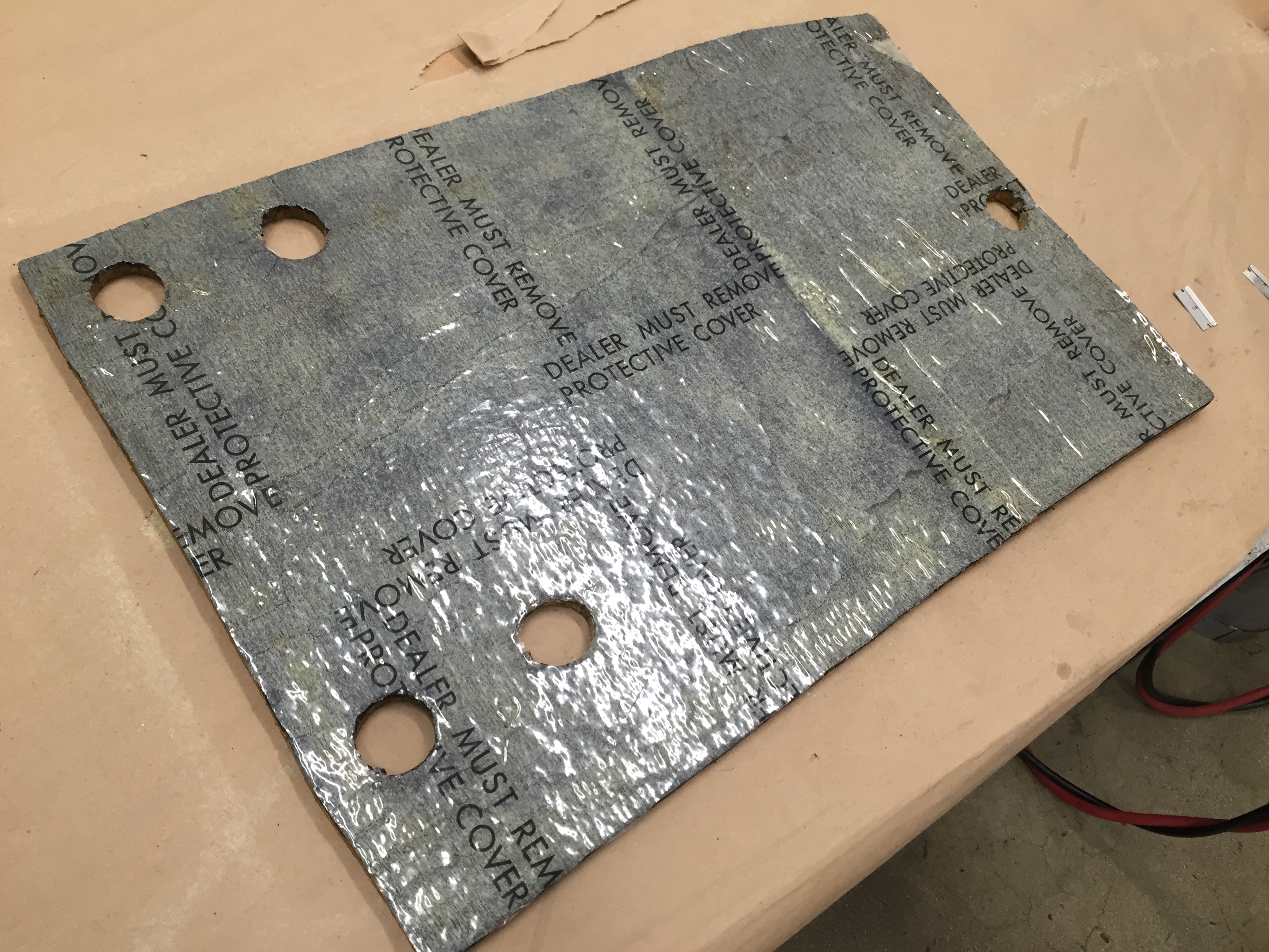

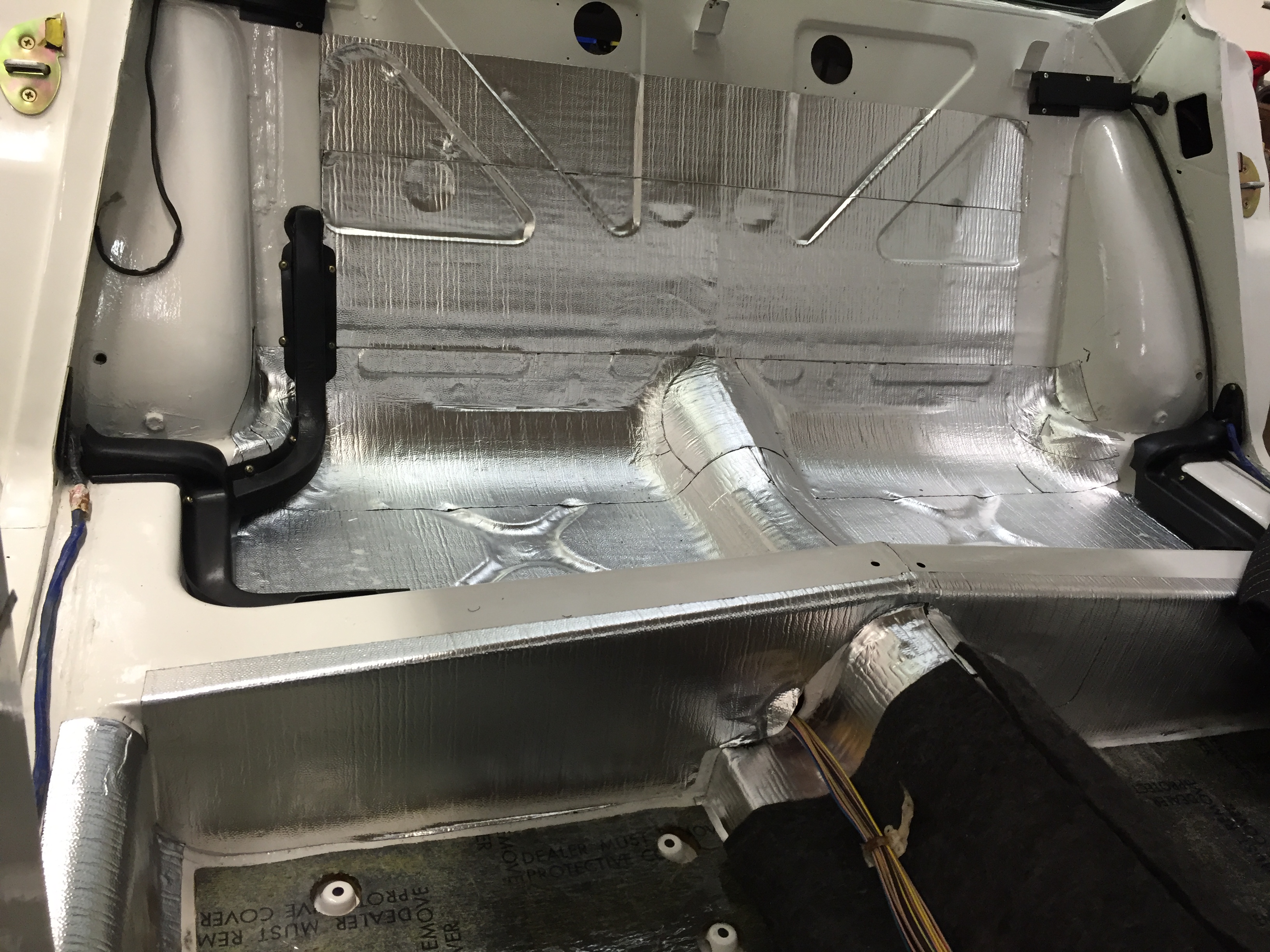

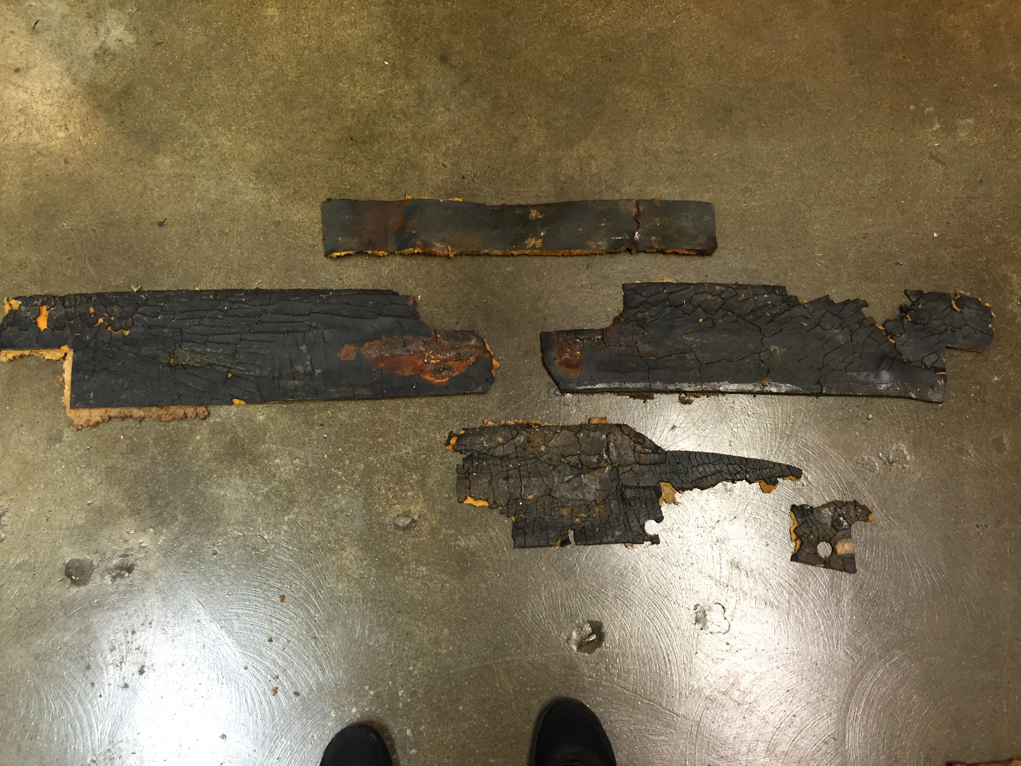

Lightbulb insulation
The old floor insulation It was totally broken. We repair some of the pieces to keep it pristine but also we made new ones. Here you can see a repaired one. I didn't finish with a new acoustic insulation because we are still not decided about the stereo system (please if anyone has a good sound system let me know, ideas are welcome).

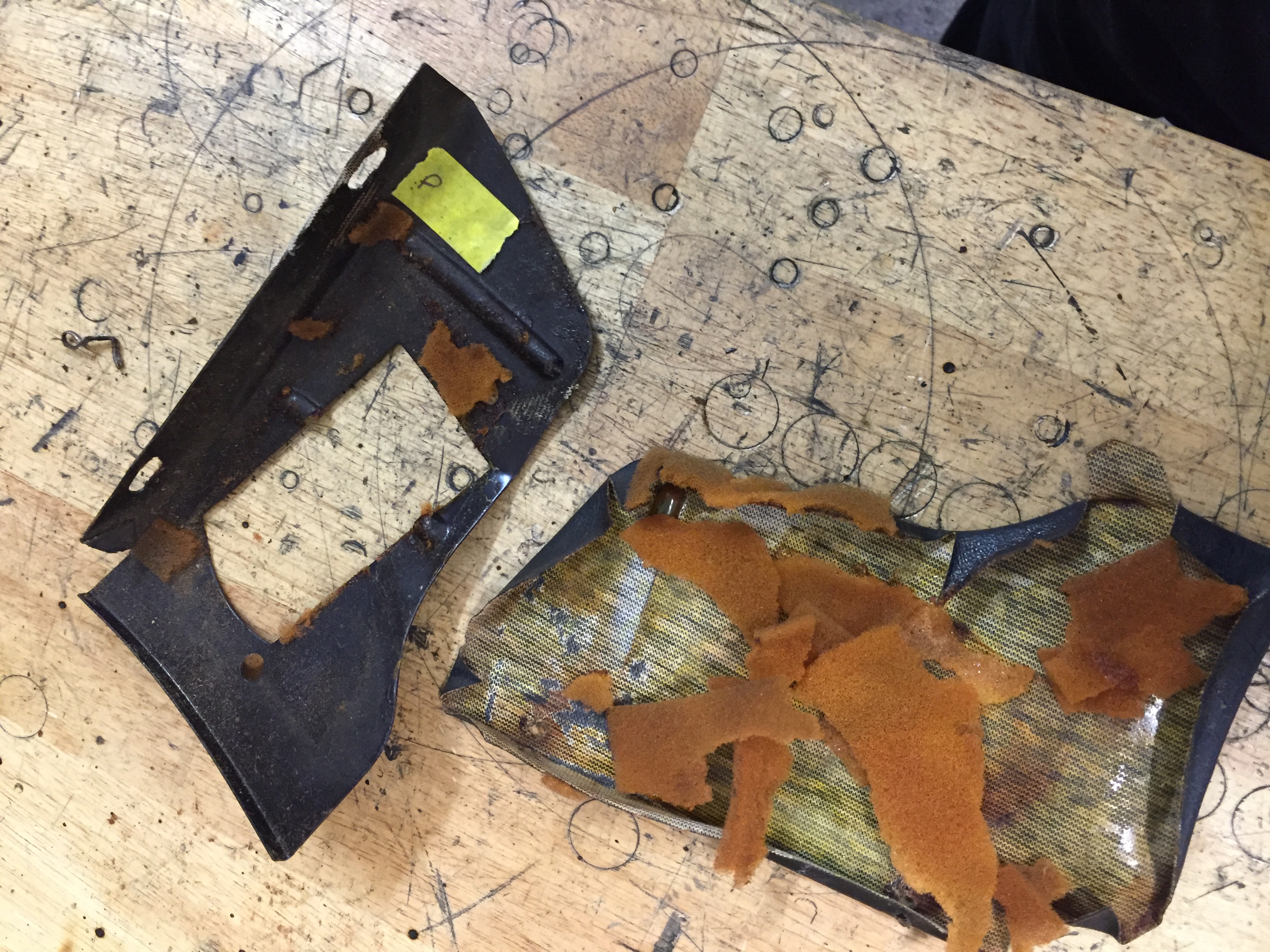

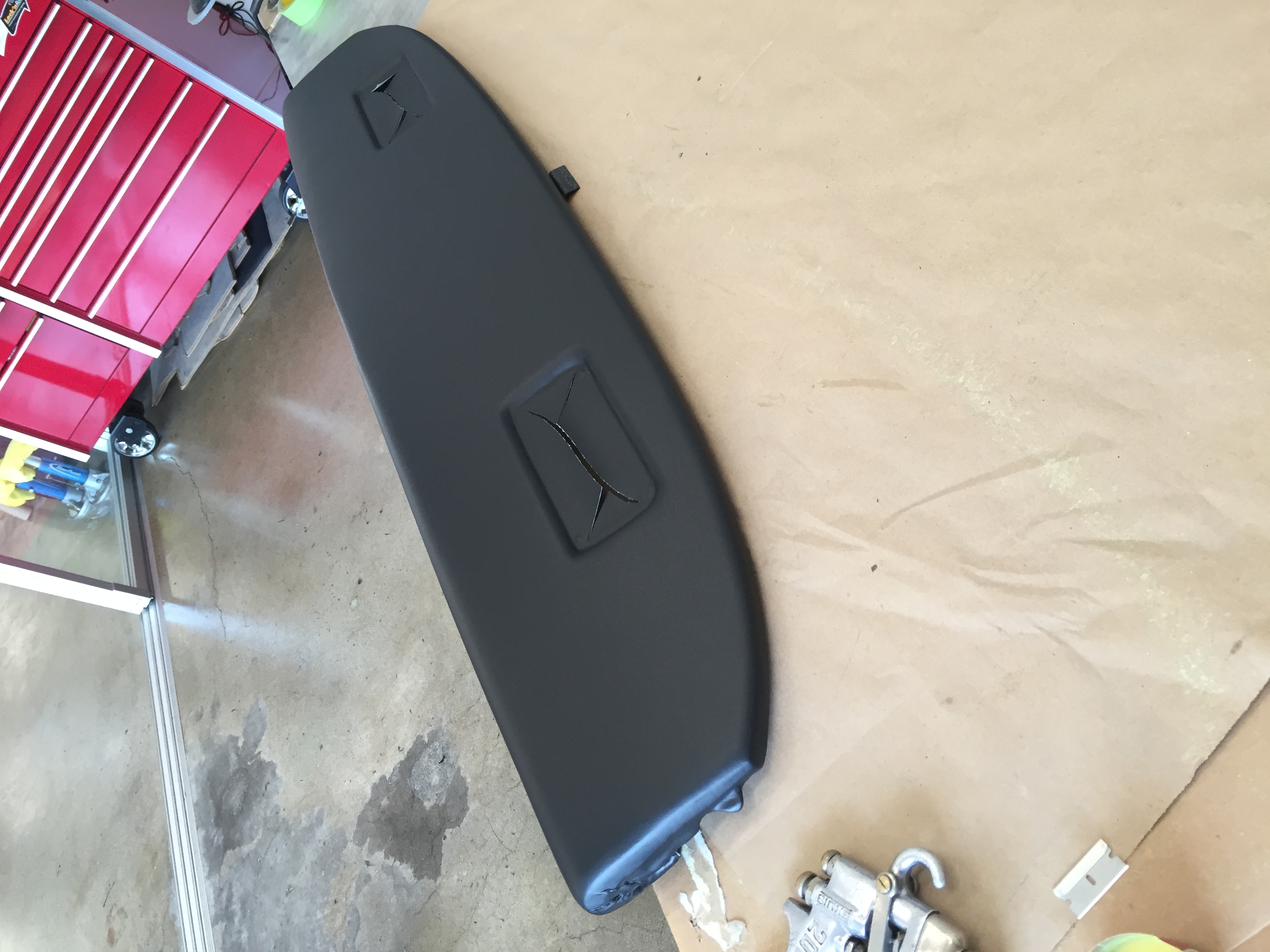

Default Old vinyl
We are only going to use vinyl on the dash, rear tray and the sun visors. the rest leather.
taking the old pieces apart to make the new ones.
Attached Thumbnails 1976 XJ12, New home-img_4583.jpg   1976 XJ12, New home-img_4788.jpg

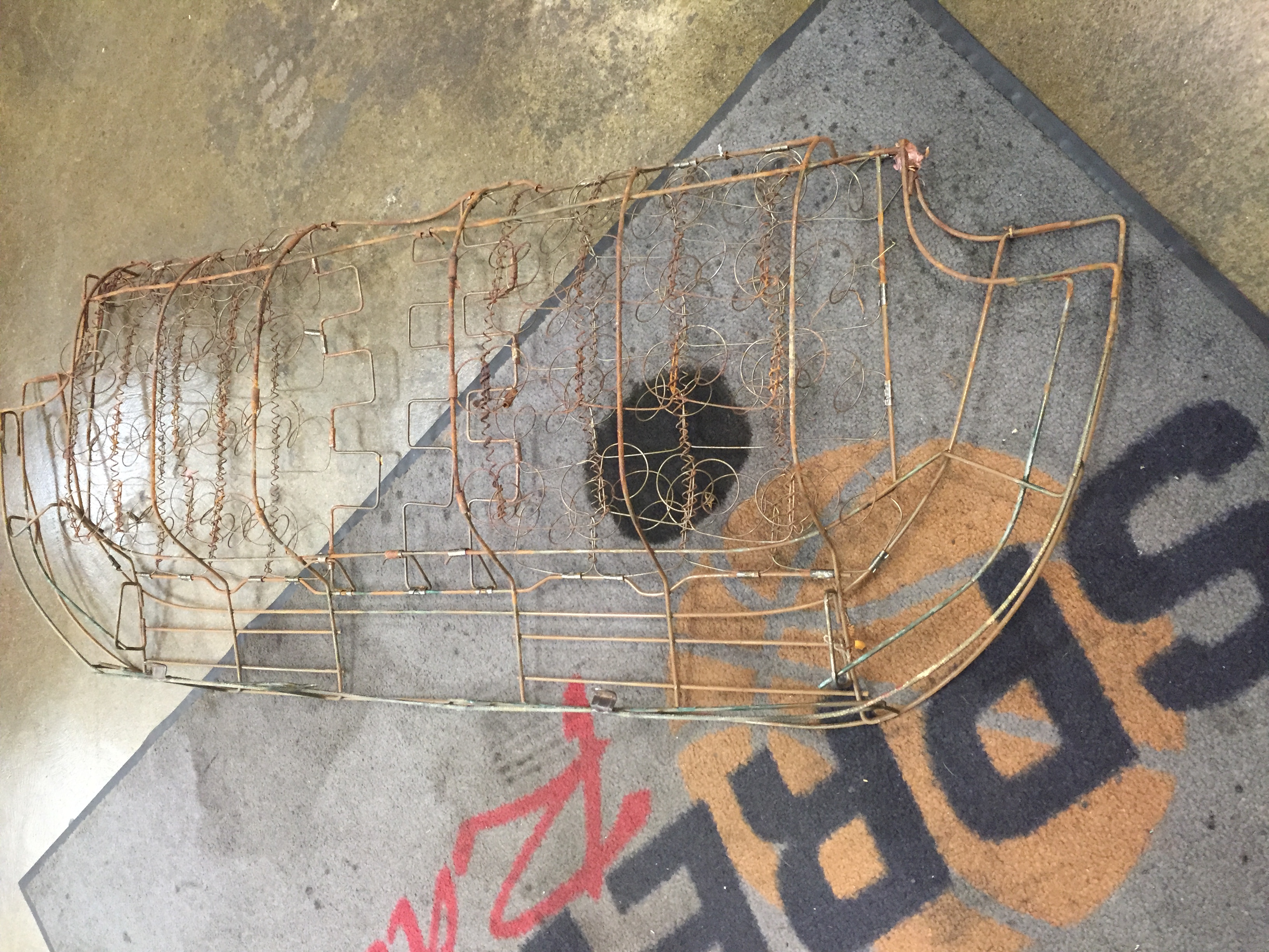

Question Seats

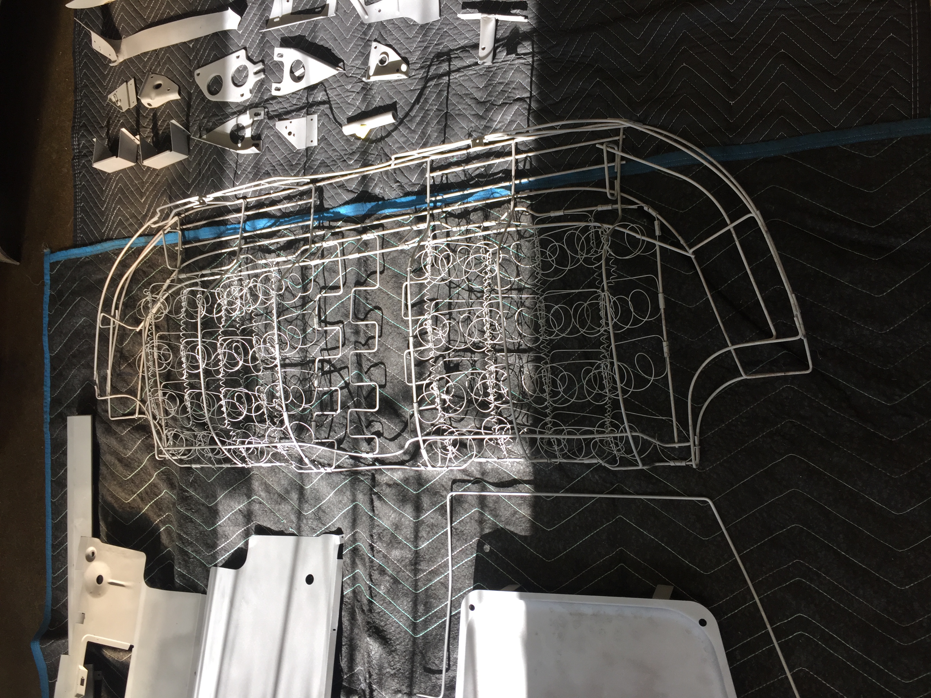

We are taking apart the seats. Mr. Louie Mesa is in charge for the leather. We are taking apart the seats for him. sand blast, paint (or maybe powder coating) before the new leather. The front seats frame were black but the rear lower seat frame is green (why? were mine aftermarket?).
Attached Thumbnails 1976 XJ12, New home-img_5125.jpg   1976 XJ12, New home-img_5127.jpg   1976 XJ12, New home-img_5128.jpg   1976 XJ12, New home-img_5421.jpg

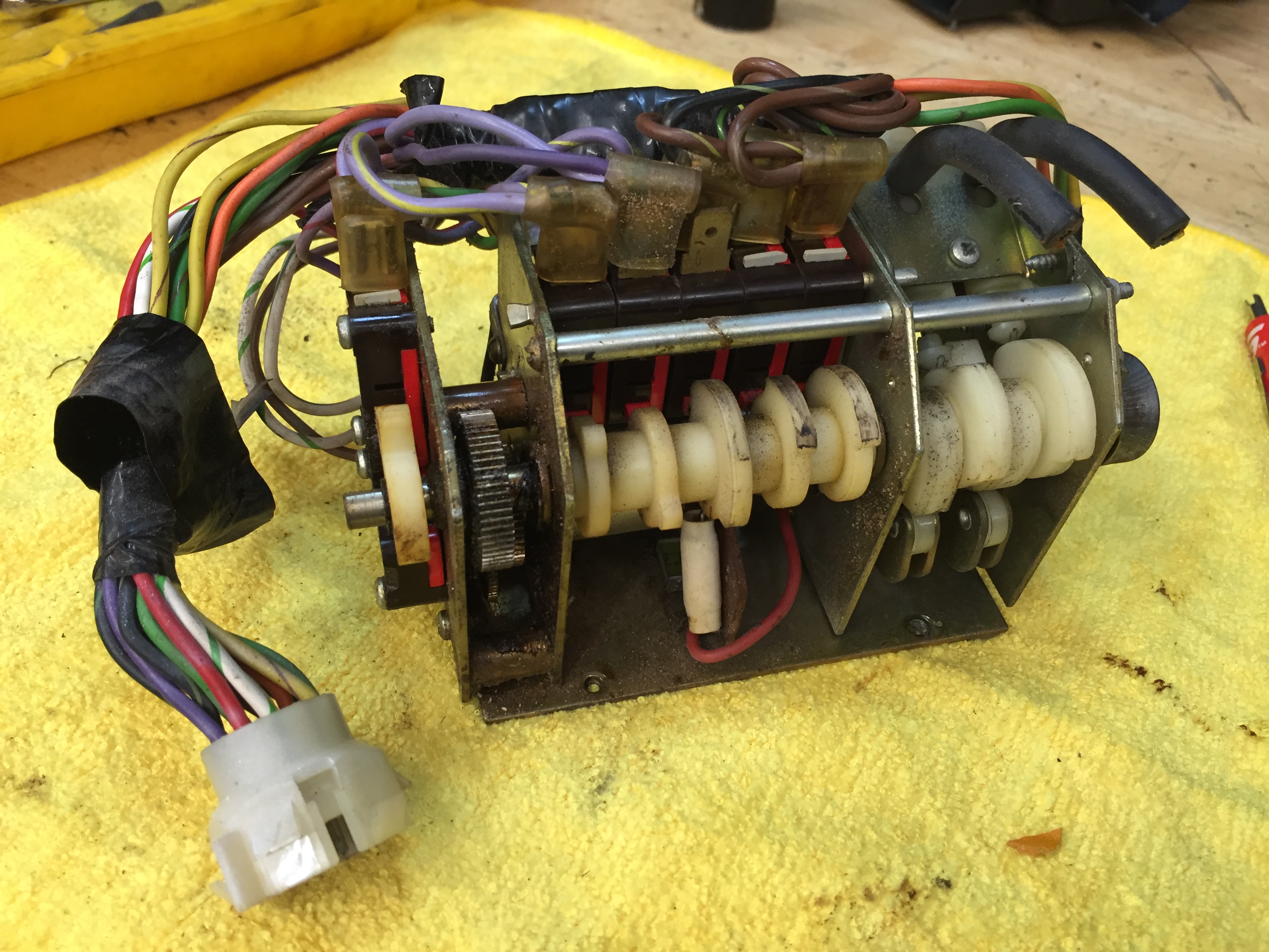

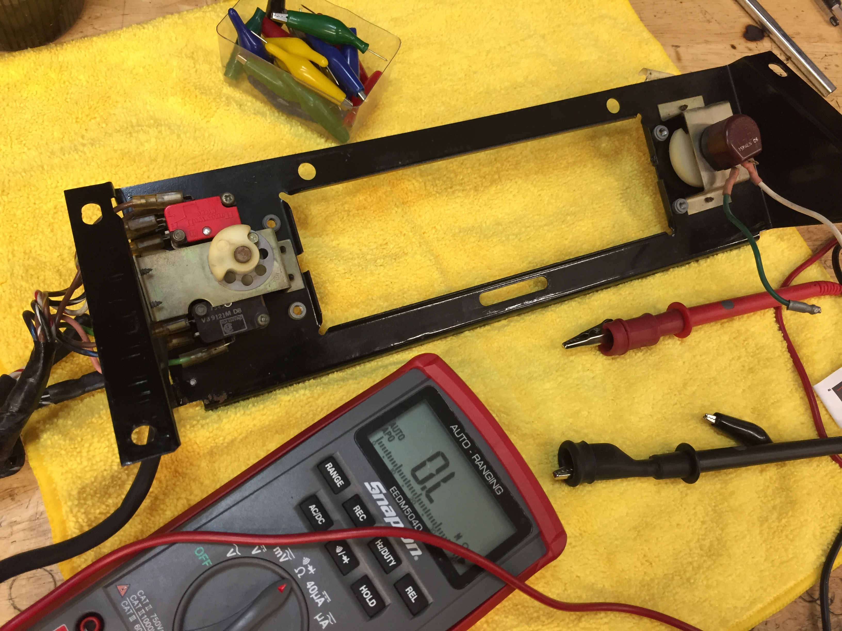

Wink Climate control
I'm taking apart all the climate control modules. I want to make sure everything works before the upholstery goes on the top. Vacuum hose were very bad and some of the micro switches were completely stuck. this is going to take long.
Attached Thumbnails 1976 XJ12, New home-img_5465.jpg   1976 XJ12, New home-img_5477.jpg
The factory hoses were of low quality.
Buy the best tubing for replacement.
The switches can be purchased at a wholesale electrical supplier.
They cost around $3.00@.
Use a light silicone or lithium grease.

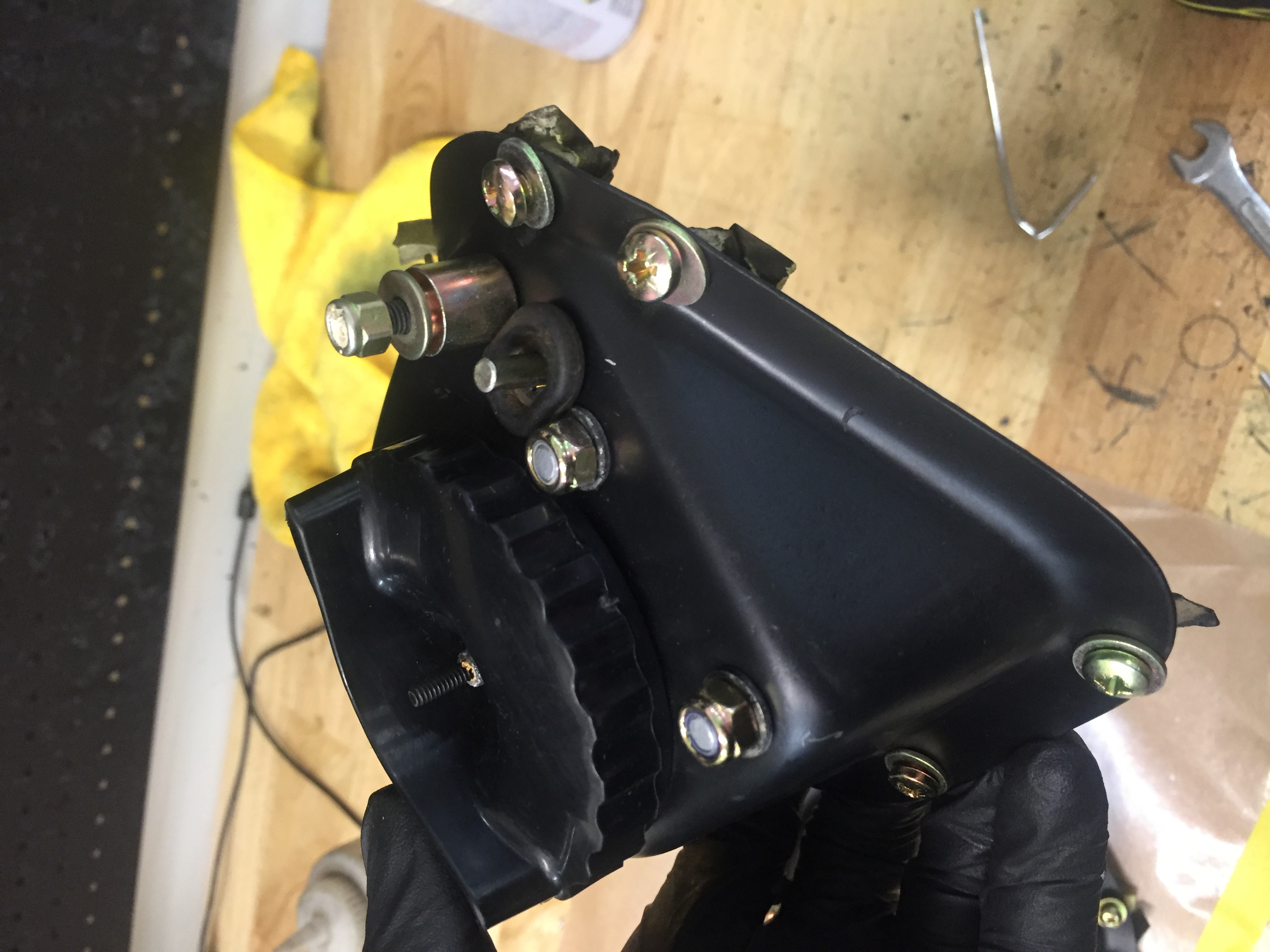

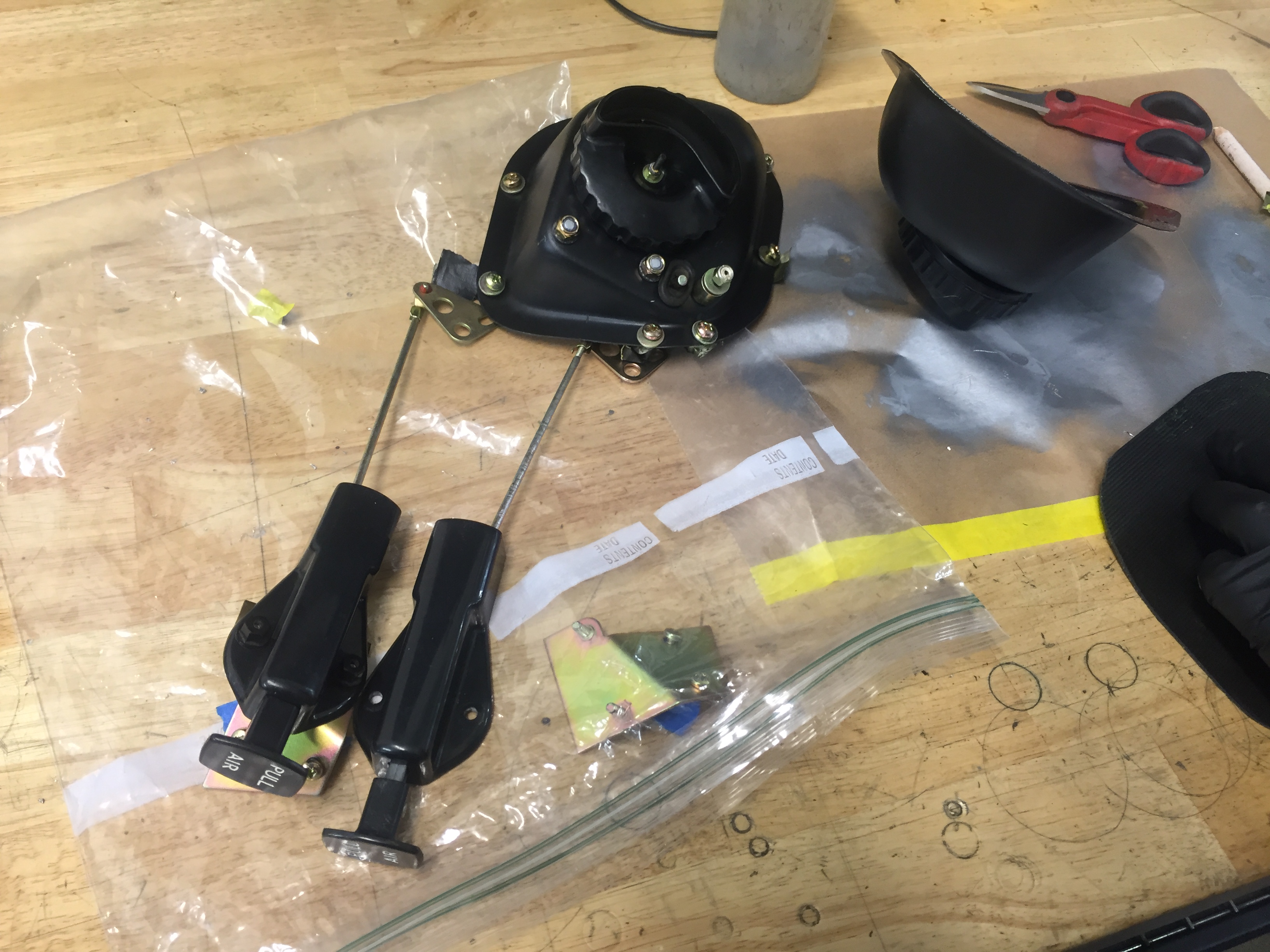

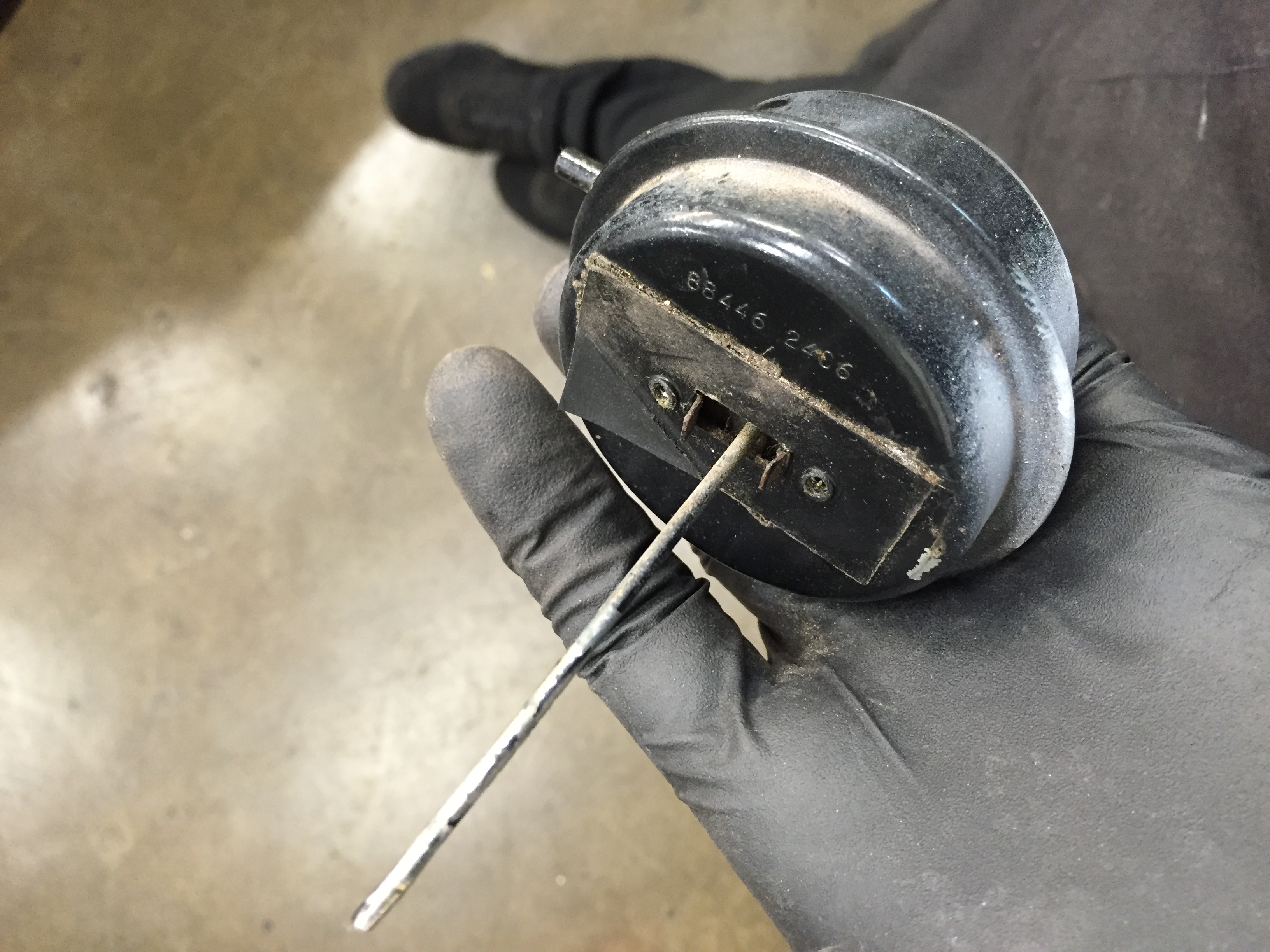

Default blower vacuum actuator
Does anybody know where I could find it? is there any other car with a very similar one?
Here some of the vacuum actuator updates.
https://www.jaguarforums.com/forum/x...3/#post1361759
Hey Debbie, I thought you were done with the project some time ago, looks like you've come back to take it to ever closer to perfection
the new insulation, is that stock or dynamat kinda stuff? Got a source?
Thanks
