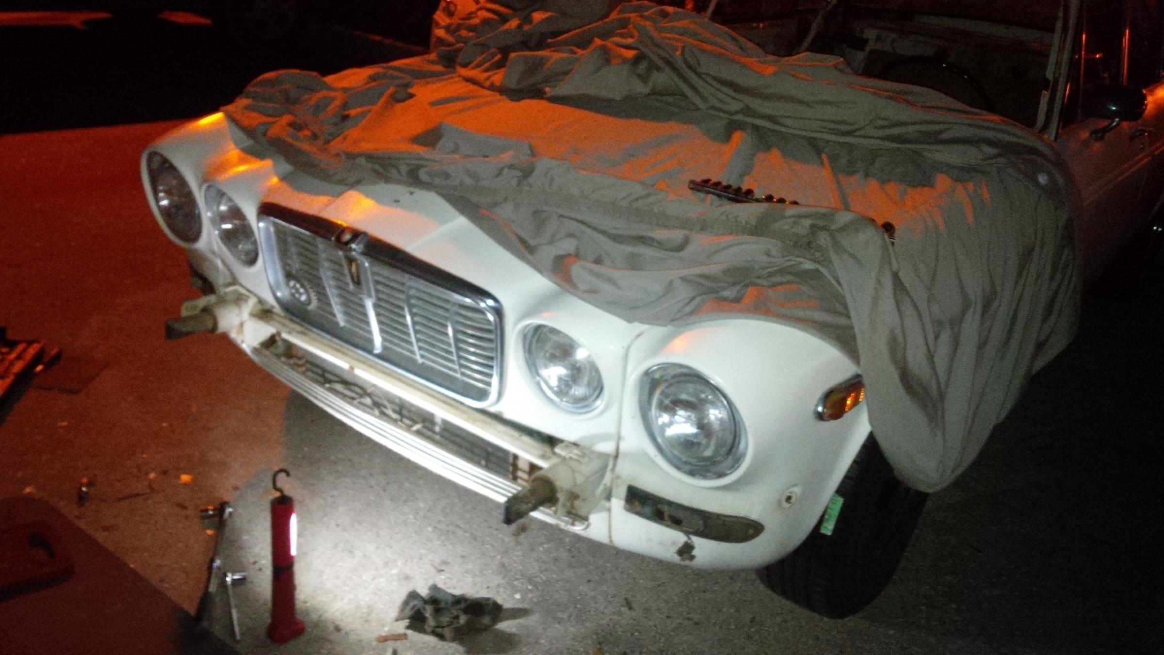

Question Bumper
OK, Bumper is out. I don't even know what I'm going to put on... but for sure this heavy thing is going OUT!
Total bumpers delete? What are you guys thinking?

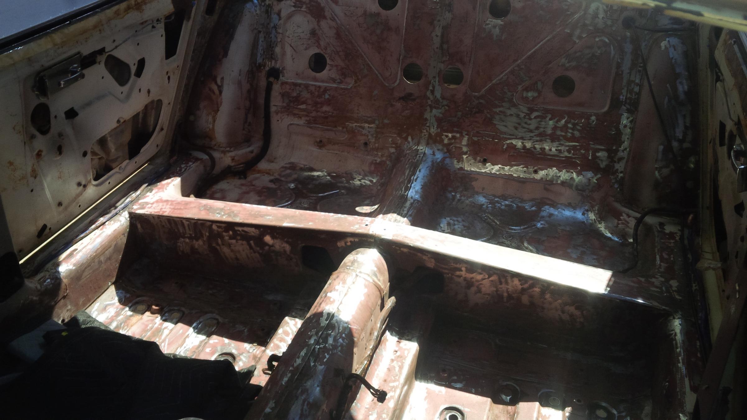

Question Interior
Emma had been helping me since the first day with all the stuff. Here pulling all the sticky insulation off. Believe it or not, it was crazy job. There are some small rust areas under the driver feet and rear seats. We are thinking to use a POR15 paint and a good SEAM SEALER in all the joints. Then substitute the old insulation with Dynamat. Any suggestions?
Old Oct 7, 2014 | 11:37 AM
  #46
geneo's Avatar
Joined: Jun 2011
Posts: 246
Likes: 75
From: phx/flg az usa
Hi, I didn't respond to you last time as I have not researched heat insulation padding. That said there are many similarities with sound insulation materials. While Dynamat is considered very good it is also very expensive.
For other cars I have purchased from www.sounddeadenershowdown.com
good stuff, and a good web site.
geneo
I think the cars look good with the front bumper deleted. If you were looking at going with a UK spec bumper there is an awful lot to change - and all of it will have to come from overseas. This means $$$!
It all sounds right. Geneo is right about Dynamat though - pricey. I bought a super thin aluminized fabric that is high temp proof for a different project. I will look up the company info for you. It's a big industrial operation that sells typically to large manufacturing companies but they were fine with selling me a meter or two.

I coined a phrase to describe the under bonnet insulation in my car. "Moth eaten bear rug".
I just removed it. Tis bare, and has been that way for a couple of years at least. Not ill effects that I have noted.
I was going to polish it, but, the paint isn't the same as topside. it is dull and didn't polish worth a d...
I do have a can of bed liner. My plan was to spray the underside with it.
As to the interior. My car had a mat of some foam type stuff over the trans. it was "cruddy' to say the least. I tossed it and went bare. No ill effects that I can notice.

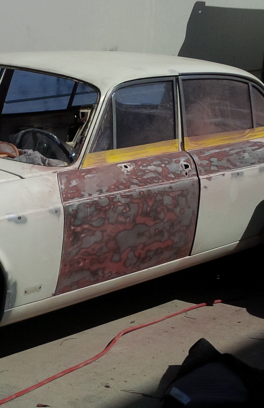

Smile Rust Cancer OUT!
Hi Guys!!!
Thanks for all your answers! I can't stay in the front of my car looking at the bumper but I can't take my final decision yet.... yahh! making a complete bumpers delete could be easy on the front but there is a ton of work in the back tail...
Today I had a complete crew working on the car. I really need some help to go fast otherwise I take forever because I'm too picky... (omg yeah!)
Jacob, helped me to cut some small rust areas in the front fenders and Dave help me to fix some dents on the roof. Emma also pull all the chrome lines... They were fake. Somebody installed an aftermarket fender/door protector around the whole car. Now it looks so much better and clean.
Oh... Delete side markers lights?
Attached Thumbnails 1976 XJ12, New home-img_20141008_154038a.jpg   1976 XJ12, New home-img_20141008_154114.jpg   1976 XJ12, New home-img_20141008_154105.jpg

i am in the process of deleting my side markers and just looking at the fiberglass patch thats not even sanded yet looks soooooo much better than the light!!

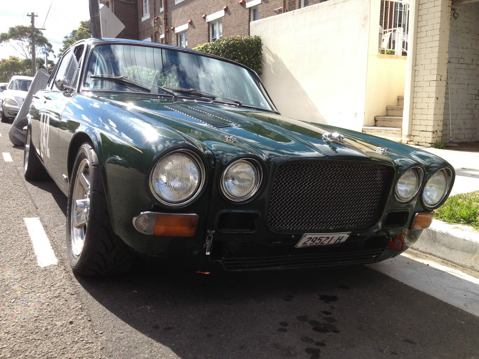

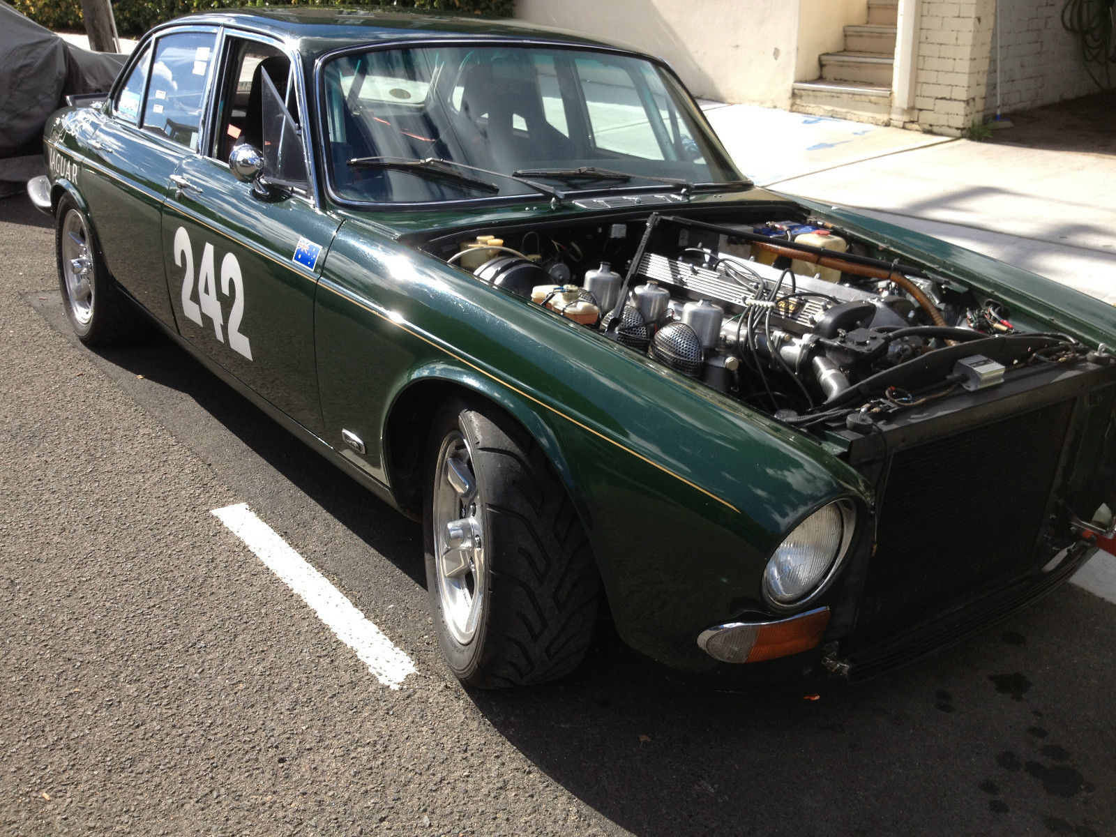

Default Series 1 Daimler and Jag with no front bumper.
1976 XJ12, New home-%24_20-2-.jpg1976 XJ12, New home-%24_20-3-.jpg1976 XJ12, New home-%24_20-4-.jpg1976 XJ12, New home-%24_20.jpg1976 XJ12, New home-%24_57-5-.jpg1976 XJ12, New home-%24_57-2-.jpg1976 XJ12, New home-%24_57.jpg

Cool DualAction time!
For the last week, we only have been sanding, scraping, grinding... The interior is almost ready for the POR15. (I've used long time ago this product and I loved it). About the exterior... how much deep do you would like to go? omg. Now I'm thinking to pull the chromes and windows out since I don't like the masking tape on the windows frame...
The park lamp holes are already weld and all the rust cancer areas were cure as well. (I can weld but I don't have practice making good welds, so Jacob helped me for the last two days.)
About the bumpers: mmm... I have my brain ready to blow! Honestly, I can't put the whole American monster/bumper back... NO way! I thought to cut them and make them cute, I thought to totally remove them but no... too racing and no easy for the rear one neither, I thought to buy the Euro Series II bumpers and adapt them but I don't really like the lower square grill and the side vertical chromes, I thought the conversion to Series I style... but then it is not going to be a Series II... no more, so... What? Plus I wouldn't spend the rest of my budged on the bumpers. We will see... I'm going to squeeze my brain during the weekend and came with some idea before we apply the primer. I could.... make my own hinges to open the front hood. Use part of the original bumpers and modify the rest. Now, I have to think about the lower grill/valance shape. the rear, maybe,... use the side pieces and fabricate the central piece....
Debbie
Attached Thumbnails 1976 XJ12, New home-img_20141010_130748.jpg   1976 XJ12, New home-img_20141010_104705.jpg
