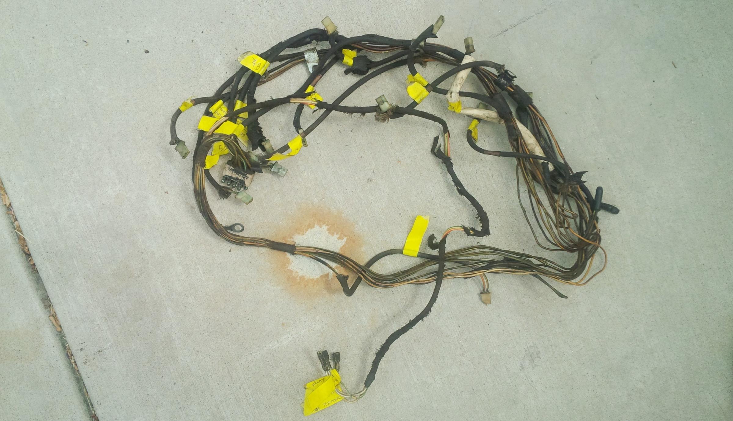

These days I had been cleaning, cleaning and more cleaning... This is one of these kind of jobs that nobody can't see.
The wire harness though is better than I thought. I label all the connectors since you can't even read the originals. It looks all broken but if you pay attention on the picture #2 it is only a peeled brown/clear coat over the plastic insulation. I've cleaned them with lacquer thinner and it works pretty well. Some of the areas though are very bad, especially where the wire is cover with a kind of fiberglass insulation. Some of them are completely melt.
My first idea was to order the top line of fiberglass insulation, the new boots for the pigtails, new pigtails connectors... bla, bla. I went up to 280$ budget... So, I'm going to just fix the bad wire areas, use shrink tubing, clean the whole thing and change the electrical terminals. I found the WURTH ones with the lock for less than 0.30$
Then, I'm thinking to hang the harness up to the intake bolts. At least it is not touching directly to the engine block.

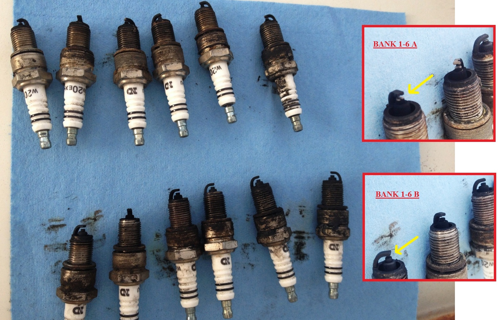

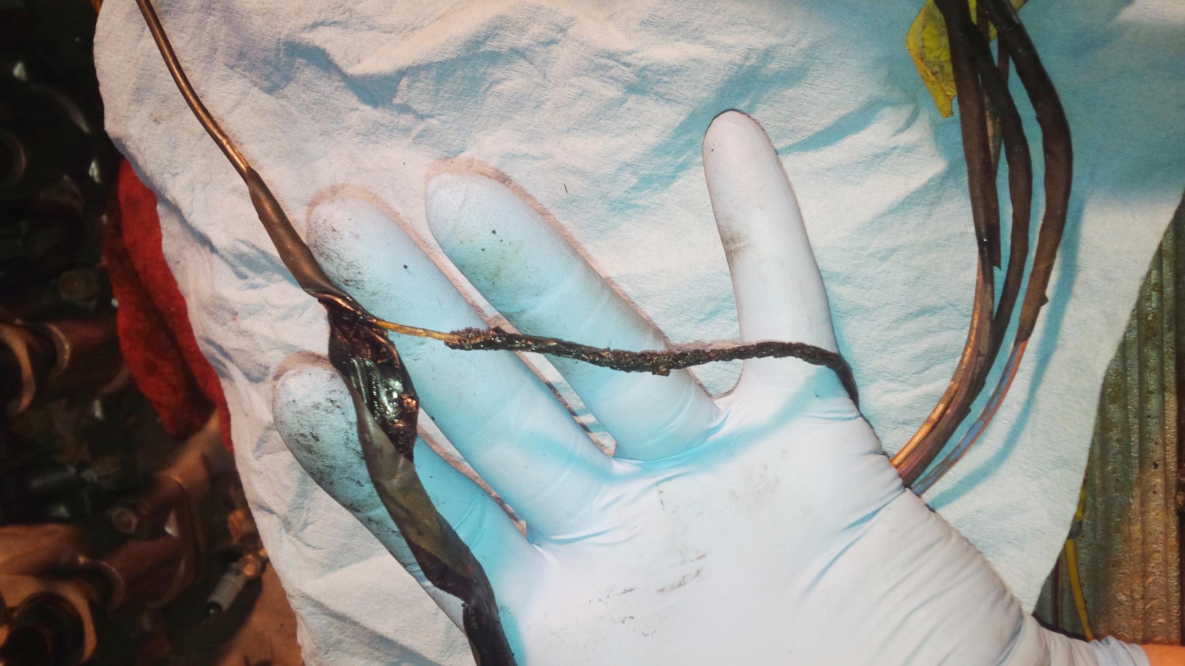

Finally is just clean enough to pull the spark plug and the injectors out. Another detail (My Bank -B was not working): I saved in order the old spark plugs. The ones from Bank -A have a clean electrode (a very small area in the surface) vs the ones from the Bank -B are completely 'black'.
There are lots of areas with a melted wires. I have to fix them one by one. Then I'm going to insulate the harness with a Termo Techflex and hang it rather to sit over the engine block.

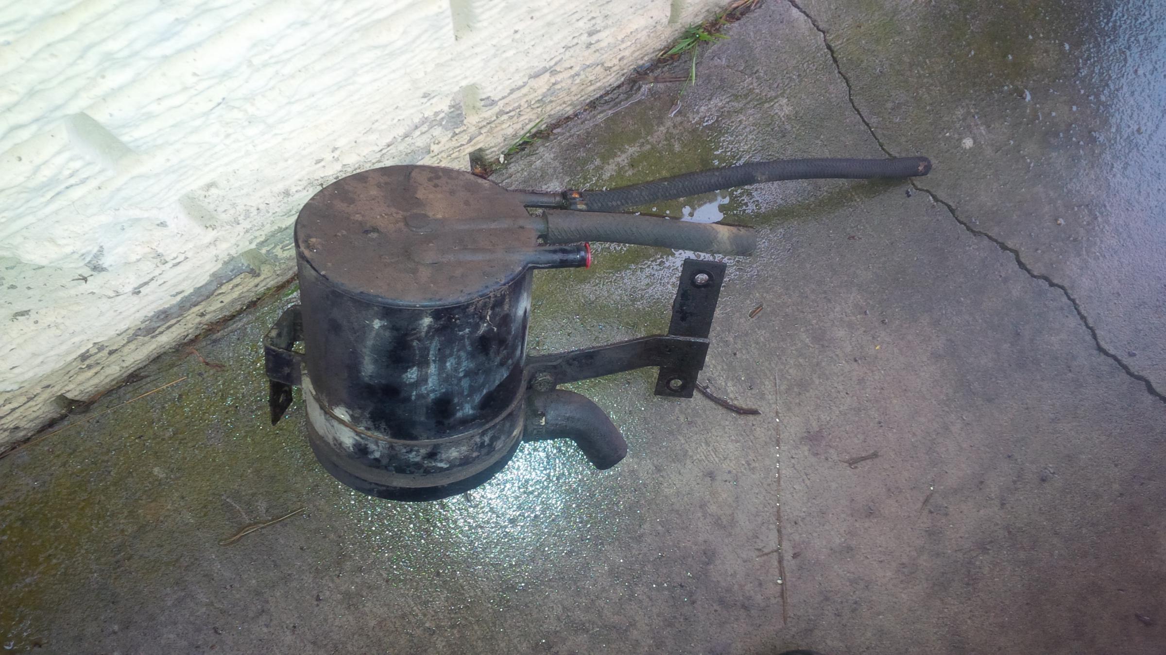

Since I'm having to smog this car I'm taking all the emission parts carefully. I'm looking for a new EGR valves (I can't find them! Do you know any aftermarket/exchange part number? )
I found another area with burn wires. I'm fixing them one by one.

I was not posting for two or three weeks. I have been busy with the XJ12. OMG! I need to find a stopping point otherwise I'm going to rebuild the whole thing.
The harness is almost done. I've just received the injector rubber boots much better.

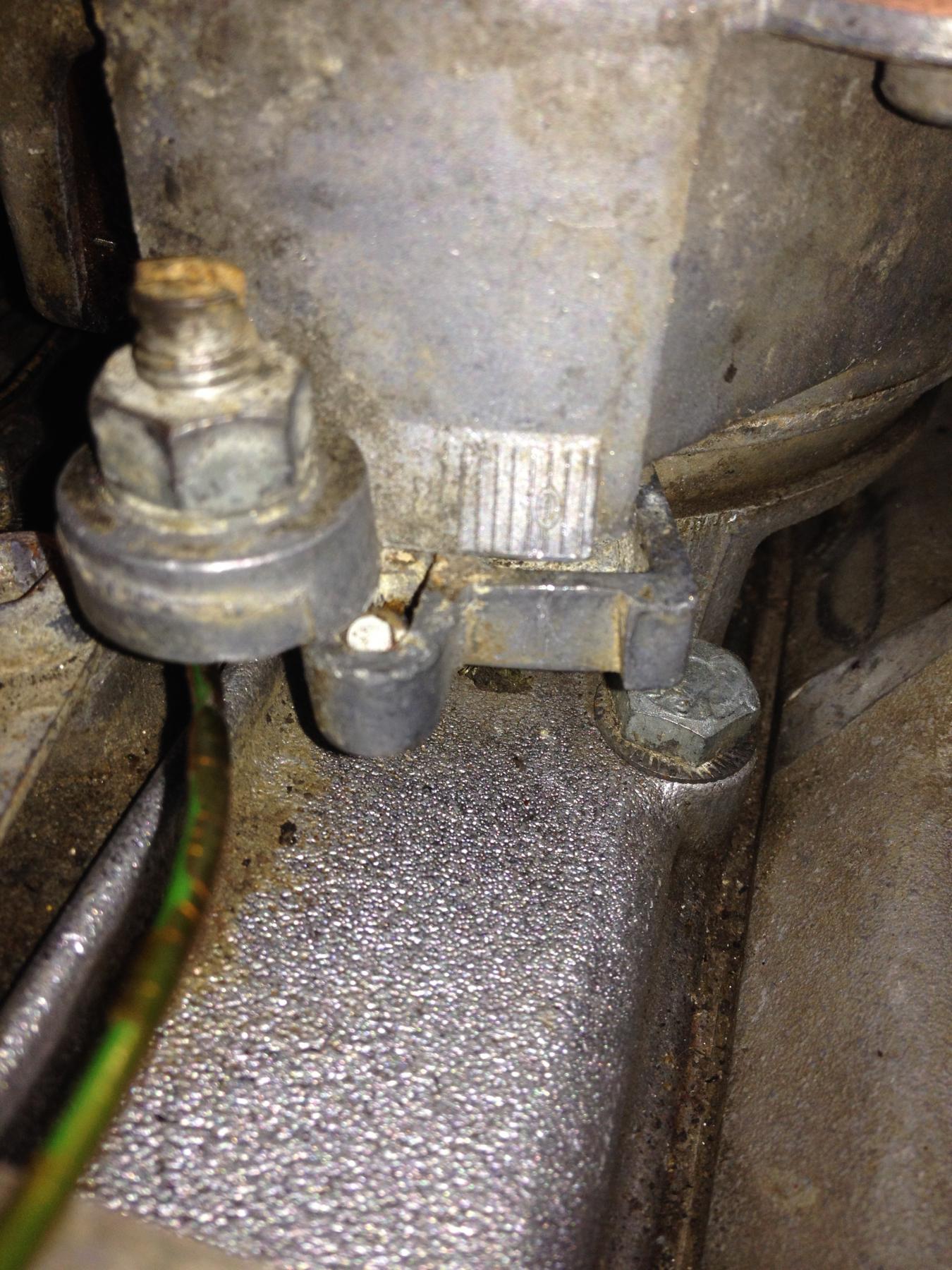

Another issue I've just noticed is the distributor. OMG! You must see it. I attached a picture. The distributor has a outside bold to adjust the timing (just some degrees) and this bolt also has an eccentric pin on its bottom. This pin should run in a track an allows to move the distributor. Ok, So just take a look on the picture. They broke the pin and tight the distributor way to far from the correct marks. I mean I started the car before but this means that they have been messing with the timing and installed the distributor shaft with a tooth off. Am I right? Also I checked the vacuum diaphragm and it is not working,... it doesn't even hole the pressure down.
I ordered a ton of parts since I can't put together the 'V' stuff with changing all of the parts of the area. check valve, A/c expansion valve, oil sender,... I hope to find an stopping point!

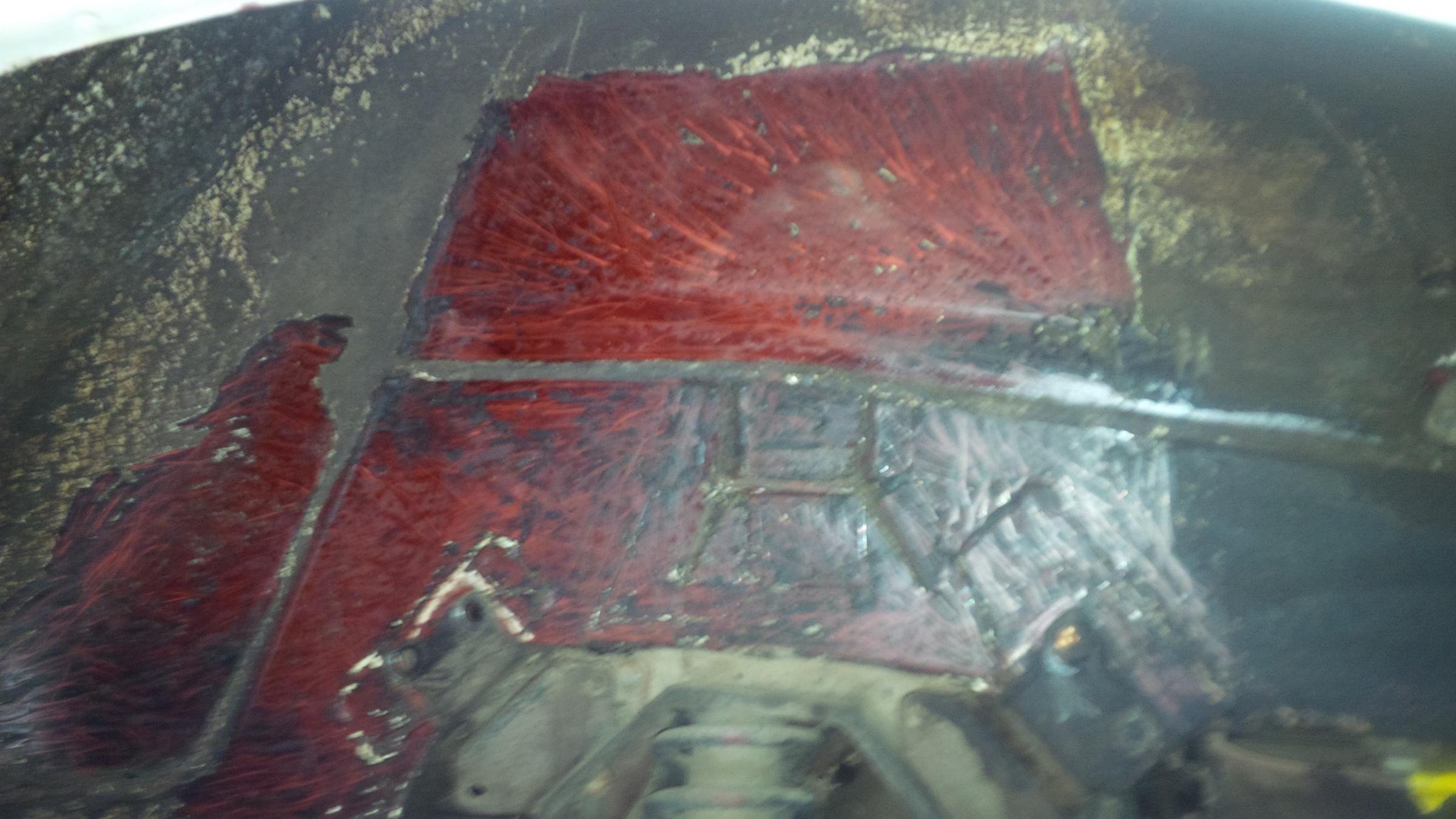

Under the carriage. Yes, I'm still cleaning all the inner fenders area. It is so slow job. I have to order some seam sealer and undercoat but again,... I'm going to change the ball joints, shocks, and some bushings... I mean I can't just clean the crap and leave the same bushings... I can't!
Can you believe I found in Autozone. New front shocks for 27 bucks!? They are not bilstein,.. but I'm sure that they will be better that my old ones. I can't even paint them for this such price.
I found some 'cancer' areas with to much rust. I've just decided to use my Dremel and cut them and use a new steel piece to fix them.

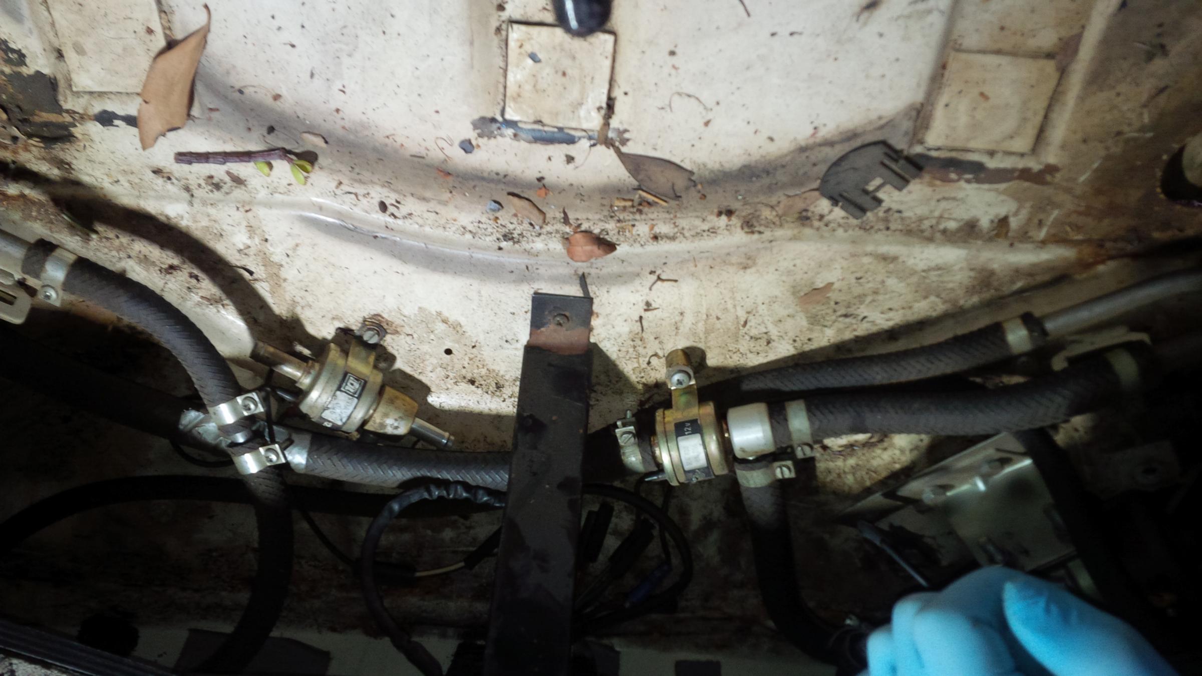

TA TAN! Another surprise!
I can't switch the fuel tanks... they were already connected.
I found another fuel pump inside the car so, maybe it is a bad one or maybe is a replacement one... I don't know yet.
I should vacuum the whole thing before the pic, lol. but the car came full of dust.
Debbie
Debbie

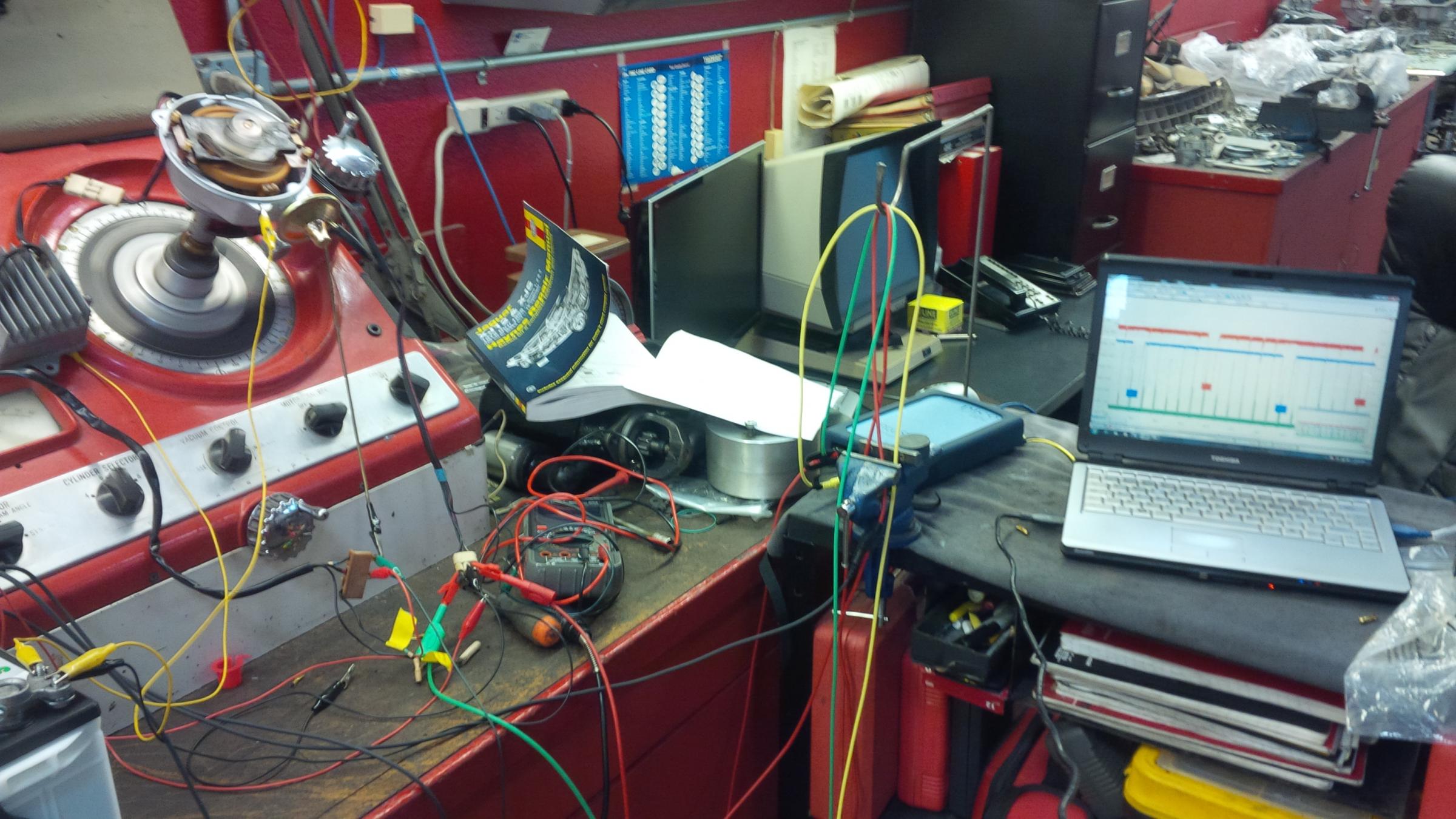

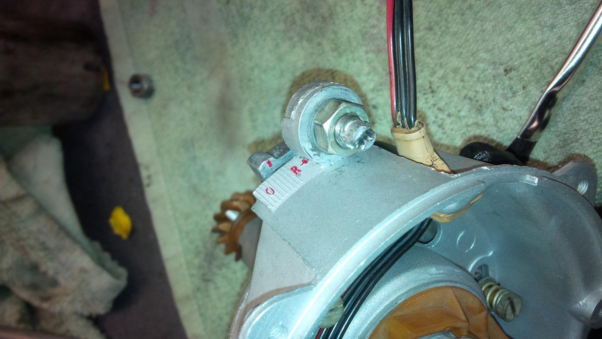

I spent the labor day playing with the distributor. Now we know that it is working for sure!
'Red' waves are injection pulse Bank 'B'
'Blue' waves are injection pulse Bank 'A'
'Green' waves/spikes are the ignition pulse events for each cylinder.
I also fix the eccentric pin to adjust the timing. (it was broken)

Woweee!
I am impressed. An engine analyzer/oscilloscope and an off the car spinner ala the Sun Machines of olden days.
As to jack stands. Definitely, but leave the trolley in place as well. Belt and suspender thing. if you work alone, a cordless phone within reach and range or better yet, a cell. Don't use the split tube things unless they have been modified to avoid splitting. I use a couple I have for very light duty, no Jaguar on them.
Yeah, some counsel the tank connection thing to dispose of a faulty change over valve. I have such a "T' fitting in my left overs! But, so far my valve works like a charm. There is a potential problem with the paired system. if one parks on a steep side hill and there is a lot of fuel in the tanks, the uphill tank fuel will run to the lower one. when the lower one reaches capacity, it will over flow. Gas on the street under the car and an errant spark....

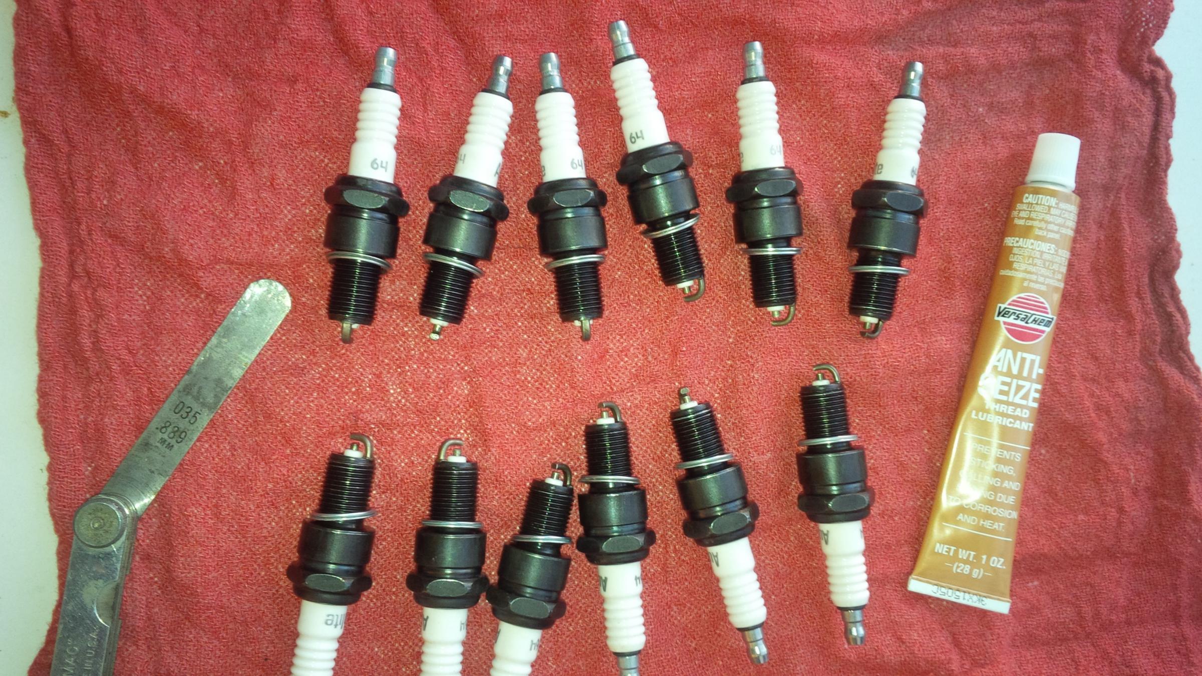

New spark plugs, of course, not worth messing with the old ones, especialy in this car with tough access. I am not sure what the sooted ones mean? Black connotes rich running, not no running???
Carl

Thanks! mmm... Yes, I'm thinking to put the two pumps together as the factory and fix the console switch.Originally Posted by JagCad

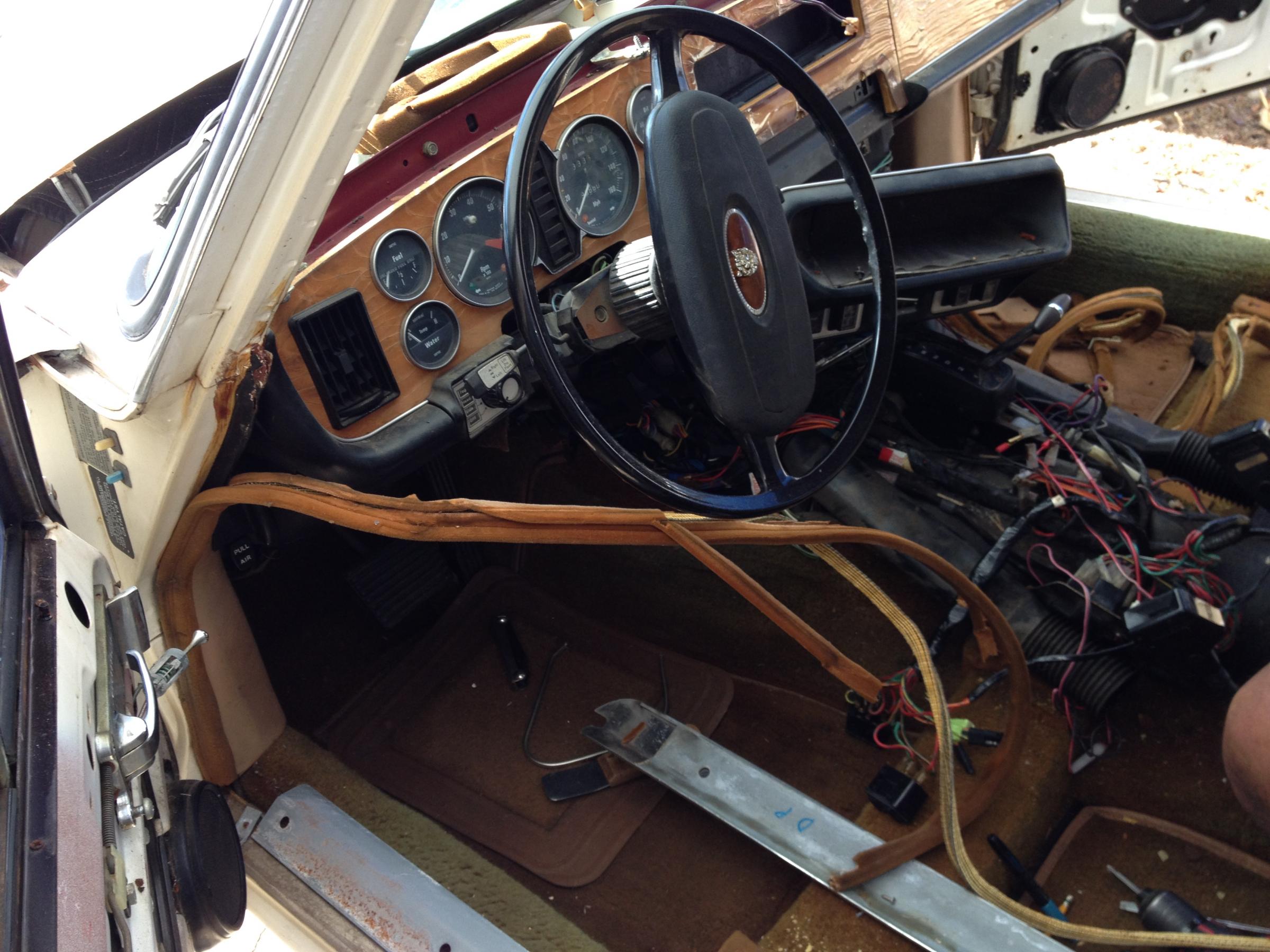

Upholstery day.
Today Louie Mesa help me to remove the complete interior. He has one of the best reputation for his work on leather. Plus, super nice guy! We are going to order the material while the car is going to be towed to the paint shop.
Question: I can see by the heat marks a hood liner or some kind insulation but it is missing. Does anybody has the correct picture for what in need?
