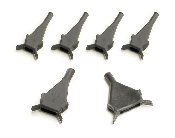

Originally Posted by Dleit53
...I could not locate boots at any price I was willing to pay. I do not expect there to be enough water on top of the engine for it to make a difference. I hope. What boots did you use, and where did you buy them?
Hi Doug. there are several Porsche parts webs that you could find them.
Porsche 914 Fuel Injector Boot Results
I used a modern one. It is suitable everywhere.

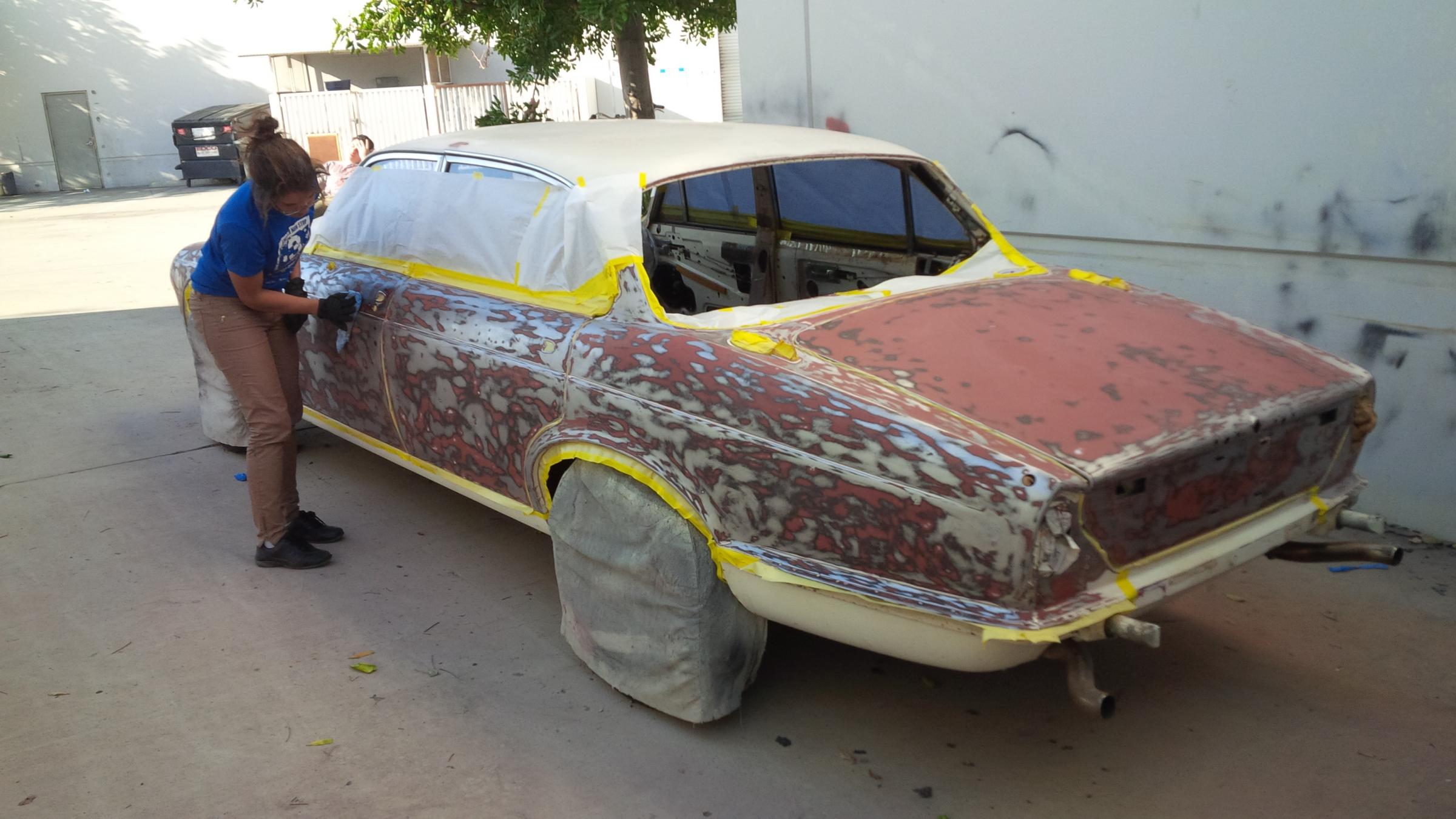

Smile Sanding
Emma has been sanding all day long... she is awesome!!
I'm going to spray a quick coat of primer to the naked panels otherwise they could rust....
Old Oct 13, 2014 | 06:58 AM
  #63
anjum's Avatar
Posts: 936
Likes: 193
From: London
Use 2 pack epoxy. Moisture proof so the rust won't occur for a longer time.

Posts: 355
Likes: 143
From: Shiawassee County, Michigan, USA
In case you don't already know, the common sandable primers really do not seal the surface very well, they may actually absorb moisture. To seal it, use a self etching primer, and do not expect it to seal it for long. Words of wisdom from the guy who painted my old Sunbeam Tiger.

Likes: 193
From: London
Don't need a etching primer if you use 2 pack epoxy. Goes straight onto clean bare
metal. Apply filler afterwards where needed.
No isocyanates either. I use Lechler 29107 (which comes tinted to the colur of your choice, I would advise tinting it as the natural colour is a sort of semi-opaque waxy which makes it difficult to see coverage).

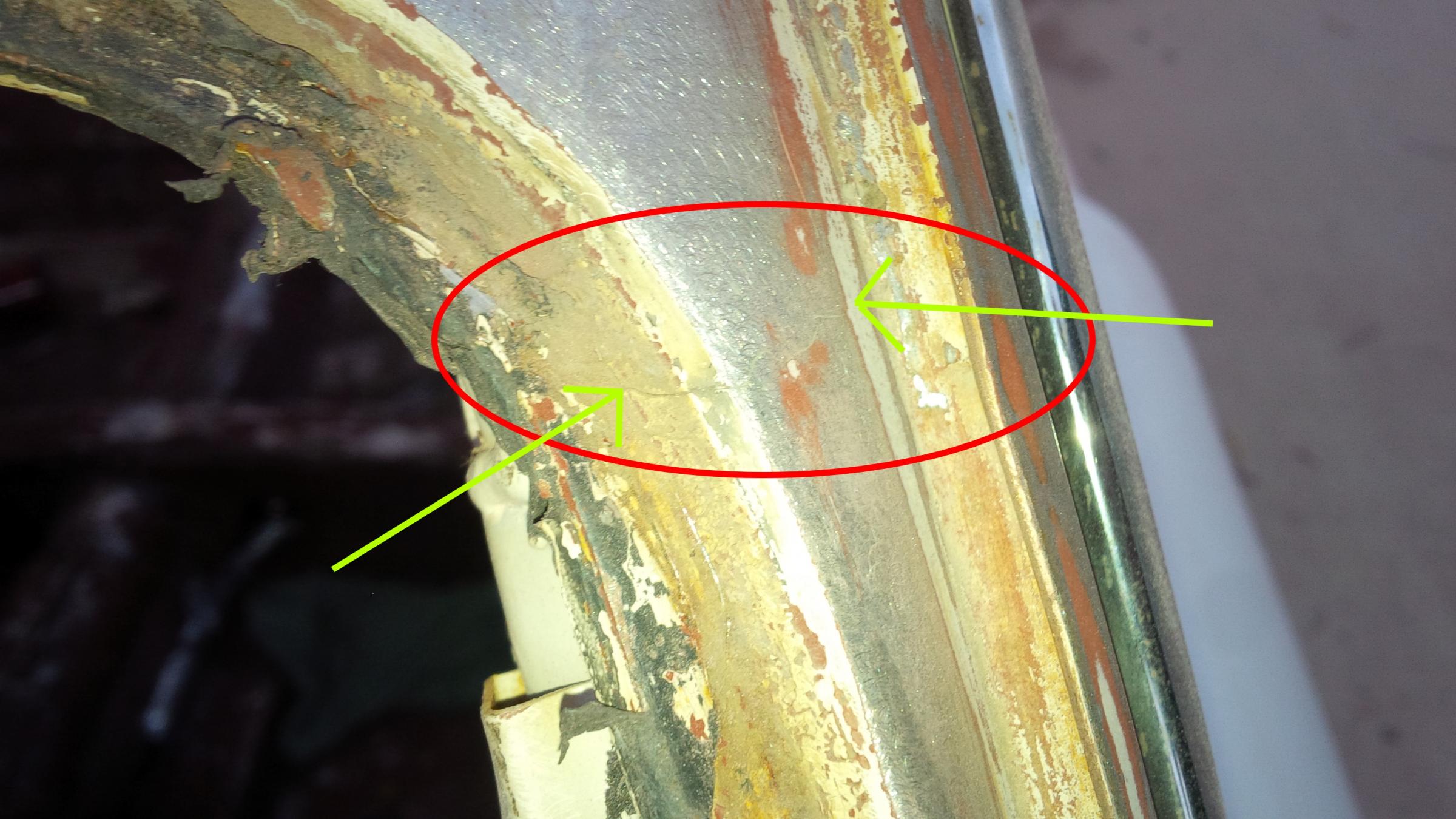

Unhappy Welding time!
Question: I found two cracks on top of the front windshield mounts. Is it something common in these saloon bodies? Sorry, very difficult to see on the picture.
Oh, Thanks for all the paint tips!! Almost ready to primer the exterior but I'm working on some bad dents (roof, and rear/right fender)
Debbie
I'm not sure - tough to see in the pic but it may just be the joint between the roof panel and the 'A' pillar. It looks to be in about the right spot. I have yet to strip my car so I'm not exactly sure what the XJs look like under there...

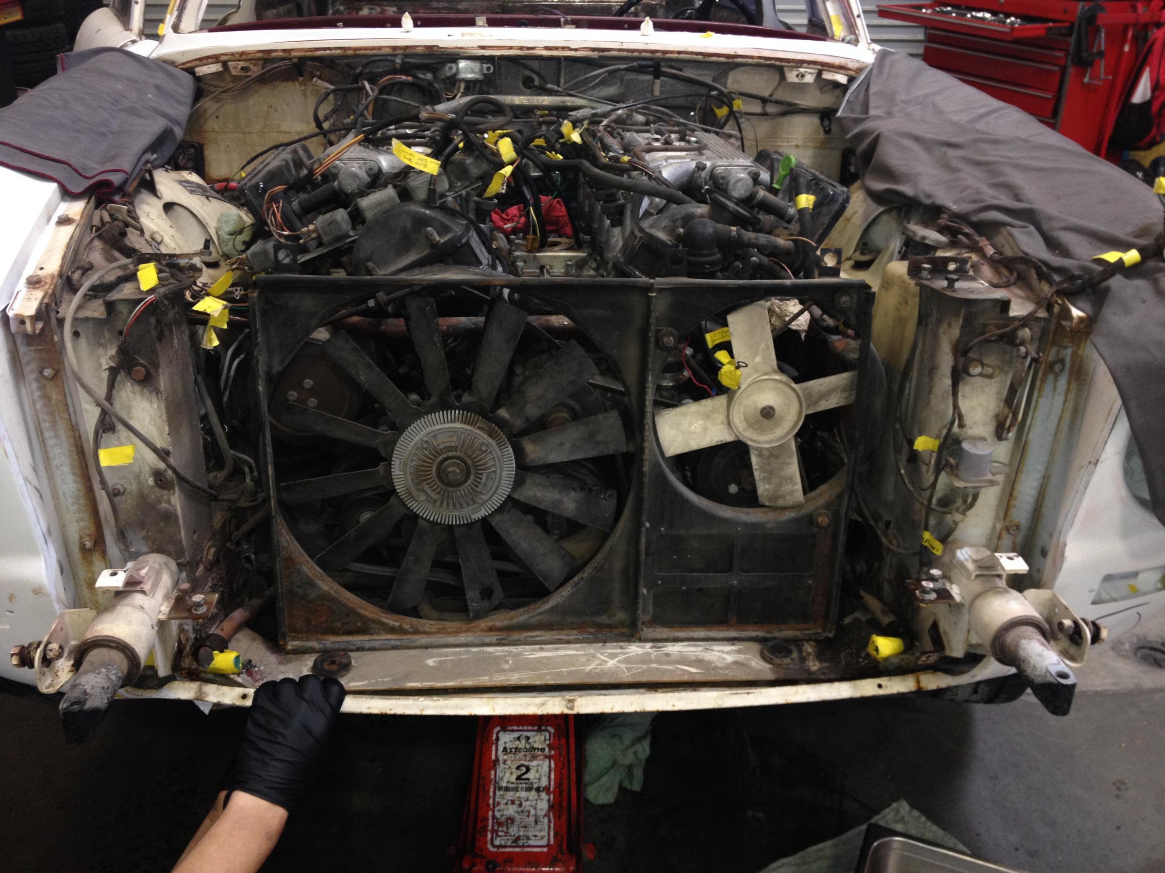

Cool Pulling the radiator out.
Hi guys,
Sunday at the shop! I pull the radiator out and starting to pull the engine accessories to prepare the engine bay to paint. We already seal some areas because I wouldn't like to see any rust on them. I found some more cancer areas with rust under the battery and the brake booster.
booster. Rebuild or change? what is best for prices on these Jaguars.
Top vents (I don't know the name in English) by the windshield defroster are broken. I mean the small boxes with a vacuum actuator to direct the air. The plastic falls in thousand small pieces. It is common problem? easy to find good ones or just should I make my own ones with aluminium ?

Old Oct 20, 2014 | 11:27 AM
  #71
geneo's Avatar
Joined: Jun 2011
Posts: 246
Likes: 75
From: phx/flg az usa
years ago I used this guy, had good success.
Booster Dewey
503-238-8882
hope he's still around
Old Oct 20, 2014 | 01:18 PM
  #72
Posts: 26,764
Likes: 10,312
Debbie,
My car is also a 1976 and I have dealt with many of the body issues you have now.
The demister boxes were actually held together with pop-rivets and duct tape when I got the car and were completely useless. I discovered that Series 3 boxes fit but you need to carve the bottom of the grill a bit so the flappers will work correctly.
The cracks you found are where the roof is attached to the pillar. Mine have cracked the paint on both A pillars but there's no other indication that the roof is about to fall off or anything like that.
I got a new brake booster from British Auto Works in North Plains, Oregon.

My series 1 has cracked paint in the same area both rear and one front pilar, hasn't fallen off yet.

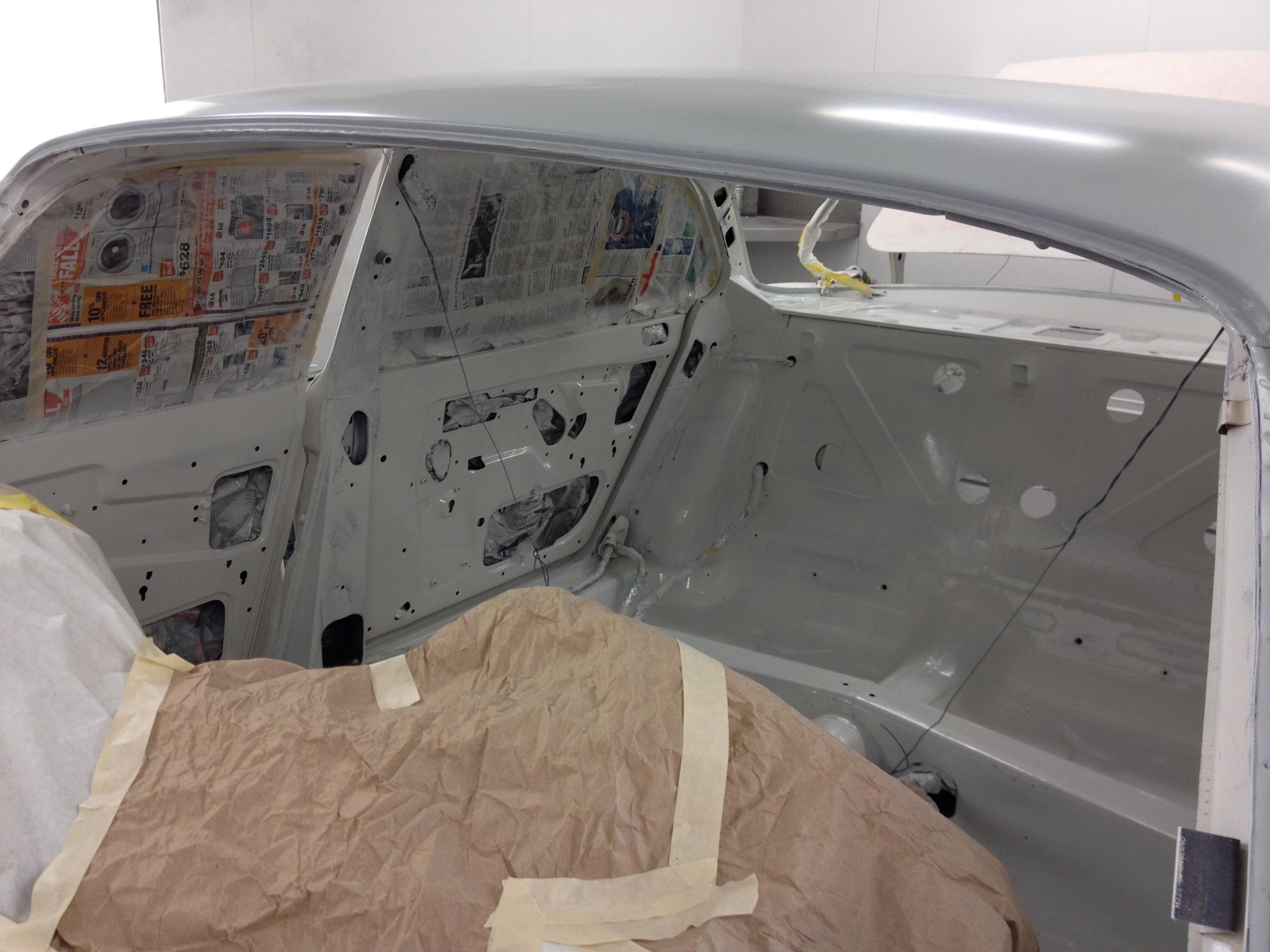

Smile Interior
Only a quick reply to show you guys the POR15 on the XJ12 floor.
I think is cool. Then Seam sealer on the corners and color.

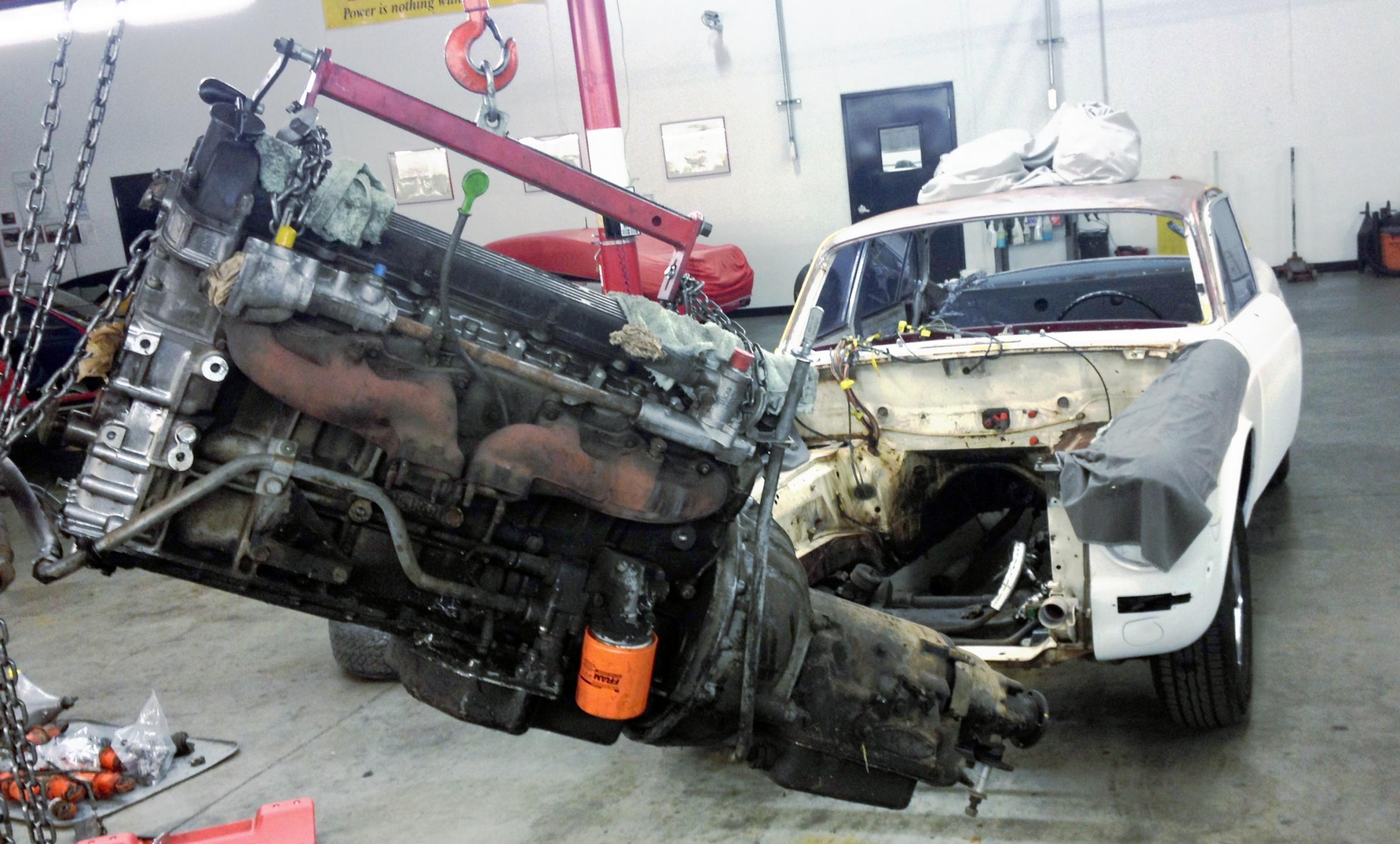

Smile Sunday late!
Hi Guys!
Engine is out! ready to sand and prepare the engine bay area. I'm 'very beginner' in Automatic transmissions, any tips? It seems to work find but now is the time to make all the checks. Same for the engine, tips are WELCOME!!!
