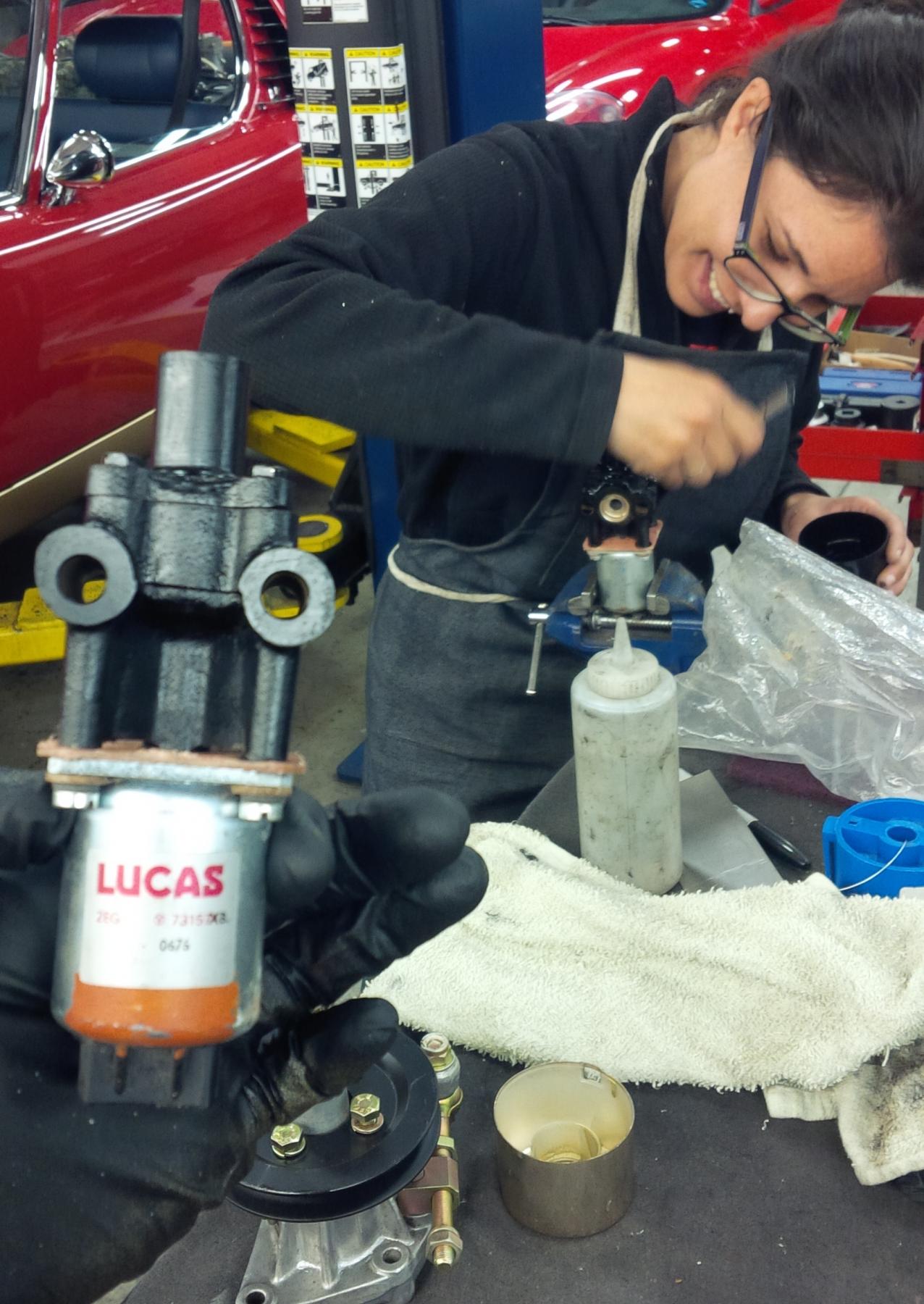

I'm just making an update of the parts detail. Emma touching up the new EGR valves. This XJ12 have a ton of parts.

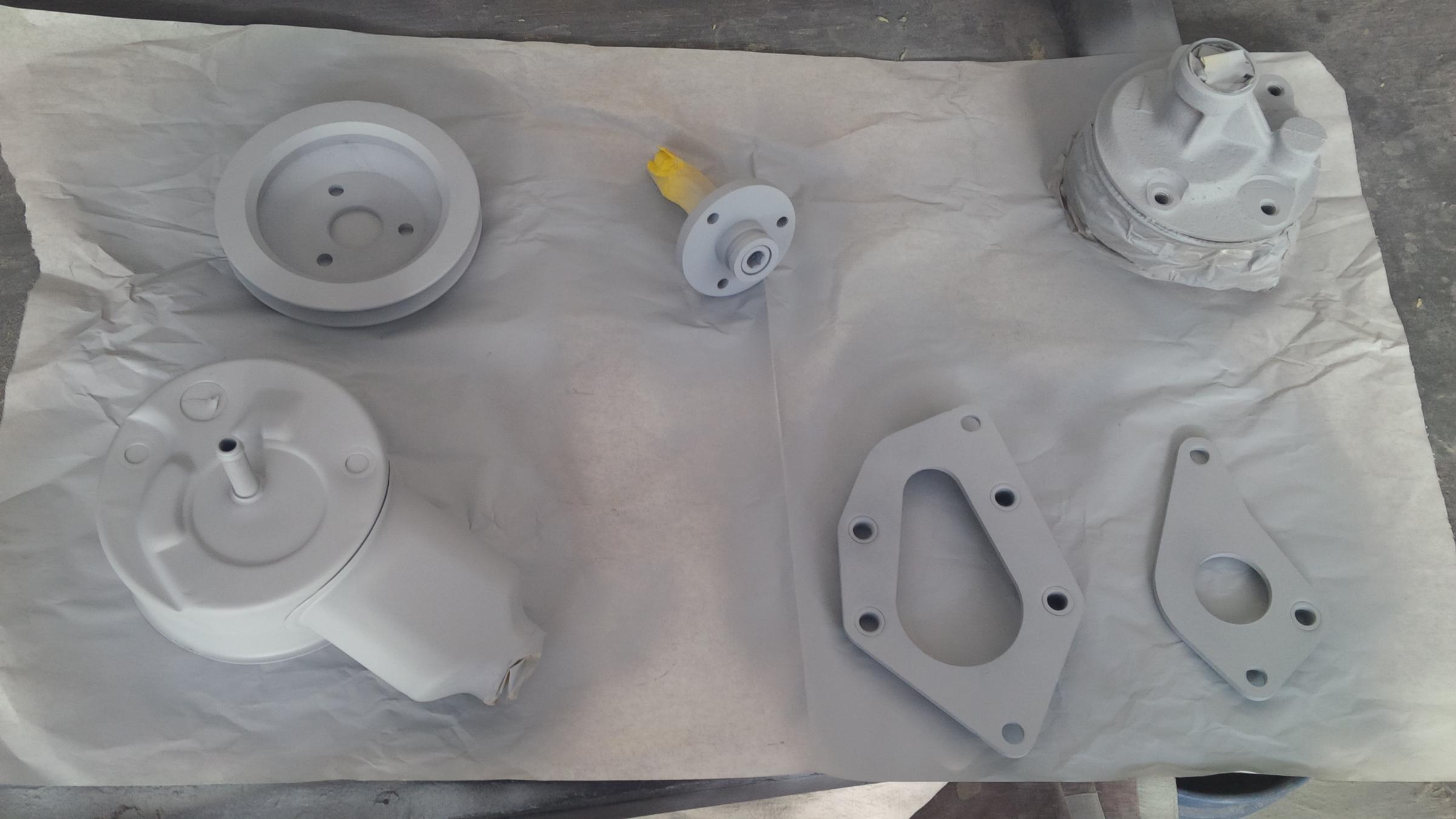

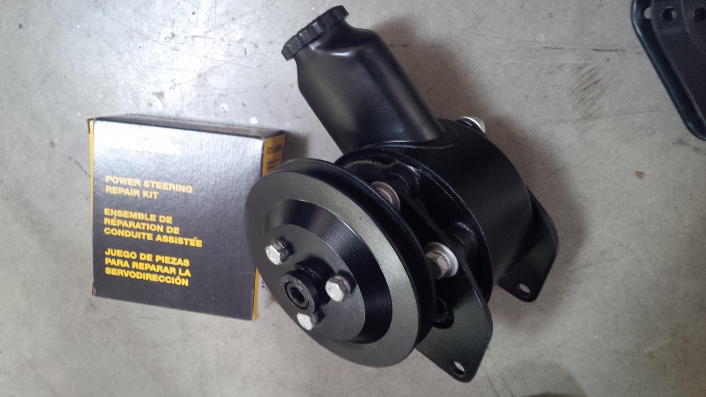

Cool Power steering
Steering pump rebuild and paint. It's ready to install.
Please, I would like to see your pictures of a transmission (BW Model 12) rebuild and rear engine crankshaft tips. THANKS!!!
Debbie
Attached Thumbnails 1976 XJ12, New home-img_20141220_194553.jpg   1976 XJ12, New home-img_20141221_104100.jpg   1976 XJ12, New home-img_20141221_135403.jpg

Nice job on the PS pump, I did mine recently but just stripped it and fitted the new kit because I wanted to drive it that day. You have the luxury of having your car in pieces so there is time to paint everything while it is out.

EGR's on that "experienced", thought that came much later on domestic cars???

The PS pump is the familiar Saginaw by GM that was found in a lot of places. tough as nails, but if a replacement is needed, readily available, in rebuild nowadays.

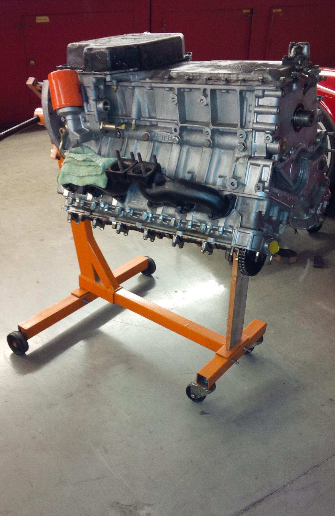

Engine on the stand, ready to open and change the rear oil seal (this thing made me think about it... -NOOOO my father showed me that always I should be stronger than the engine. No lazy time! This oil seal is older than me and I should be replaced.

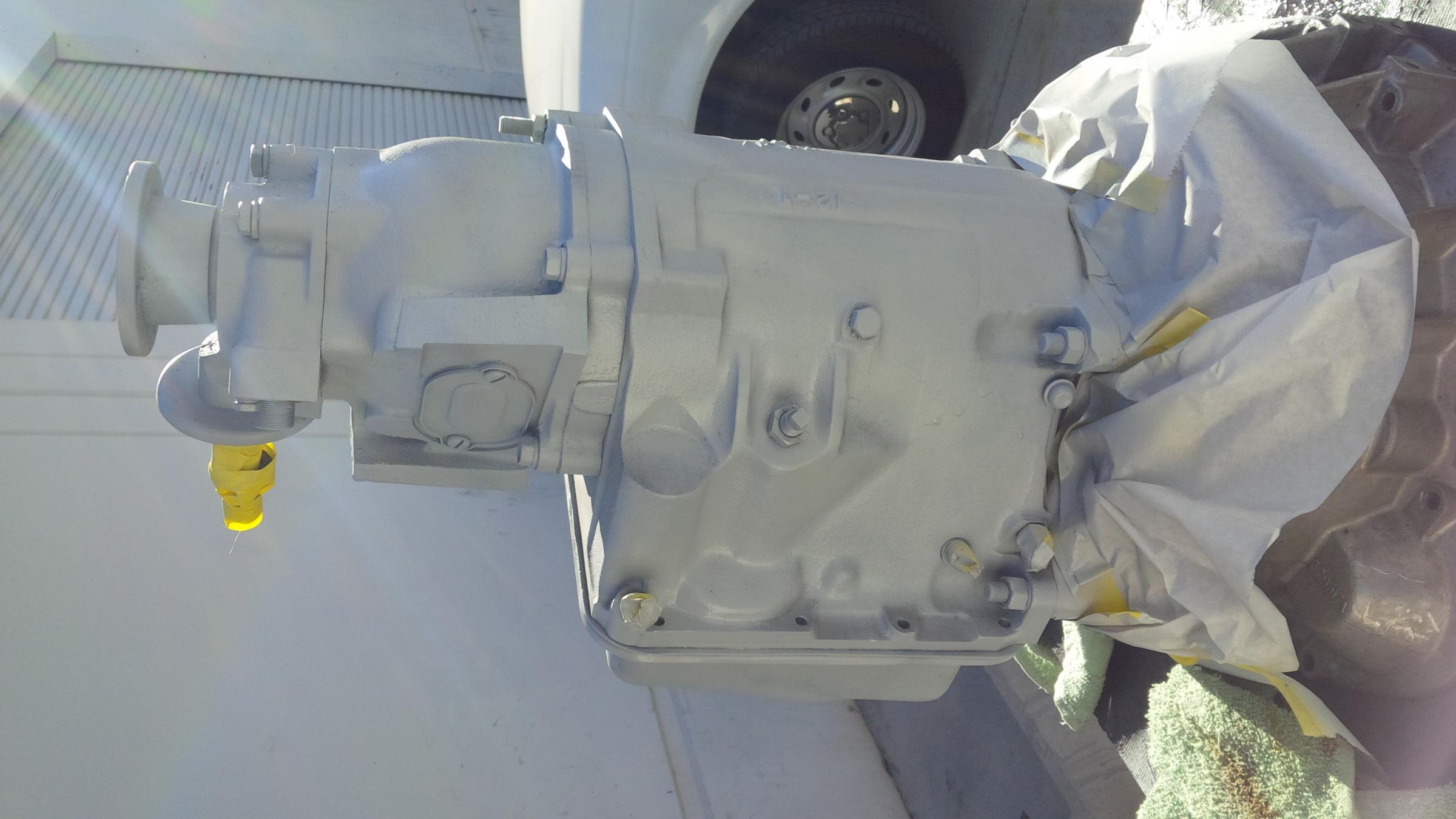

The vacuum unit on the transmission in on the specs without leaks. I'm going to reuse it.
The transmission. I didn't rebuild it. just front and rear seals and new fluid of course.
Debbie.
Attached Thumbnails 1976 XJ12, New home-img_20141226_184450_edit.jpg   1976 XJ12, New home-img_20141225_125359.jpg   1976 XJ12, New home-img_20141225_143119.jpg

Nice! What was done to the transmission? Cleaned? Painted?

As I said. I didn't rebuild it. I've just changed front and rear seals, new fluid and filter of course.

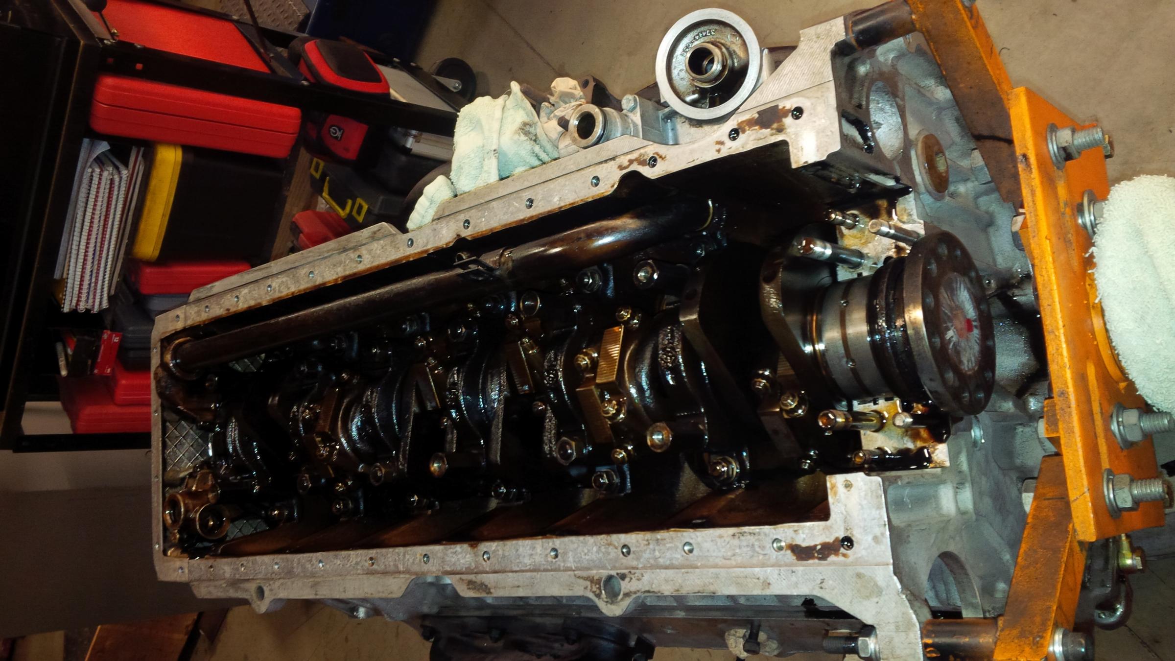

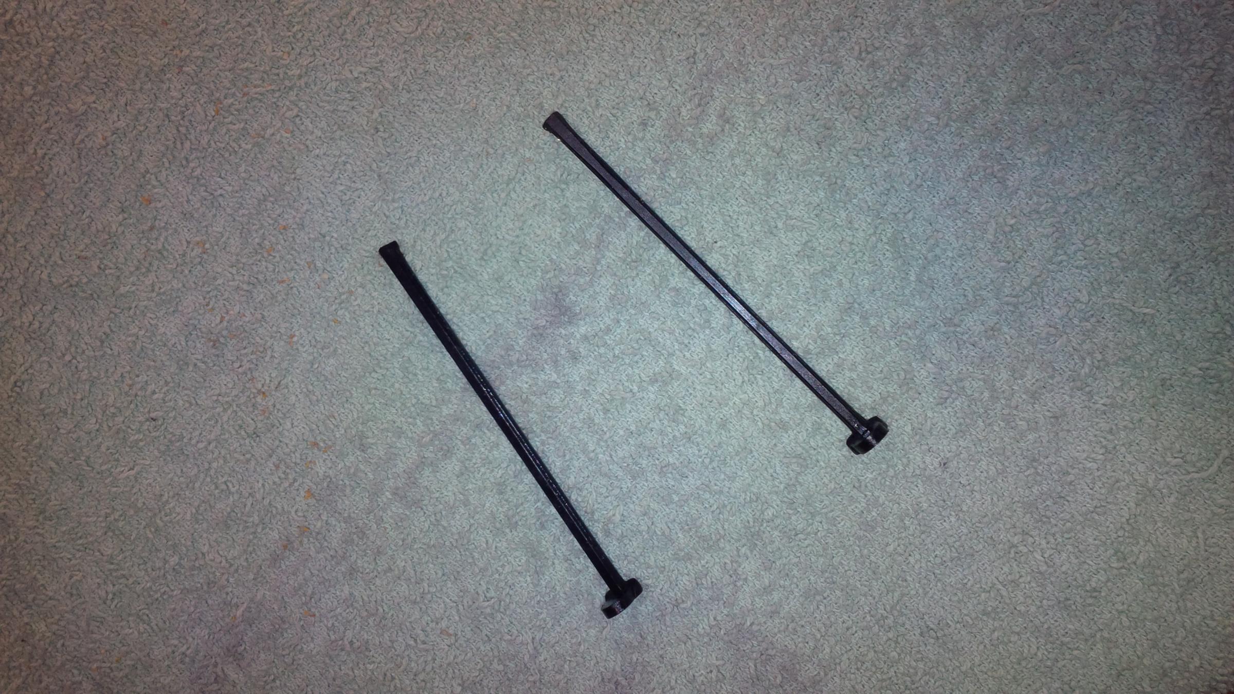

The rear main seal is out! time to check bearings.
Attached Thumbnails 1976 XJ12, New home-img_20141227_174010.jpg   1976 XJ12, New home-img_20141227_175155.jpg

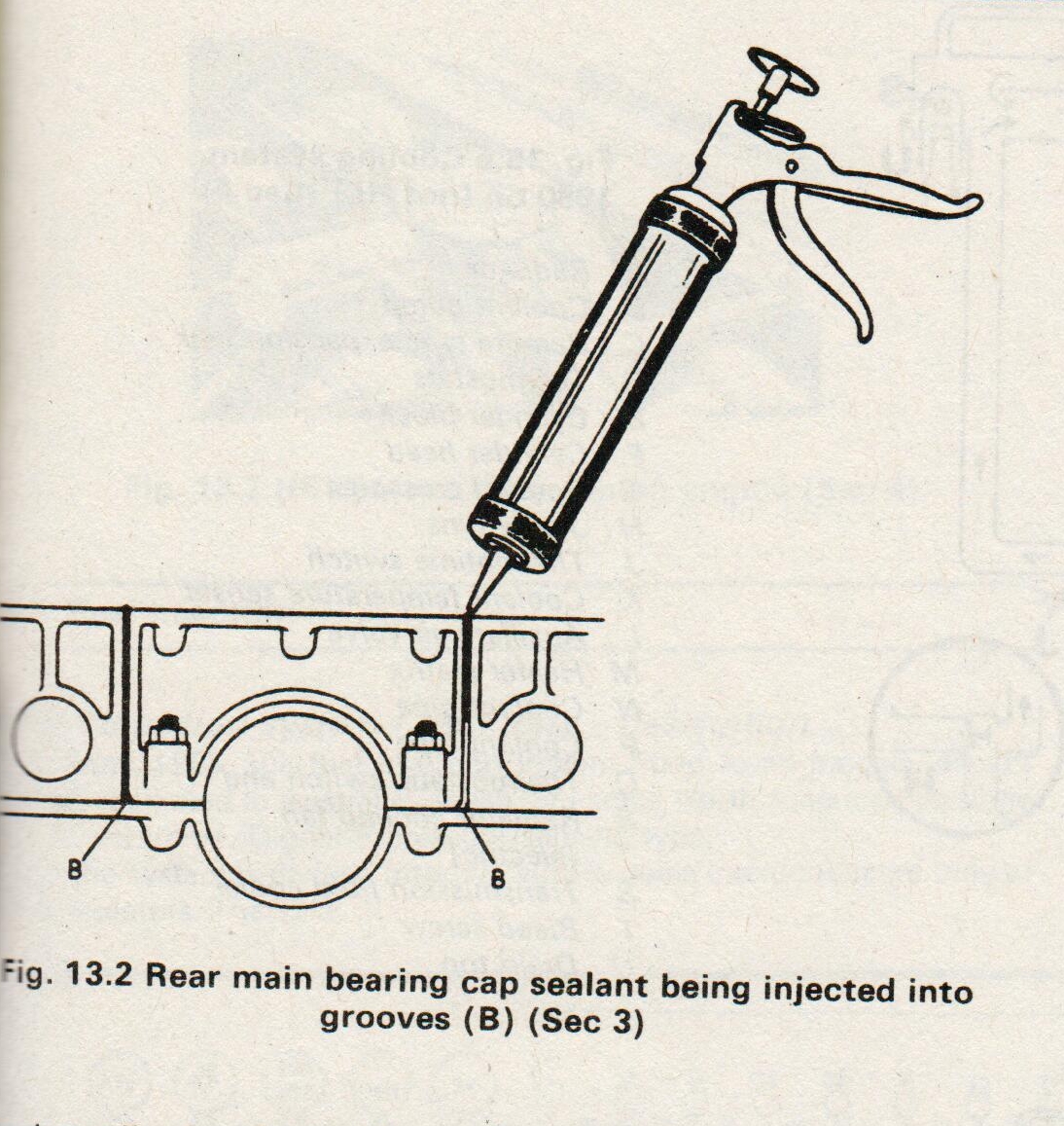

Question Rear Crankshaft bearing seal question.
Help is welcome!
Since I saw this update in the Haynes book. What do you guys think?
I should buy the rubber 'hockey sticks' or use silicone? which product do you recommend me?
Debbie
Attached Thumbnails 1976 XJ12, New home-jagbearing.jpg   1976 XJ12, New home-jagbearing0001.jpg   1976 XJ12, New home-img_20141228_181508.jpg
