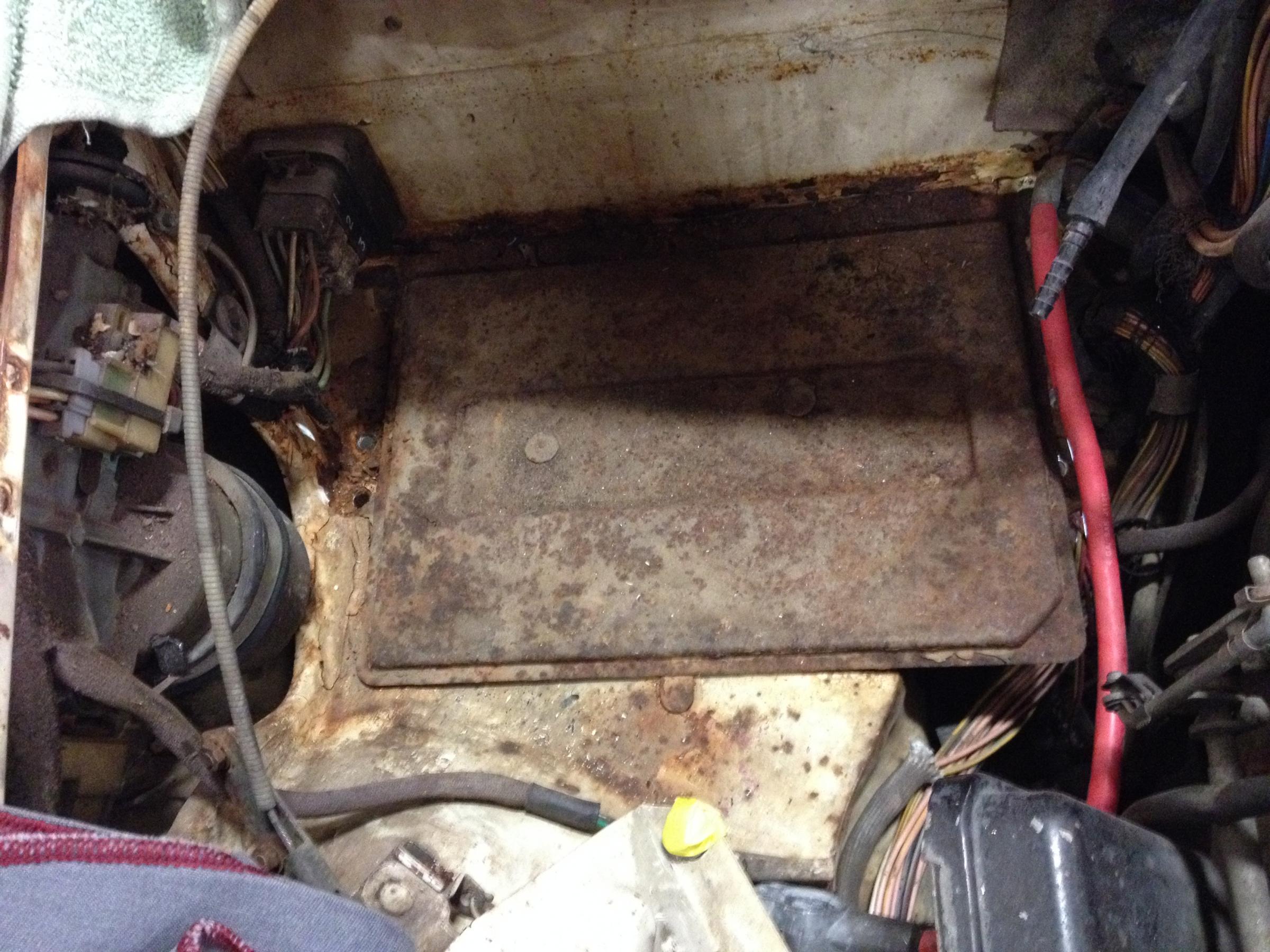

I was going to rebuild the battery tray... but my coworker/friend Nigel convinced me to make a new one from scratch. He is from Coventry, England. He has an awesome background. He started fabricating body panels for Rolls Royce and currently is working on Italian super sport cars. So I'm very proud of my battery tray. Now waiting for the powder coat.

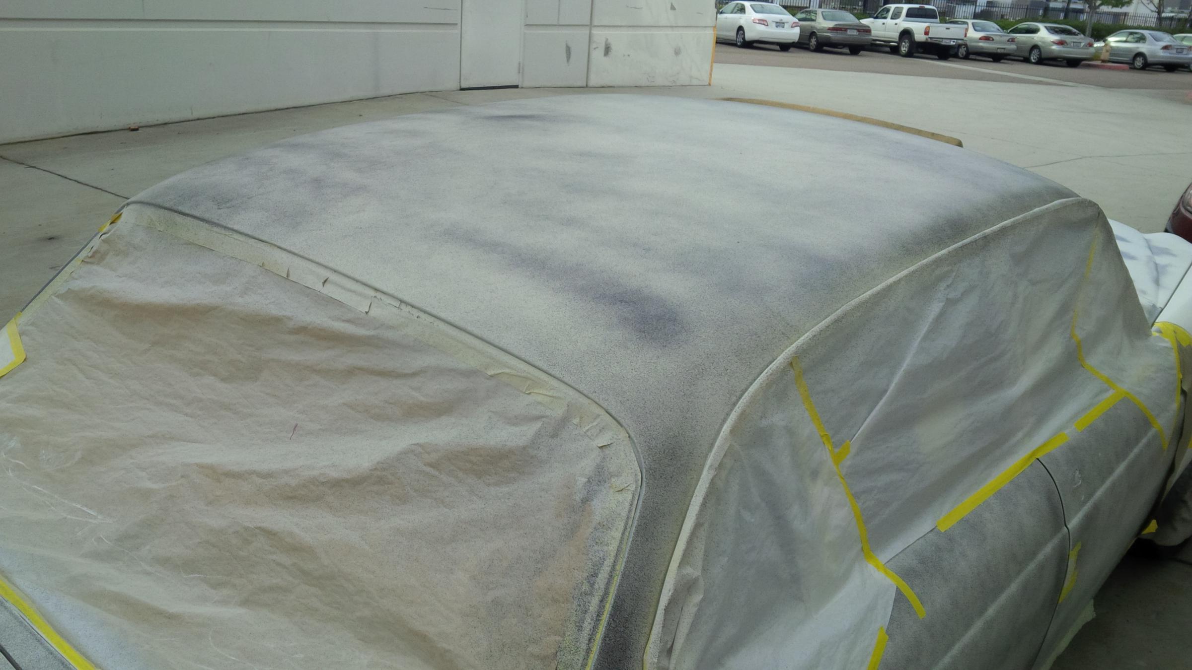

FINALLY the roof is perfect! OMG it took Forever... Dave and Allen helped me with the dents. Then small dents and more small dents
. They have a pretty good eye and the whole roof went back into it's own place. It was a great accomplishment since it was BADDDD (just like somebody walked over it). Then some 'magic' REFACE primer and perfectly flat. THANKS FOR ALL YOUR HELP GUYS!! Is a huge roof surface... It took me several full weekends sanding and sanding.
