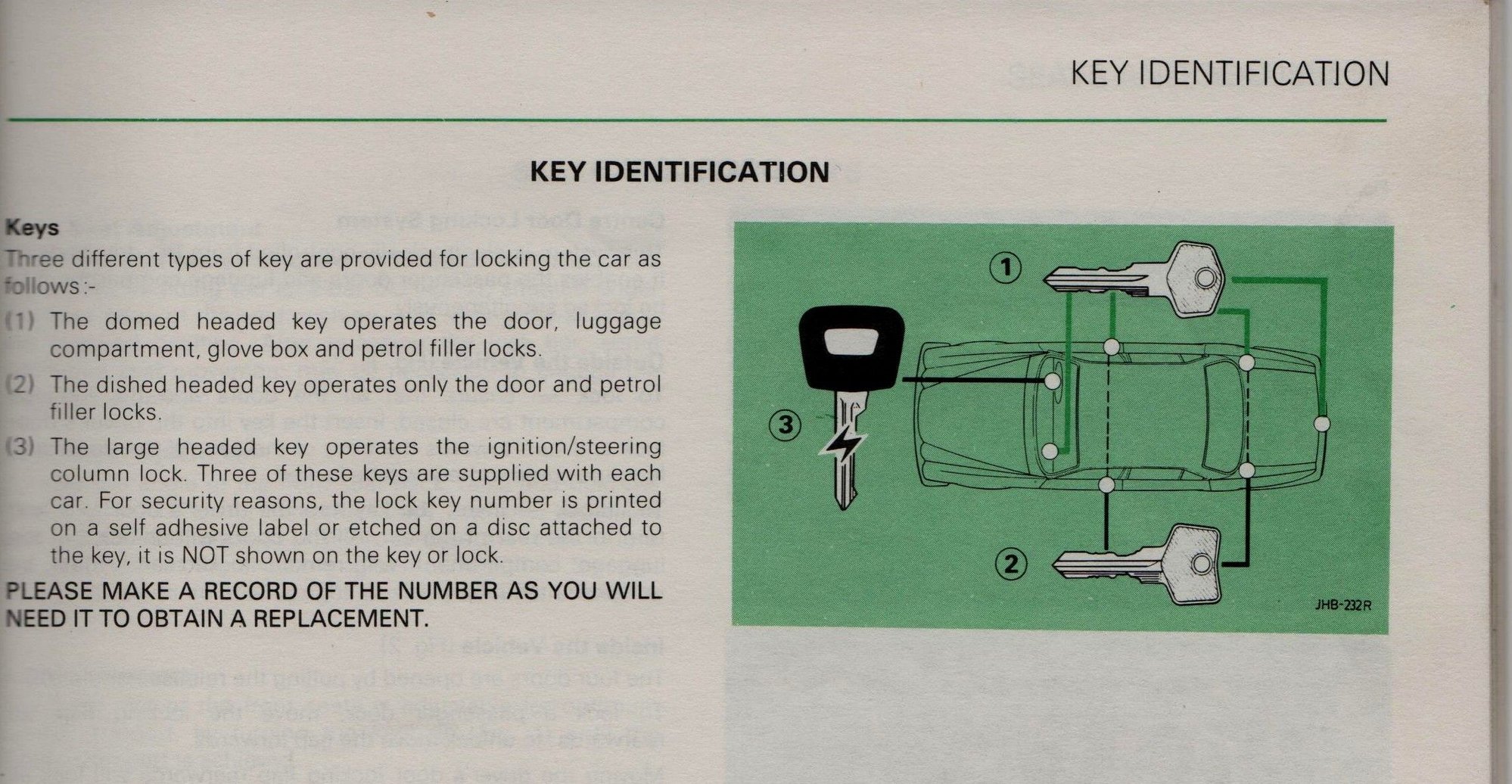

Hi, just to recap the Series 3 cars 1981-1987 should have had three keys from the factory.
Ignition key is single sided
OEM Waso FZ/FR ( rubber cap )
Ilco FT6R ( all metal )
Door, glovebox, gas caps, & trunk/boot double sided. Domed top
Ilco BL6
Valet key same as above but thicker "wings" to prevent it from fitting the glovebox & boot. Dished top
Ilco no blank found
page from the owners manual ( originally scanned / posted by Jose ).
Picture of the keys, the dished one is the valet key
The blanks are available online and on ebay etc. If you can find a "old school" brick & mortar locksmith they can make a key ( using a blank ) to fit the removed ignition lock or glovebox lock. The mobile guys usually don't have the experience or patience to disassemble the lock to do the job. They just want the quick, easy jobs ! I've had spare locks keyed by my local guy for reasonable prices.
