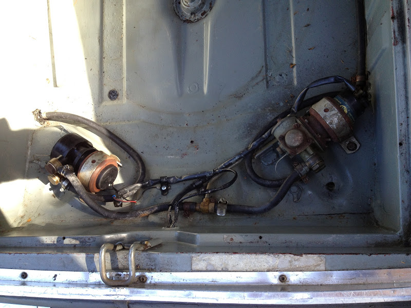

On the S1 you are talking about? I don't think that the modification is that difficult, just connect the lines from the tanks to a "T" connector, then out to one pump. I would put it back to stock, though. Some think that the second pump is one more thing to break, but I prefer to think of it as a built-in spare in case the other one dies.

My series 3 came with a similar cluster in the boot. Tanks come together into one T-fittting and then to the pump. i also do not see a transfer valve. On yours, it looks like the fuel cell just takes the place of the tanks in the wings. I wonder if that is because the wing tanks need work, or if they didnt want to mess with a problem in the system. Putting it back to stock may be more work than you think.
