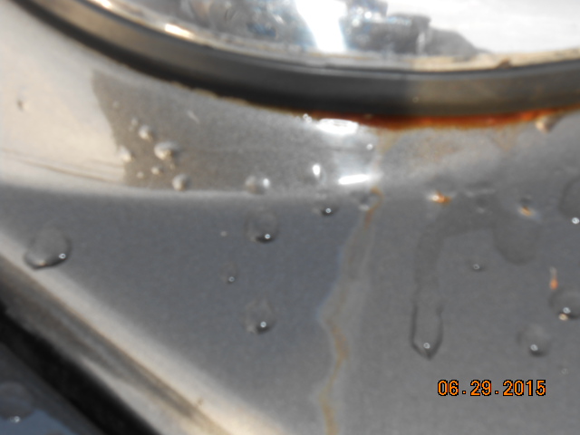

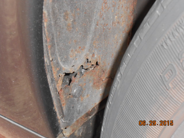

More importantly if I were you I would be after the rust first. Especially around the windscreen corners. Be prepared to remove the windscreens to do a proper repair.

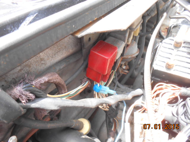

The fans are running probably because they are wired in conjunction with the ignition circuit. Key on = fans run. You will need a temperature switch wired into the ignition circuit THEN they will activate the fans when a set temp has been reached.

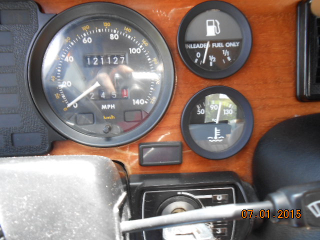

I installed a thermostat and ran the car for 1/2 hour, temp read about 100C. (pic 2)Placed fan in front of grill and the temp dropped back to 90C.(pic 1) Prior to this it would be almost at 130C. I am keeping my fingers crossed. I will cycle it a few times to see what happens. Also, the PO connected the fans to the power wire on the diode pack.(pic 3) I will rewire the fans thru another switched source.

My 84 XJ6 has an aftermarket temp gauge, but I've never understood the stock gauges on these with the needle being in the green (meaning 'ok' to me) all the way to about 125C/257F. I get worried at 100C.

Yeah that green past 90 C sure is misleading!!!!

That green band on the gauge isn't one of Jaguar's finer moments, that's for sure. Another prime example of "....an interesting design feature"
