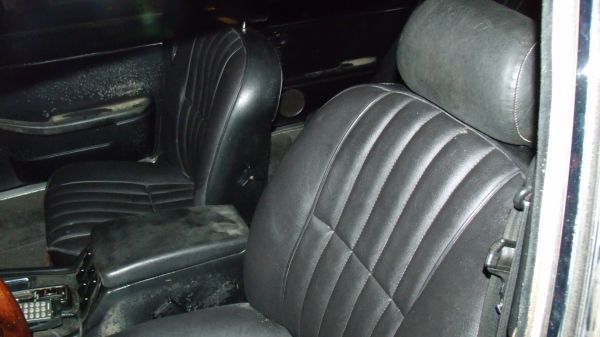

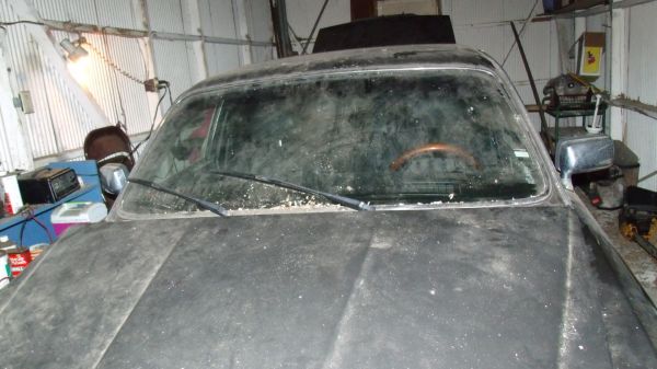

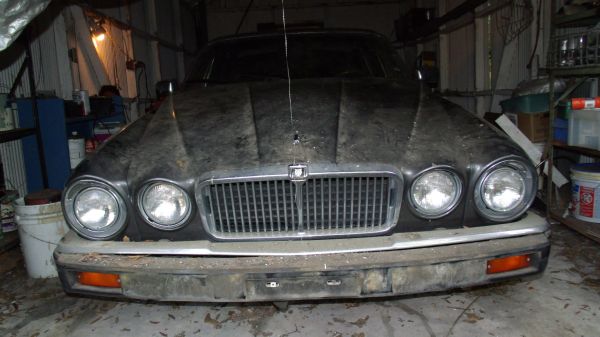

Look at what I found! This car was parked up for 11 years. The PO was saving it for his retirement. Unfortunately, he passed away. Car has 56000 miles. Will be picking it up sometime this week. I inadvertently attached the wrong file. The images on the original post cannot be opened up. see my corrected post below.

Yes sir. and I believe they can still be reprogrammed and made to work. Will figure out that later.
Jose, if you read this post and you are interested, I can offer you some side work on your days off.(I pay well). I have three other Jag projects going on right now.
I may also need you as a peacemaker (LOL). This car was found in Deland through a friend of mine.

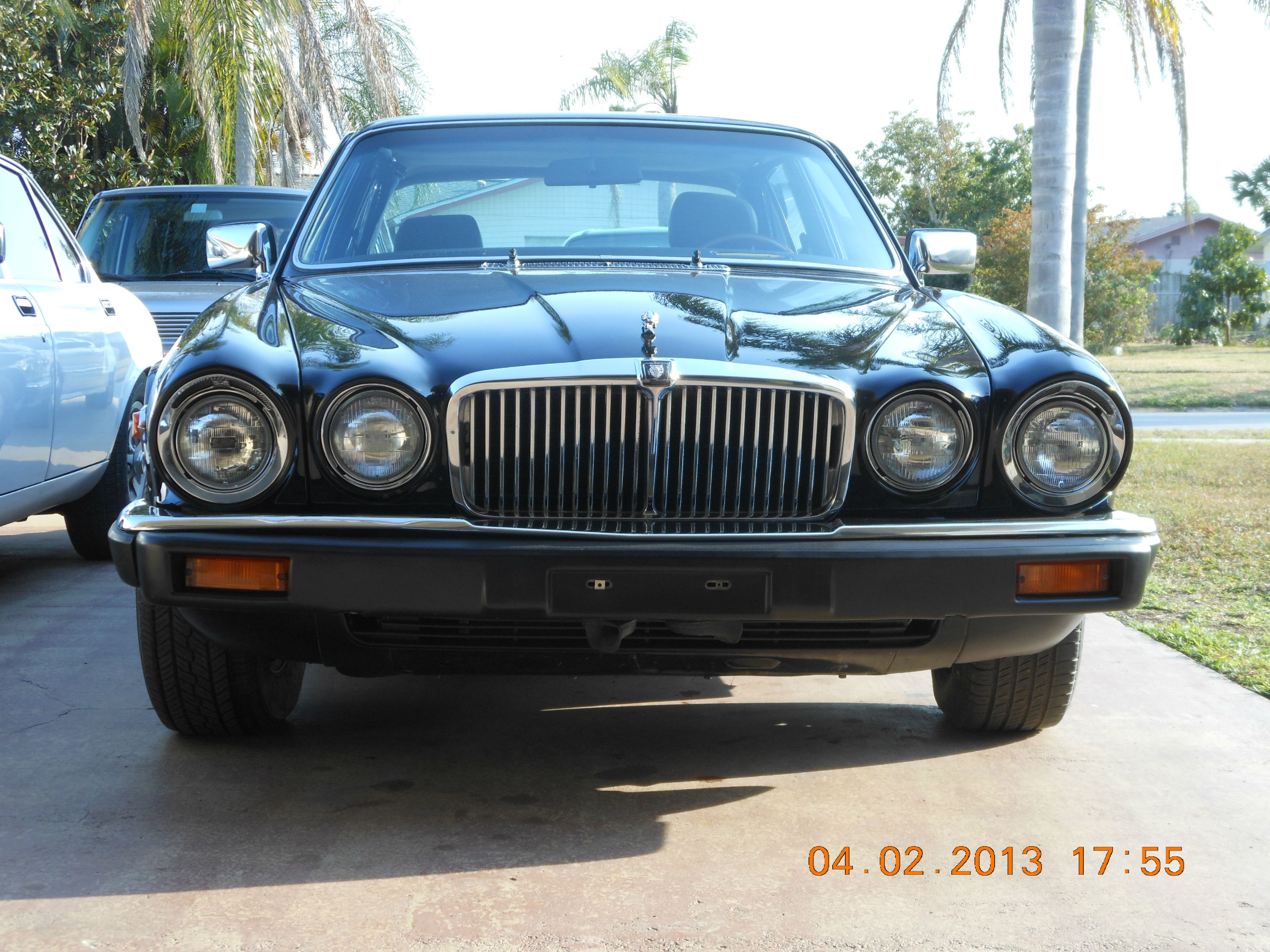

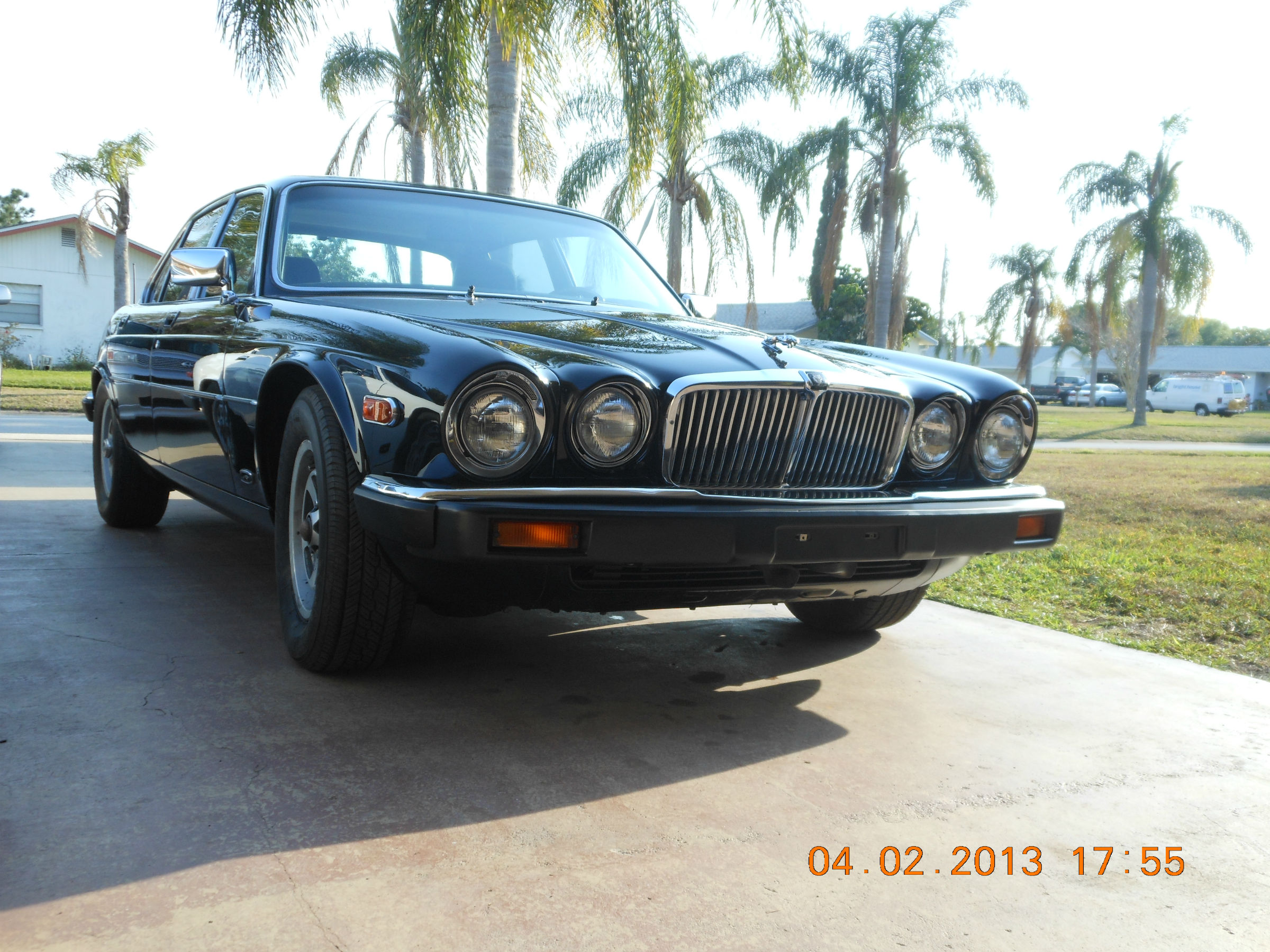

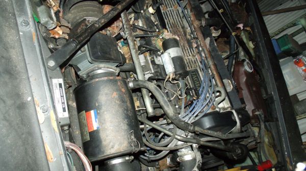

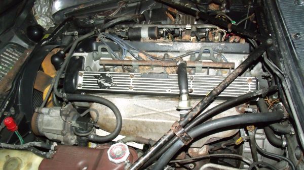

So, I have finally started the restoration on this car. After a good cleaning of all the electrical connectors the car finally started. it runs very good. I completed the interior and pretty much everything works.
Now to the main issue. I just ordered the steering rack bushings and the three piece windshield seal kit from Coventry West. I have to remove the front and rear glass to repair the usual rust spots. Has anyone attempted to remove the windshield from their series 3 car? Given that I am replacing the seals, can I cut the old seals to remove the trim or should this be given to the pros. I figured if I removed the glass, then I would only have to pay for the installation. the guys around here want $300 to remove and $300 to install. Any input or advise will be greatly appreciated. Will be posting some pics as I go along with this restoration. Thanks

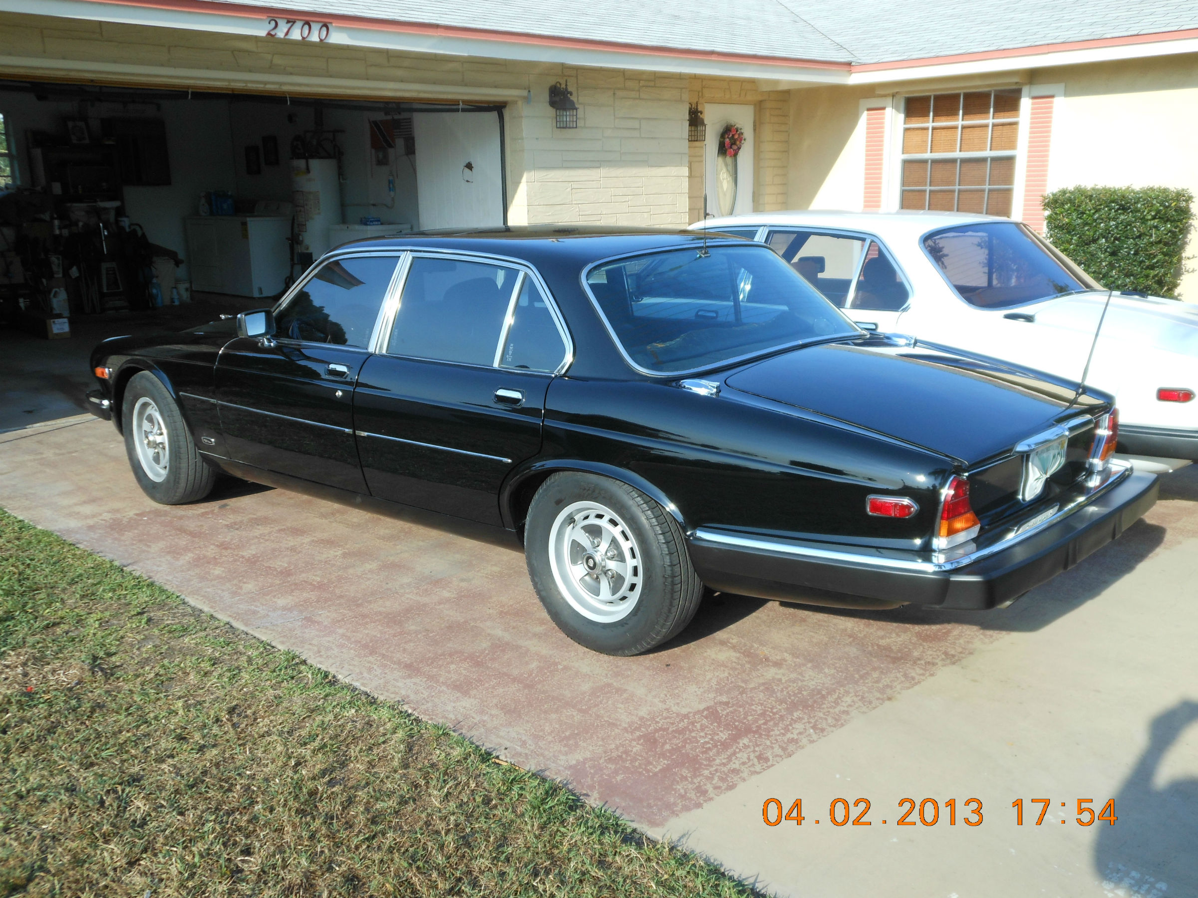

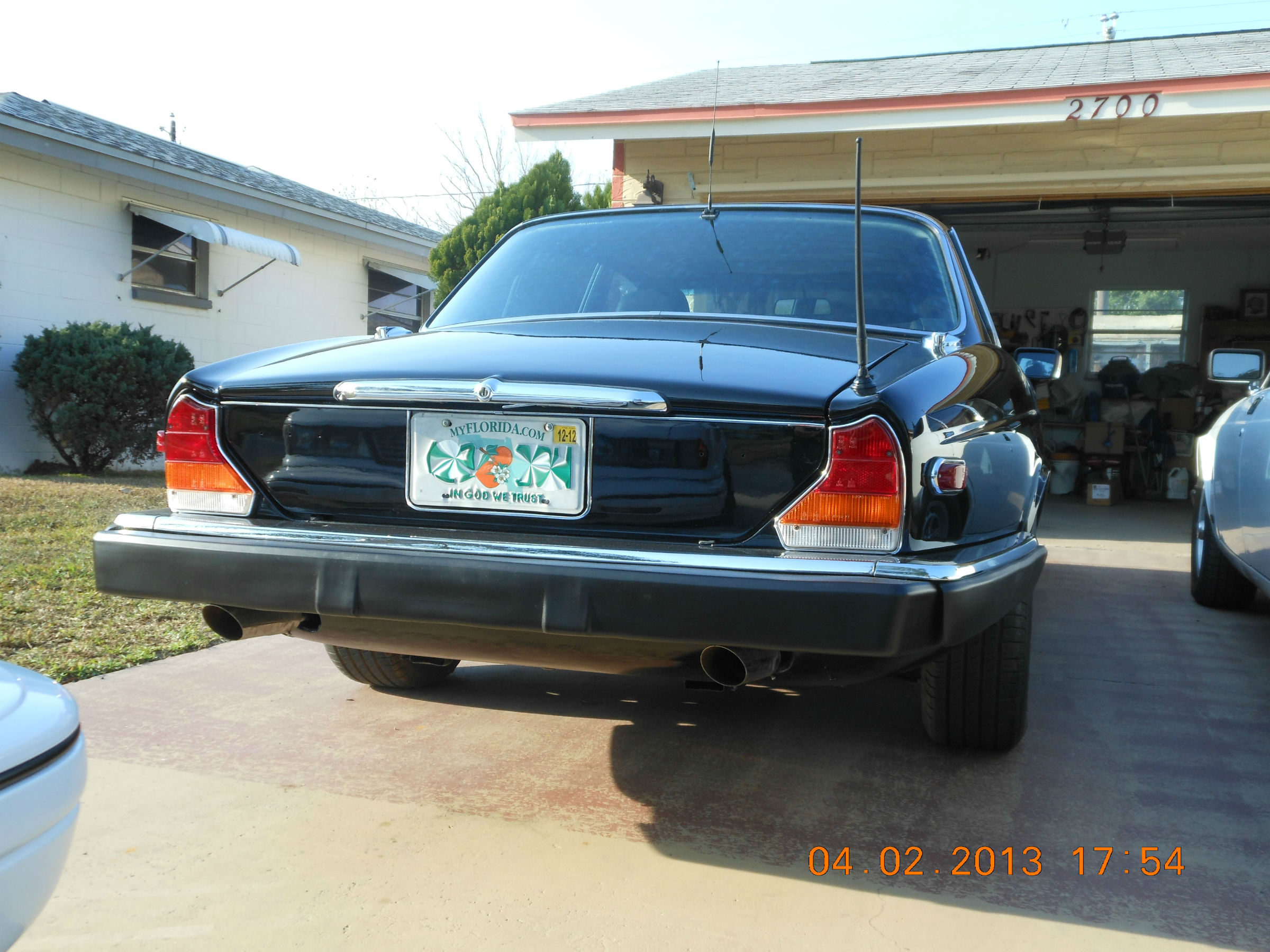

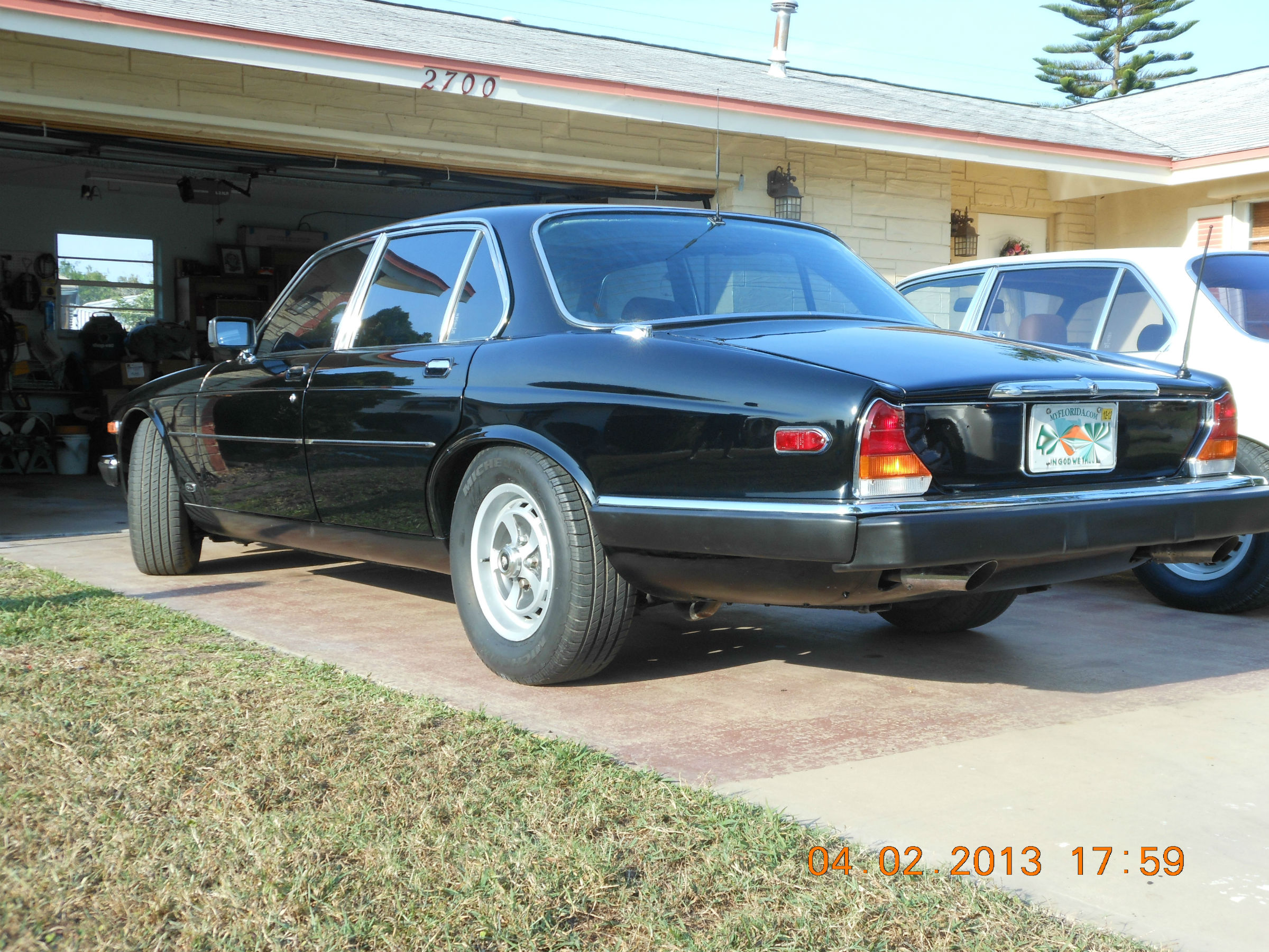

It's been a good three months since I last posted re this project. I was able to remove the front and rear glass. The front glass was removed junk yard style so I had to purchase a new one. Having learn't from the front glass experience, I patiently removed the rear glass with no problems. I formed and brazed the rusted areas at the bottom of the front and rear glass. The paint work was bubbling on the top, hood and trunk lid and all the areas exposed to direct sunlight. The top of the doors, fenders.
On sanding, I found that the bubbles were coming from rust under the paint. Four gallons of Aircraft paint remover and I was down to metal. I repaired all of the dings and dents. For those of you who have never done this, here is what you need to know. The yellow or beige 1/64 thermoplastic coating used on the Series 3 was used as a leveler. When this coat is removed the bare metal is very wavy. I solved this problem with two gallons of epoxy primer, three coats and block sand, three more coats and block sand, three more coats and block sand................ Finally when it was all level again, I sealed it with Matrix 2K primer/sealer and was finally ready for paint. Three coats of single stage Acrylic Urethane and I had enough of the body work. Here are some pics of the finished product. Now that the car is looking good, I have to deal with some braking issues

Thank you guys. As far as the exterior being complete, I am pondering on whether I should have eliminated the side moldings. What are your thoughts on that? If I get enough static from the forum, I will go ahead and remove them, weld up the rivet holes and respray the lower portion of the car.
I still have to do the rims. I am looking at a cheap powder coating unit from Harbor freight. I have never done this before, but I will first experiment with any old rim that I have. I have a commercial oven in my outdoor kitchen which I don't use. The oven size is 36x40, so it is big enough to fit the rims. The plan is to do it in two phases. The Silver, then the black. Since I do all of my work, what the heck, I give this a try.

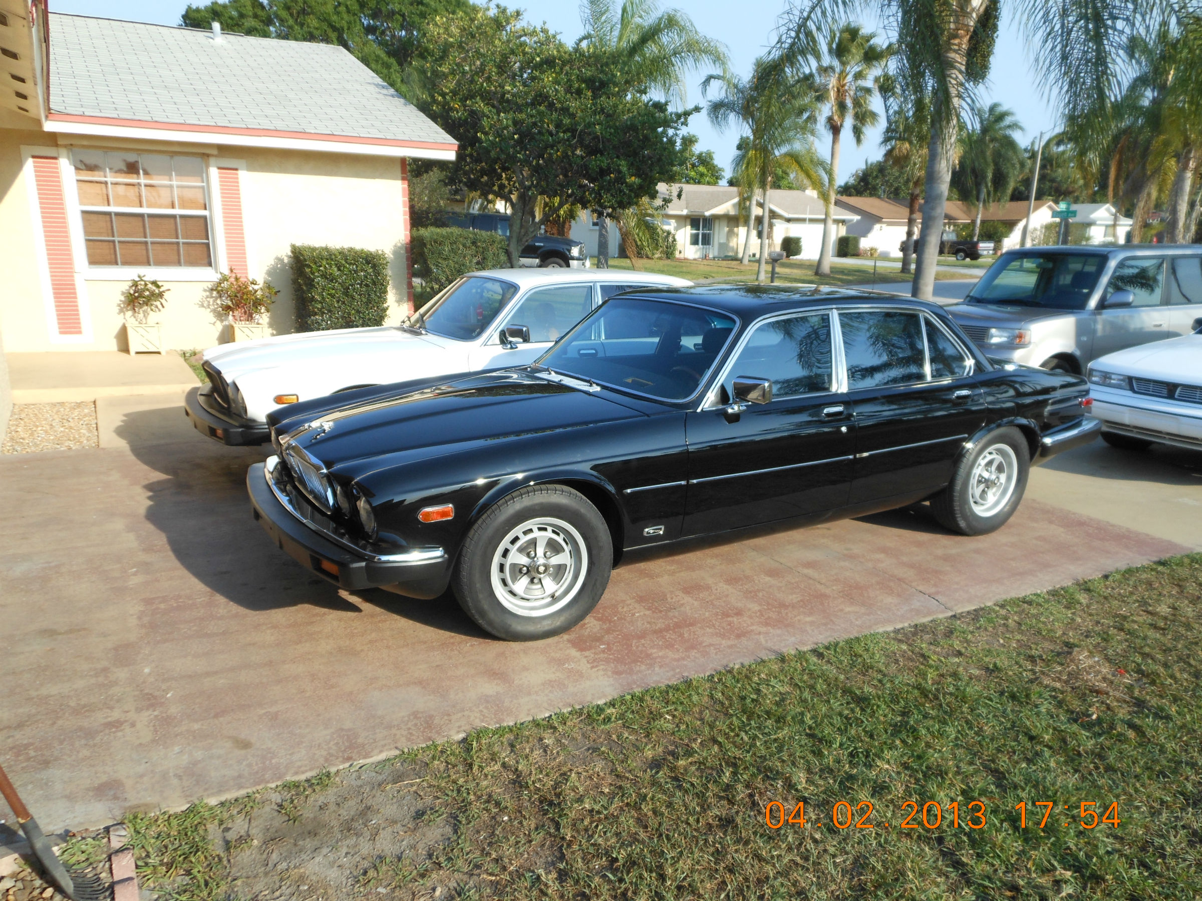

That is one nice car. A lot of work by you has made it nicer.
Although Thermoplastic paint has been soundly criticized by many, I think my car still wears it's original Grosvenor Brown. Imperfect, but shines up well . And, no burnt clar coat.
Someone changed the front wind screen in the past. One side of the trim not well replaced. One item of my evergrowing task list.
