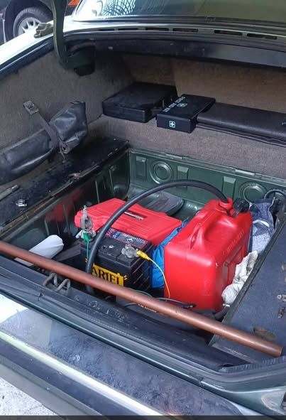

I took the hint and pulled apart the bullet connector for the trigger wire, it was covered in verdigris.
After a quick clean and reassemble I was able to start the car for the first time in 10 years.
It ran a bit rough at first but then it settled down.
I had to move it out of the carport so that I could get access to 2 other cars stuck in my garage.
I will get my RH fuel tank back from cleaning this week and reinstall it.
I can then get rid of the temporary fuel tank (jerry can) in the boot/trunk feeding straight into the fuel pump.
See photo.

Curious..with your temp gas can feed, where is the return flow going. I assume into the tank that is remaining?
Old Feb 10, 2025 | 06:19 PM
PaulL's Avatar
Joined: Nov 2019
Posts: 50
Likes: 20
From: Brisbane Australia
Yes, I have the Fuel Tank Selection Switch set to the LH tank so that the returned fuel will go there.
Otherwise it would end up on the ground under the car.
