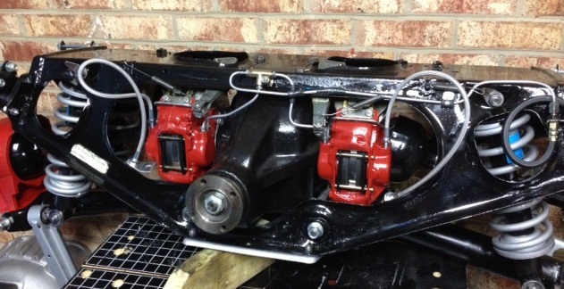

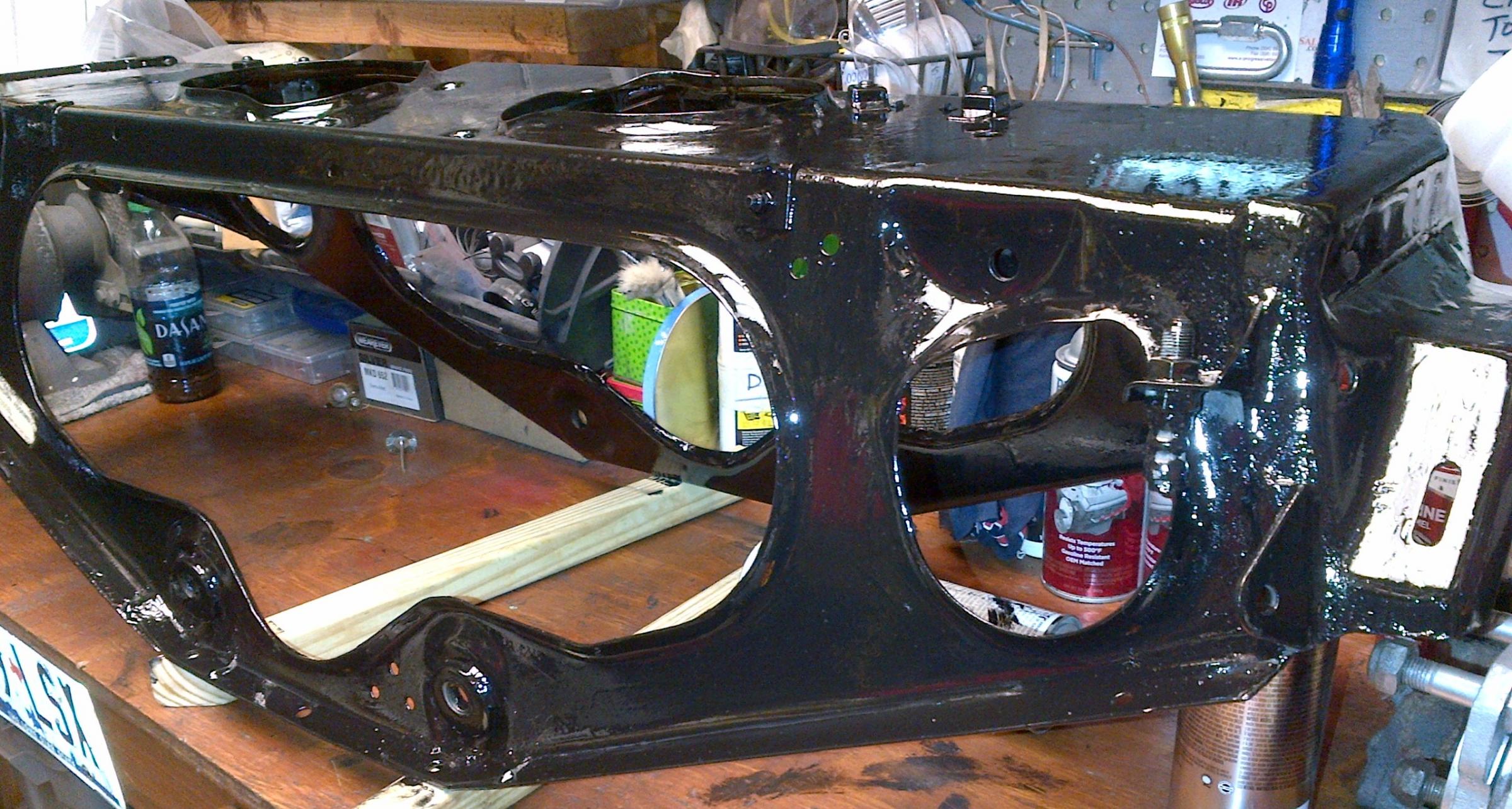

From: NC
An Update - The final drive has slowed me down more than a little. Just a guy in a garage, no sandblaster, no dip tank - it is a WAR to get this thing cleaned up. I have tried different variations on all types of cleaners. Used the power washer - over and over again. No joy. You need a wire brush, a case of brake cleaner, and time. That works. It is just slow work. Finally broke it all down, and I am systematically working through it. The center section is back together. New side bearings and seals. The main bearings all appear to be intact and stout. All gears intact. No teeth missing, smooth action, and tight. I have U-joints, bearings, seals galore on order to work through all the consumables. In general, it is a nasty pig - but tough, intact, and just needs seals. I have not come across a failed bearing yet. Just trashed seals. Still looking though, and I will run them all out before I call it good and hang it again. A few different additional shots in the album.

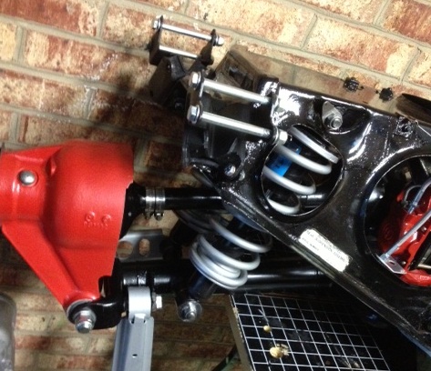

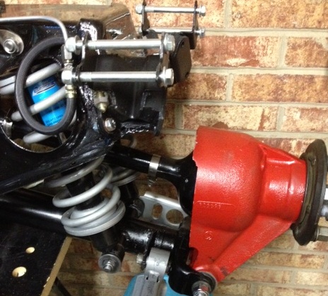

I had my buddy come over, and we wrestled the final drive back into position. The final bill - New driveshaft seals, New U-Joints, New swing arm bushes and seals (Bearings were good...), cleaned an relubed both hubs (Bearings were good...), New mounts, New brake pads and park pads, New calipers, New rotors, and one "Remote" bleeder kit installed. Plus everything cleaned and painted - which I promptly scuffed all up getting back into the frame. Everything is greased and serviced. The only thing left are to bleed the brakes - at least for the final drive.
Next - Driveshaft.
Attached Thumbnails 1986 XJ6 - New to me.-photo-1.jpg   1986 XJ6 - New to me.-photo-2.jpg   1986 XJ6 - New to me.-photo-3.jpg   1986 XJ6 - New to me.-photo-4.jpg

Forgot - New BOGE shocks, cleaned and painted the springs, and new bushes for both trailing arms with a coat of silver POR-15. Do not want them rusting out..

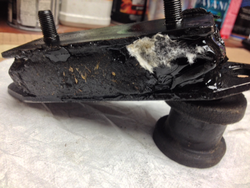

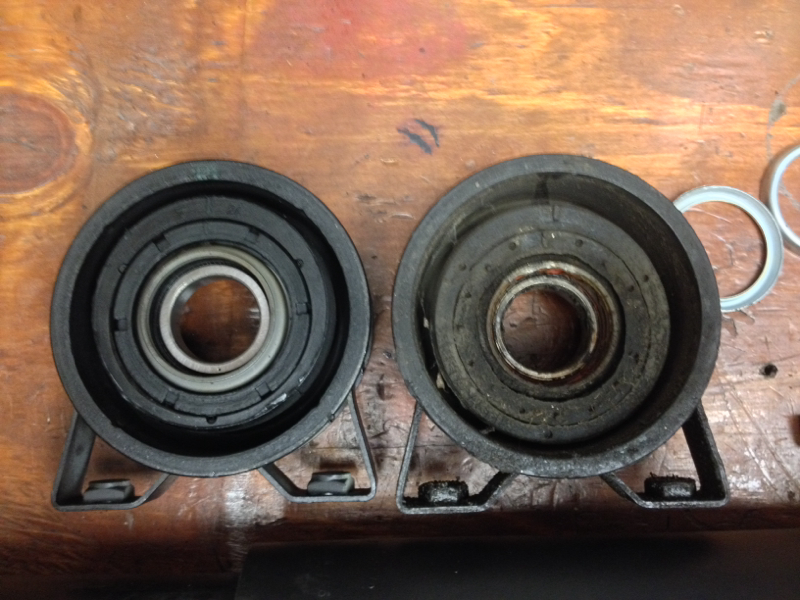

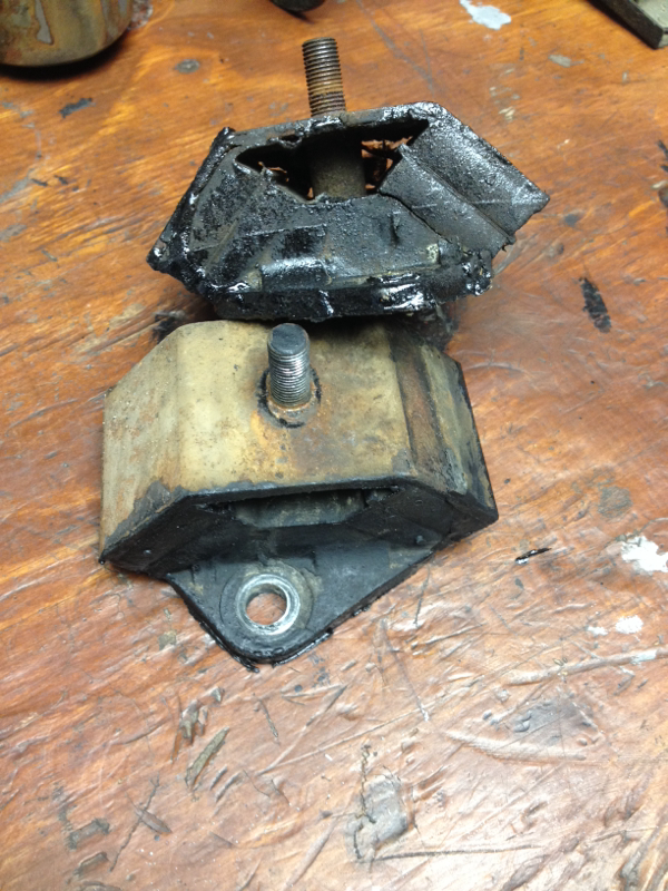

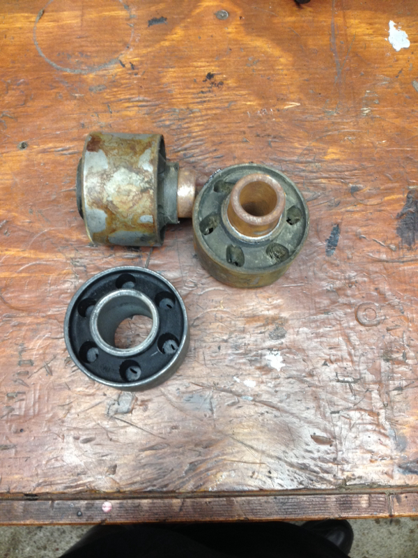

Still plugging away as I can. The Trans mount vibration dampeners were in bad shape. One side was literally melting. I have never seen that before. I broke that down and replaced them. And threw some paint on. Then I hit the driveshaft support bearing, reinstalled the shaft and supported it until ready for the Trans to go back in. I decided to go ahead and drop the front frame support too. Those forward bushings were trashed and I saw a crack in the aft support. Plus now I can truly attack the cram rails where it mounts and properly clean and POR 15 the area I could not reach when installed.
