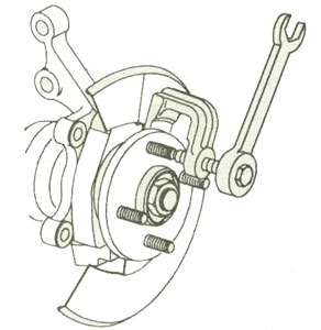

The ***** Cat may get angry from the pounding!
Old Jan 21, 2015 | 07:02 AM
gatekeeper's Avatar
Joined: Sep 2014
Posts: 196
Likes: 38
From: USA.
Usually doesn't take much pounding, but if you have that tool or can borrow one, it's the way to go.
