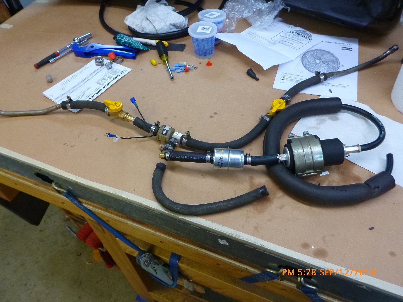

Gerard, mine are 1/2" I.D., but I think the originals said 12 (12mm) on them. 1/2" fits nicely. In the picture, I have since changed the 1/2" lines to a marine grade low permeability hose and cleaned up the routing from the change-over valve to the pump. I strongly recommend using a low perm. hose(s) in the boot, there will be a gassy smell if you don't.

Hi Dave. Thank you for your advice. I will replace all fuel lines in the boot with marine grade low perm hose as you suggested. And many thanks for the picture. I found that very helpful. Gerard.
