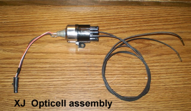

you can replace the Opticell bulb without removing the shifter surround panel, removing only the black plastic tray and the lid, then you find the removable bulb socket on the left driver's side (has 2 wires, one is red with white stripe), remove and replace the bulb and push the socket in its hole. This is best done by "feel", in the dark, so that you can see the optic lights come alive and you can also rotate the bulb socket for best illumination.

Attached Thumbnails 2 questions for an 84 xj6 vdp-01-xj-opticel-unit.jpg   2 questions for an 84 xj6 vdp-06-bulb-holder.jpg

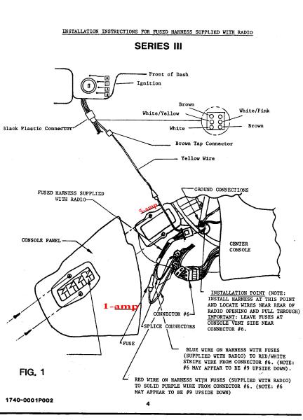

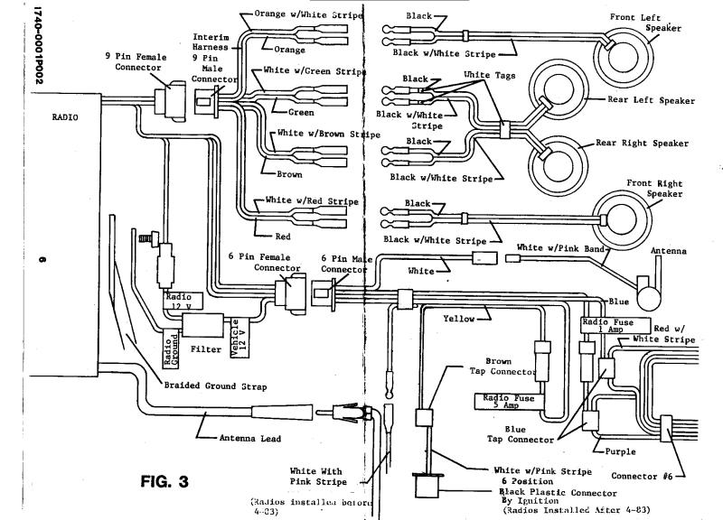

power to the radio is through the ignition switch, that's how it came from the factory.
put the ignition switch in ACC (accessory=radio), and you can listen to stoopit advertisements selling snake oil :-))

Thanks for the sheets.. The original radio that was in the car had a schematic on top of it saying that the red wire was a constant power supply.. But the new radio does not hold the stations or setting when the key is off.. Will have to look for the white and pink wire..
try this sheet:
Attached Thumbnails 2 questions for an 84 xj6 vdp-jag-radio-wiring-label.jpg
Old Sep 29, 2012 | 10:45 AM
  #35
mccain1's Avatar
Joined: Nov 2011
Posts: 31
From: Sumersworth, NH
Originally Posted by Jose
try this sheet:
That's what is on my radio. The red wire that is supposed to be constant is not. Go figure..
Old Sep 29, 2012 | 01:03 PM
  #36
Jose's Avatar
Posts: 9,142
Likes: 2,664
yes because that is a 1986 radio, not '84 or '85. However the '86 radio works fine in my 1984 but I don't remember what I did, other than I think I may have inverted the yellow and the red wires, so that yellow is constant and red is ignition 12v.
