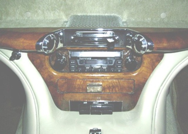

E-type, S type, XJ-6, brought together in one panel.
I went remodeling-crazy:
mounted a 1966 E-type ashtray in my XJ-6 center vertical panel where the silly plastic leaper used to be. (the plan is to eliminate the two ashtrays by the shifter, they are useless).
grafted 1964 S-type chromed knobs to XJ cigar lighter and dimmer/rheostat. (this style of knob is original to the 1963-1968 S-type and other Jaguar Saloons, used for adjusting the air vents; Jaguar reissued the same knob style in the Series 2 and 3 XJ, but in black plastic).

here's the chromed knobs in their original setting, (in my 1965 S type). They are identical to the black plastic knobs in the Series 3 XJ. The rear shafts are different, they have to be ground off and then grafted to the XJ shafts.

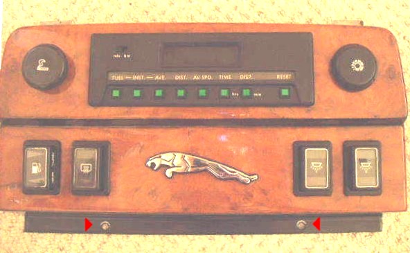

here's a picture of the "BEFORE". a bit boring if you ask me, too "spartan".

didn't have many choices, but the little plastic leaper looked so tacky, I just knew it had to go and something else needed to go in its place, like a "drawer" or compartment. Then one day I saw the E-type ashtray assembly on eBay and after confirming the measurements I had the answer. It fits perfectly, there is enough depth for the ashtray assembly behind the panel, but cutting the hole in the panel is another story, the 1/8" steel is very hard to cut, I had to drill about 70 holes, then cut between the holes, then file down, a pita.
