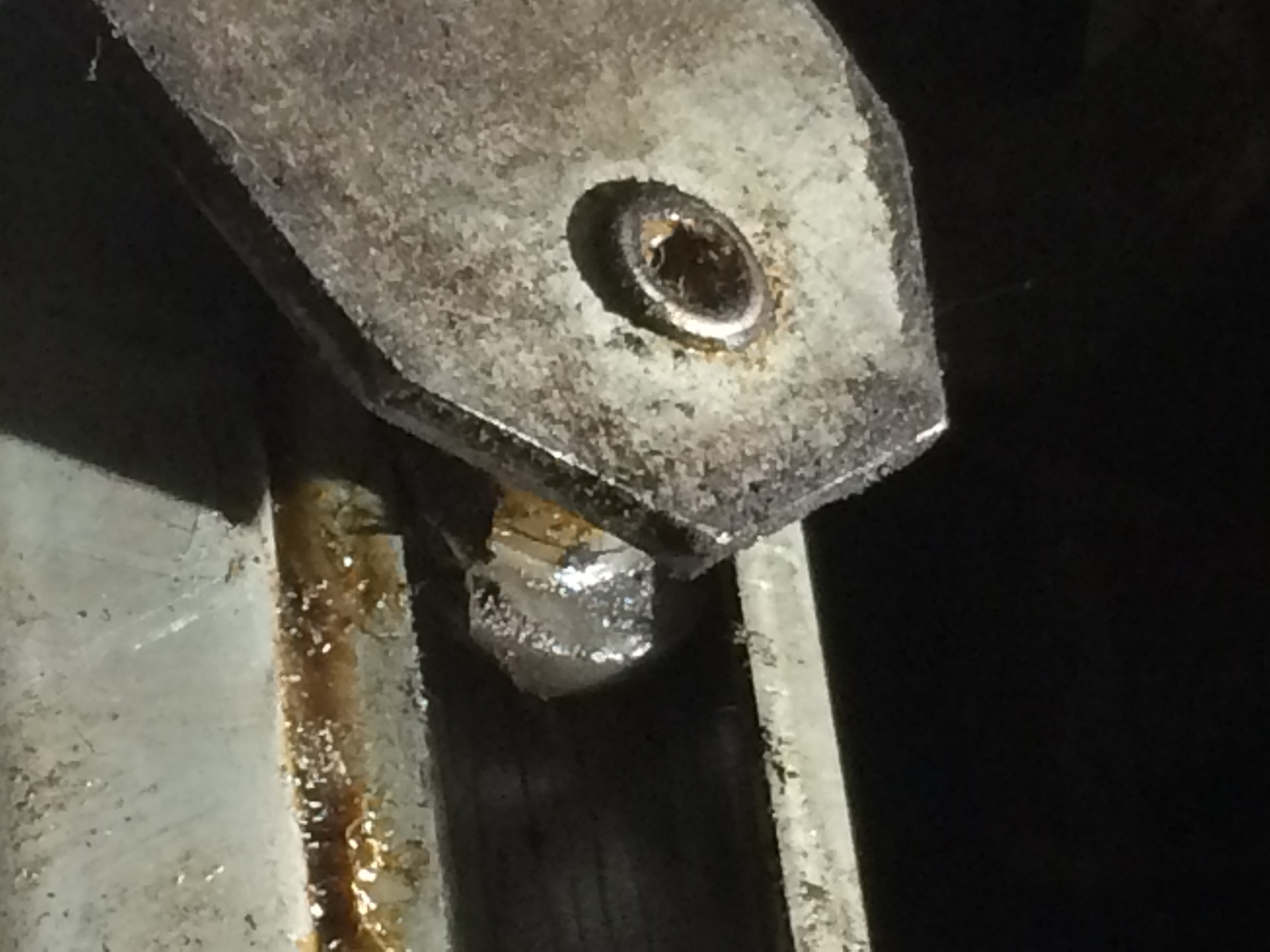

Finished changing the oil, went to put the window up, and it dropped halfway up. Pulled the door panel off and found that the roller has a small chunk out of it. Does anyone make or know of a replacement?
Thanks,
Paul

Default I used a sliding door roller on mine
Went to ACE hardware and found a sliding door roller the same size.. it bolted onto the regulator... it has been on there for years now.
