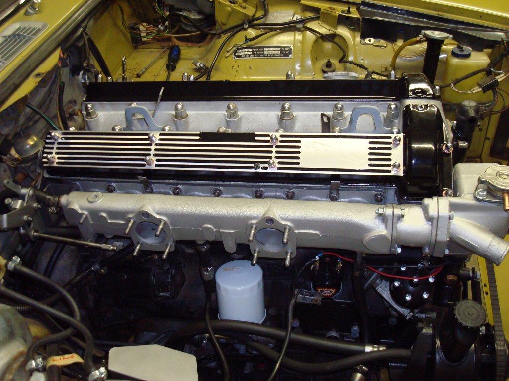

I agree with William. Dig up a set of SU HD8's with manual choke - waaaay easier to tune. You will have to plug a hole on the intake by each carb. Not sure what it was for but the Stromberg carb intake has them and the SU carb one didn't.
