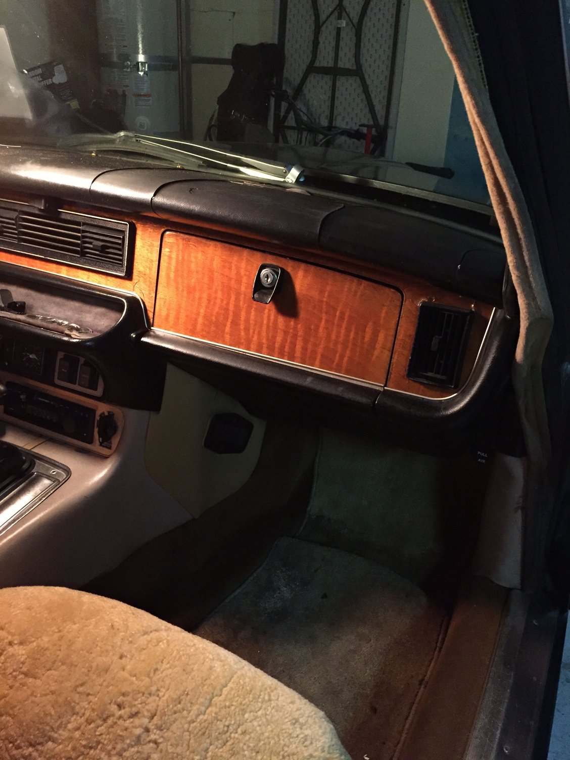

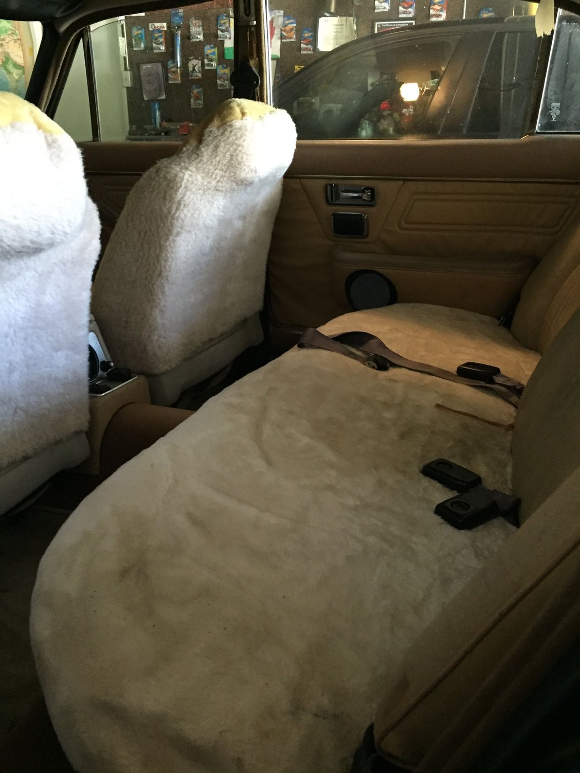

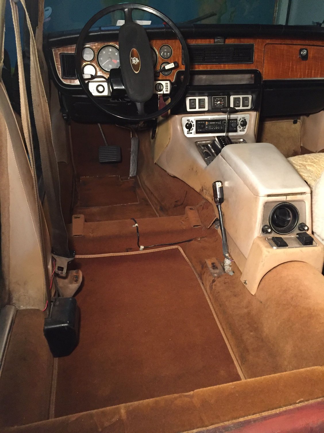

Working on the interior.
I'm afraid to look underneath these covers.

I can understand that, given the outward appearance of the exterior. But you *May* be pleasantly surprised! Or not.
To this point, your car is an Amazing transformation! Almost metamorphosis!

Go for it, remove those covers! I have a feeling that old lady was well cared for once and is hiding nice doeskin hide under those covers. What a fantastic transformation a real survivor. Well done for saving her.

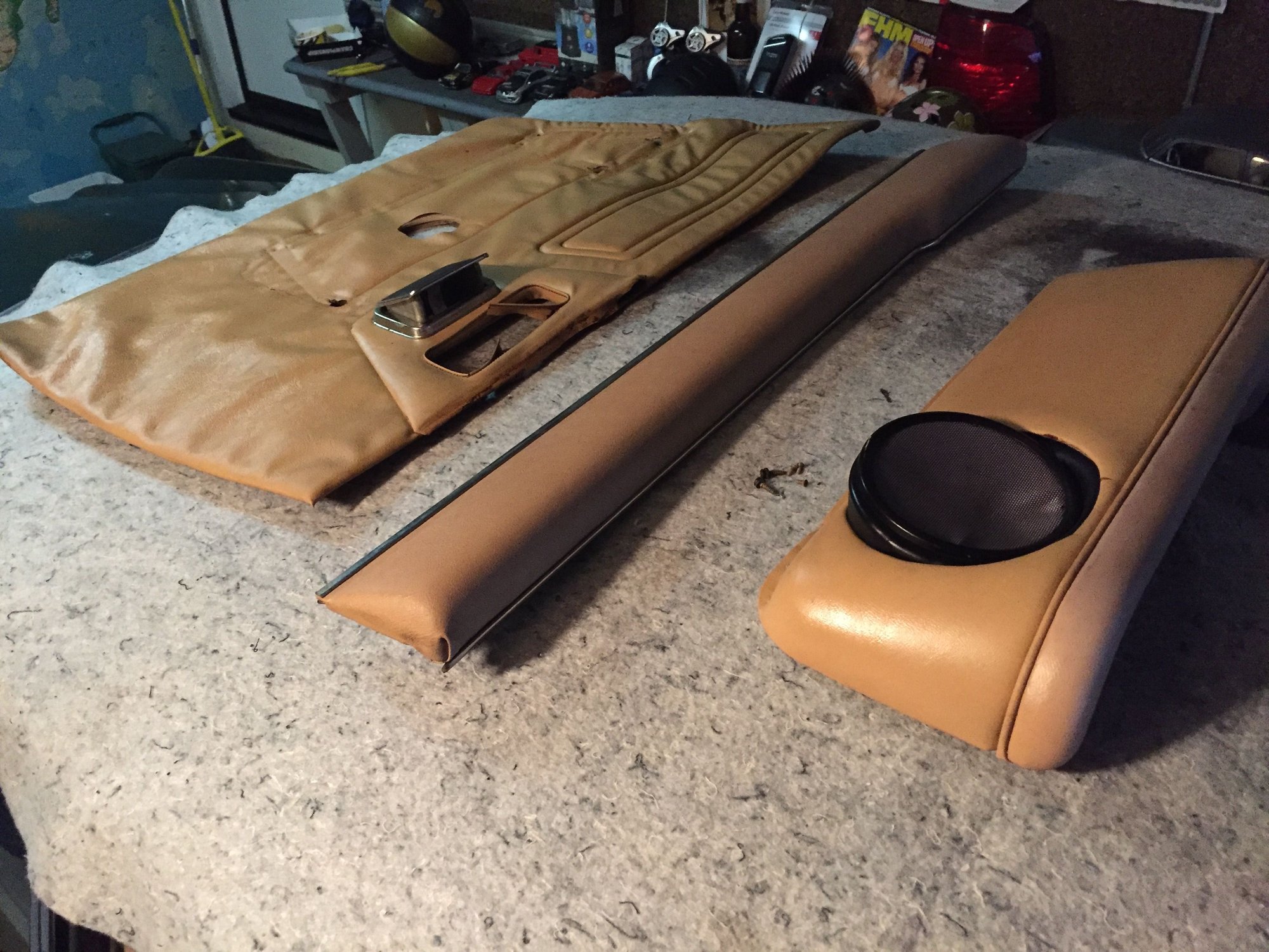

Unfortunately I haven't had a lot of time to do work on the interior but I did look underneath the driver side seat cover and it wasn't great. It seems as if the seats had been neglected a long time before it was parked. For now I'm going to keep them covered but I may have a lead on a used interior. The door cards also need a bit of work. I'll try and get some pictures up later today.

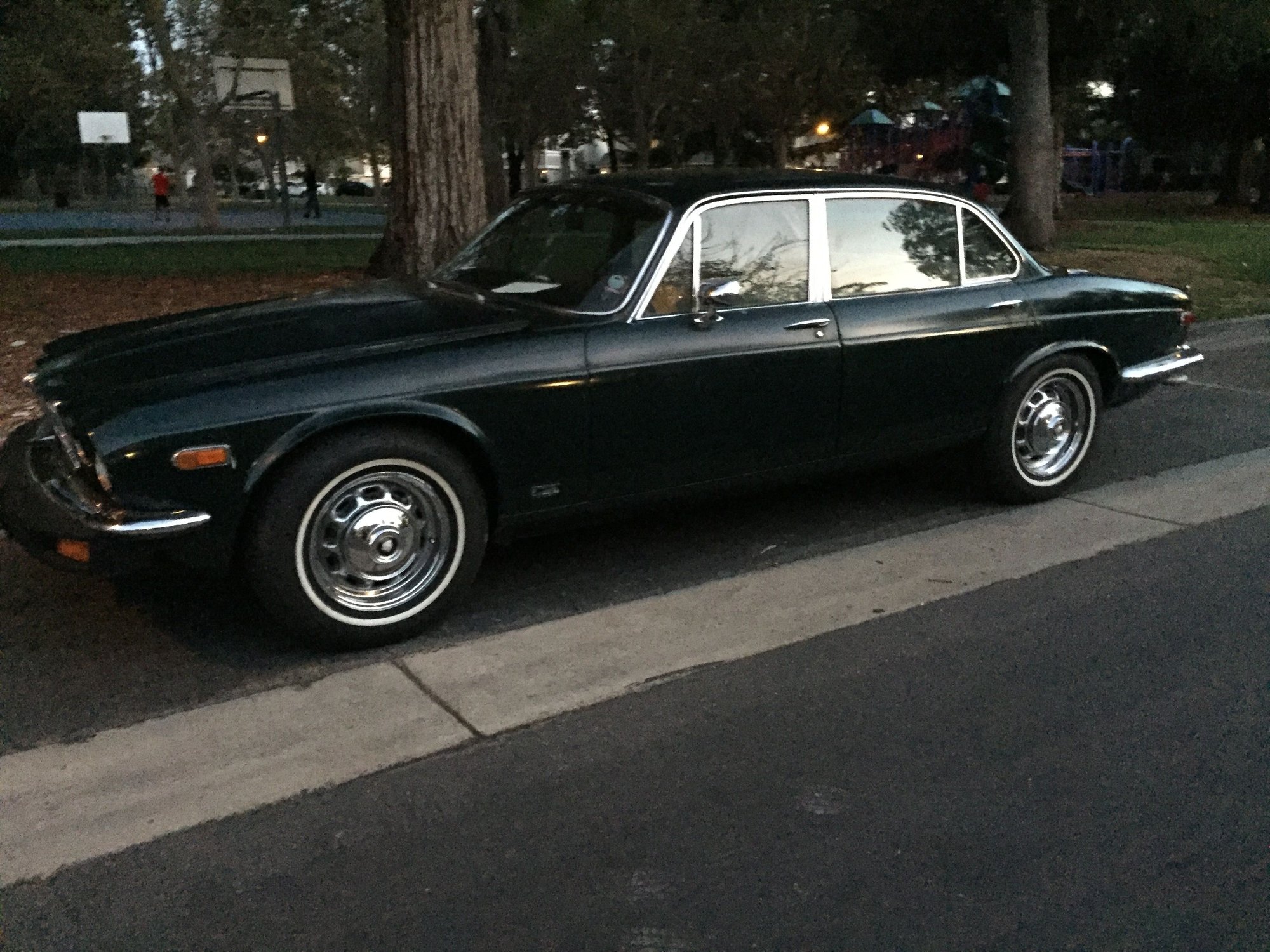

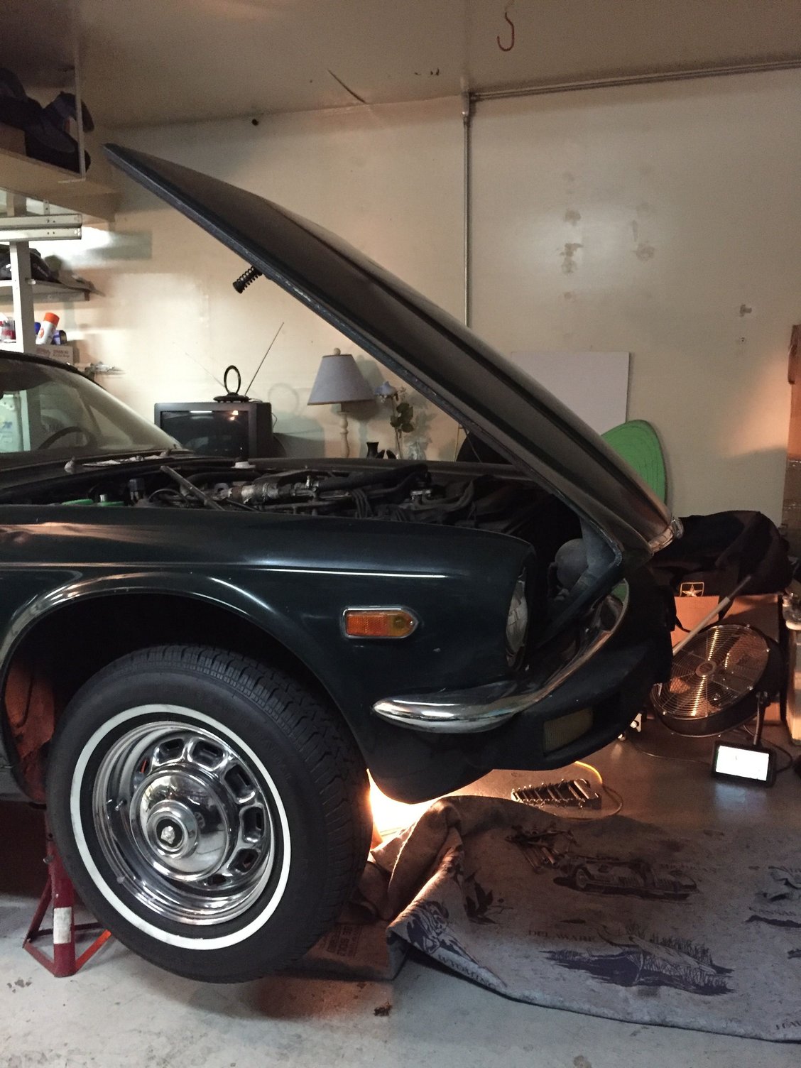

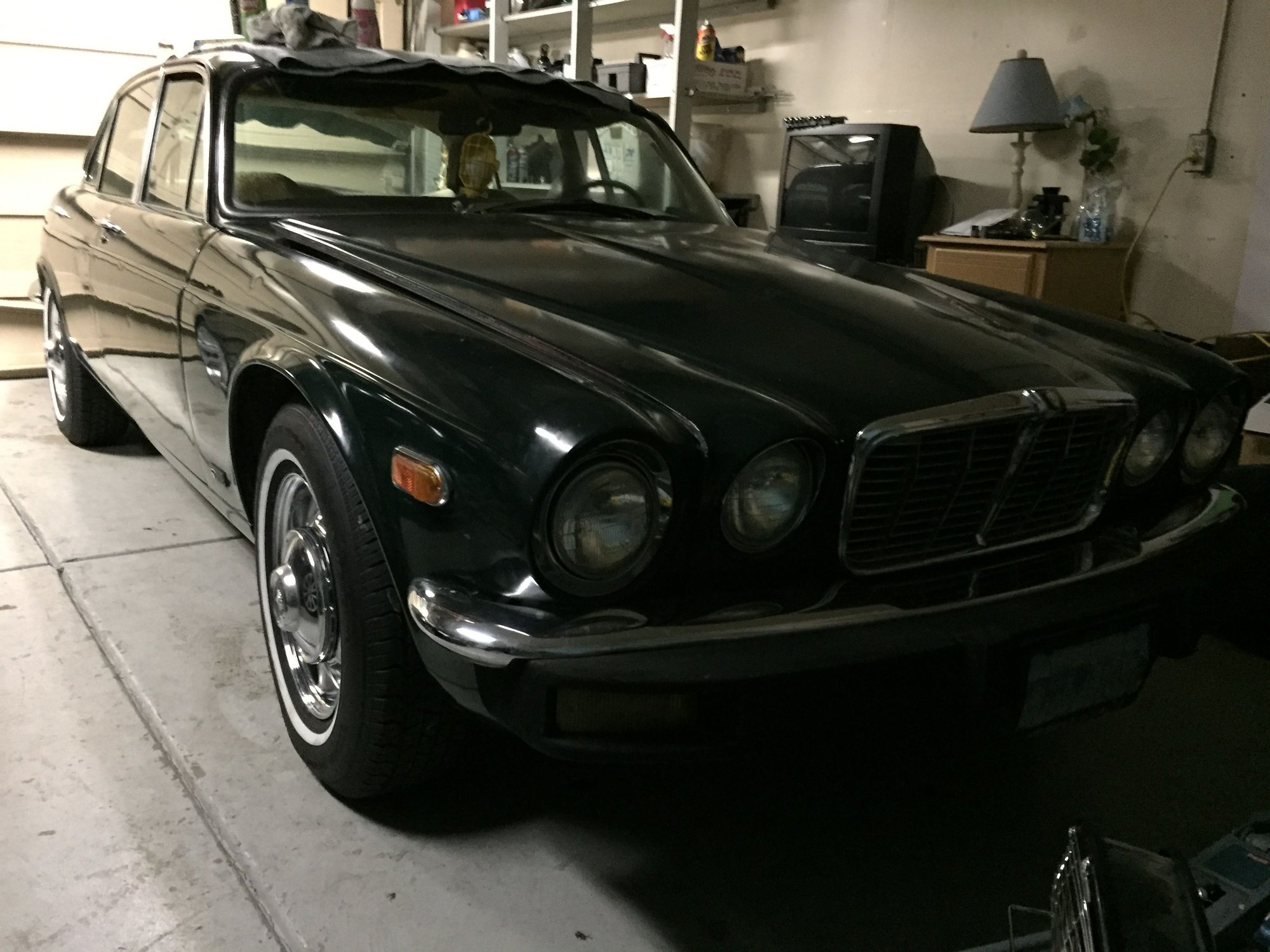

Out in its natural habitat.
Looking for a sneaky power steering leak.

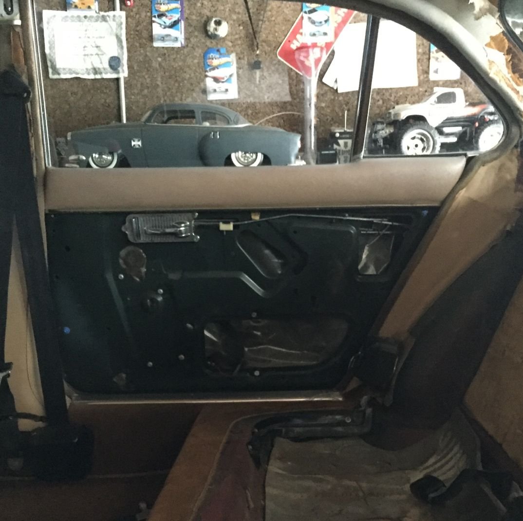

For some reason the rear doors don't want to open so I'm on the hunt to figure out why.

Decided to take the seat out to access the right side door card and vacuum a little.

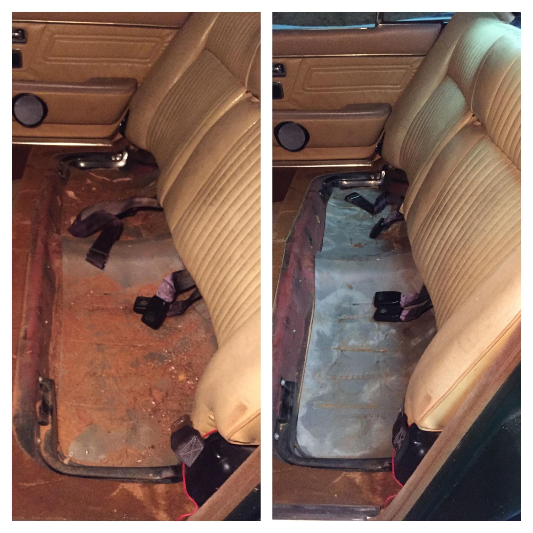

Decided to pull the seats out to possibly have them covered but I'm not sure.
What have you found under your seats? I found $.26 and a bunch of screws.

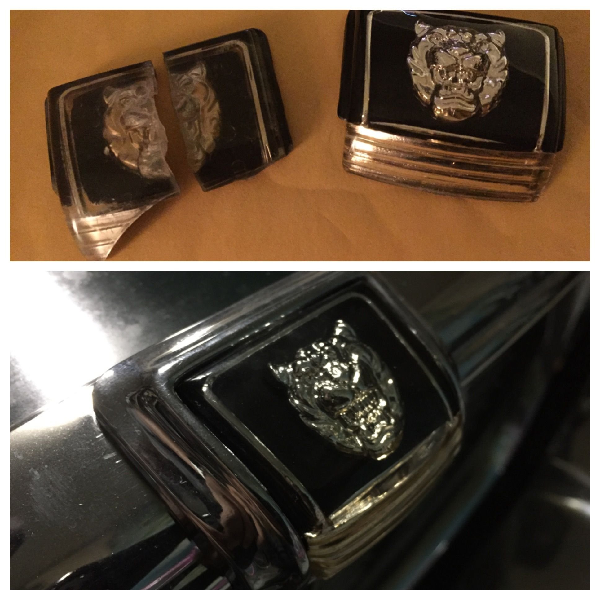

Found a reproduction emblem on eBay and couldn't be happier. Looks identical to the original.

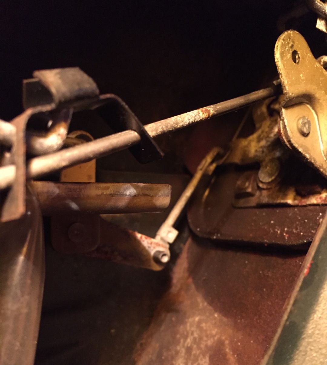

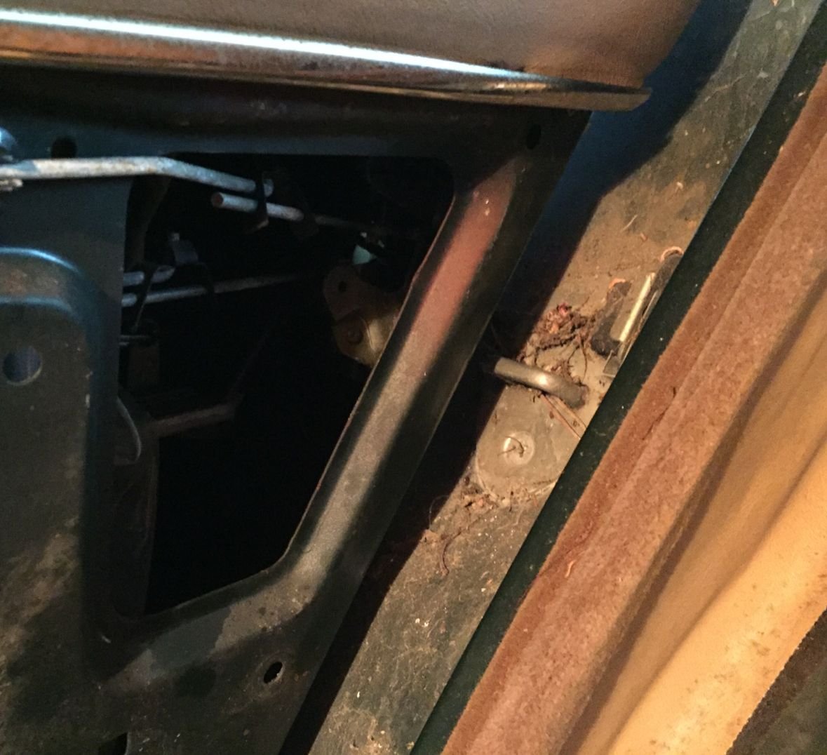

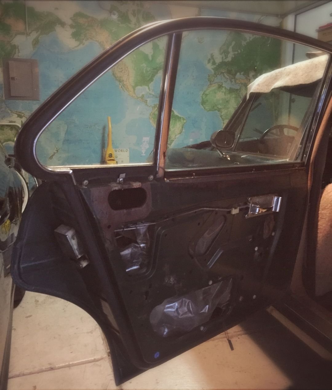

One of the reasons I took the rear seat out was to get access to the right side rear door card. The door was stuck closed and the only way to access the panel was from the inside .
After a lot of years sitting, the mechanism to manually unlock the doors was frozen. I put a little penetrating fluid on it in manually moved the mechanism around.
The rod inside the door connects to the lock unlock mechanism and the shorter rock next to the handle itself. By manually moving the inner rod for the locking mechanism and forward and pulling the handle you can open the door.
After about 15 years of being closed it actually popped open.
What it looked like from the outside.
Turns out the inner handle was also damaged so pressure applied to the unlock mechanism wasn't being transferred to the lock itself.

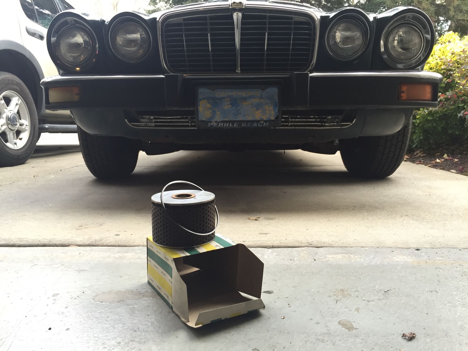

Finally stopped that pesky leak. The ring around the filter had perished.

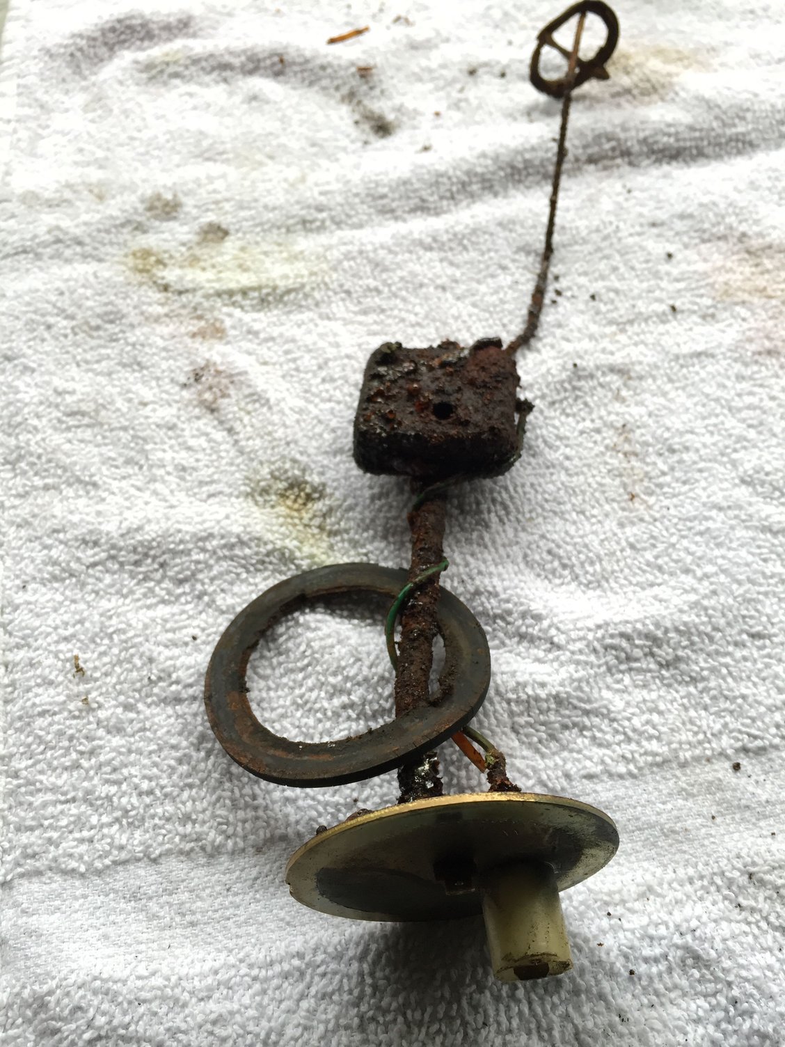

Ever wish you hadn't seen something?
At least I know why the gauge isn't working.

Ooo! Gunky!
Too late! I think you already saw it.
