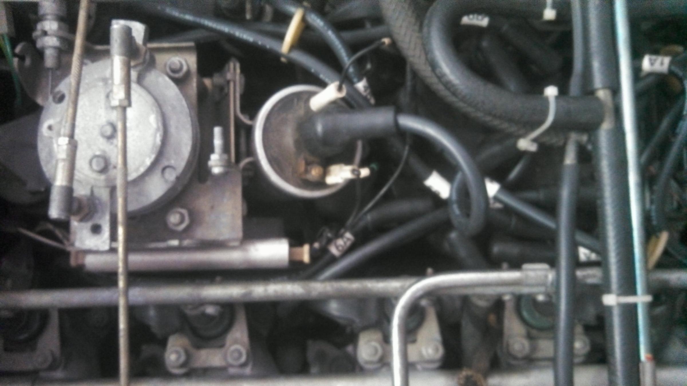

Originally Posted by ronbros
pic of my adjustable vac unit.
you put a small allen wrench into the vac hose nipple, and turn a set screw in or out that puts more or less tension on the spring,.
i had to adapt it to the jag base, with rings to clamp it together.
Is that what they look like? See pic. I beat my hands up good just getting the hose off and on to check the timing change. :-)
Thanks. I am pretty sure I only have the retard function.
Given the retard function works and the mechanical goes up to around 40, I ain't jacking with it until I get the basics nailed down. Then I may get frisky with some mods.
Today's basics are fuel that looks like mud, BTW.
Fitted a new fuel filter yesterday and after it finally started, it spun more freely and quickly that I have ever heard it. For about ten seconds. Then the same symptoms - intake backfiring and feathering of the pedal to just keep it running. It has always spun up ok but never this freely for those few seconds.
