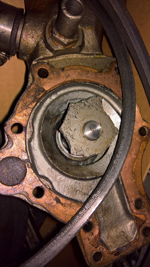

Was a water pump impeller.
Ok all, I finally got to dig into this and water seemed to flow freely through the radiator so I pulled my water pump. Pieces of the impeller fell everywhere. See the picture. Very catastrophic. I replaced the water pump a couple months ago with one from A1 Cardone through RockAuto. To their credit, it has a two year warranty and they would have replaced it for free, but I didn't want another from the same group so I sourced a different higher grade pump (AC Delco), also from RockAuto. Hopefully the new one doesn't fly apart when merging into traffic. I don't get it until April 10th, so the poor girl will have to wait until then. You'd think you would be able to hear that go, but honestly I heard nothing. Then again, you can't really hear the motor running in these things.

Looks like Jose nailed it in post #7 !
A broken impellor is something you hear about but don't actually see all that often. A good example of "never say never" !

Yep, way to go Jose. The impellor seemed fine when I installed it, but looking closely I am surprised by how thin and poor (pitted and bubbly looking) the casting is. Now working on MGs I've seen my fair share of poorly crafted metal parts, but given the first water pump lasted more than 35 years, I think I will very carefully compare this impeller with the new one when it comes in and post my findings. I wonder if some process A1 Cardone is using when the remanufacture may weaken or damage the metal. That or there was something large in my coolant line which washed in there and got caught between the impeller and the housing and caused the thing to come apart, but that seems kind of unlikely to me.

Jose sure got it right on the nose!!
I've seen seriously corroded impellers in other critters. but, never one that flat out disintegrated !!!
On the bright side, two points:
1. The engine suffered no damage.
2. The cause is clear and unamibigious (sp)?
I wonder if A1 Cardone uses used impellers or new castings?
Yup, I sure can see a lack of confidence in another from the same source.
Angst? Would the AC Delco be any better???
Water does not compress. It's hydraulic force is tremendous.
back in my insurance claims career, my employer insured a company that leased and operated a former Navy ship yard. It's main claim to fame was a huge dry dock. A huge electric driven water pump was used to empty it into SF Bay. The works was accessible via a ladder. A huge brass impeller. Issue was that debris got into the pump camber and bent the huge fins way back. Lots of $'s to "make" a new one and refit it!!! Some investigation found prior failures during Navy service and after. And changing material from which the impeller was forged. The Ship Yard relied on an experienced Marine Surveyor's opinion that debris damaged it. Covered by insurance.
My instinct said not so fast. The blades are bent back not irregularly or with pieces missing. So, I retained a forensic lab with hydraulic and mechanical engnering talent
"aboard". Force lines on the unit in situ were established from many plots to measure. A drawing was created to demonstrate them. Very analytical. In lay terms, the blades bent when turned with great force against a near solid obstacle. Many cyles til failure occurred. Elasticity over brittleness resulted in a bend rather than fracture.
In the Jag pump, the brittleness gave way....

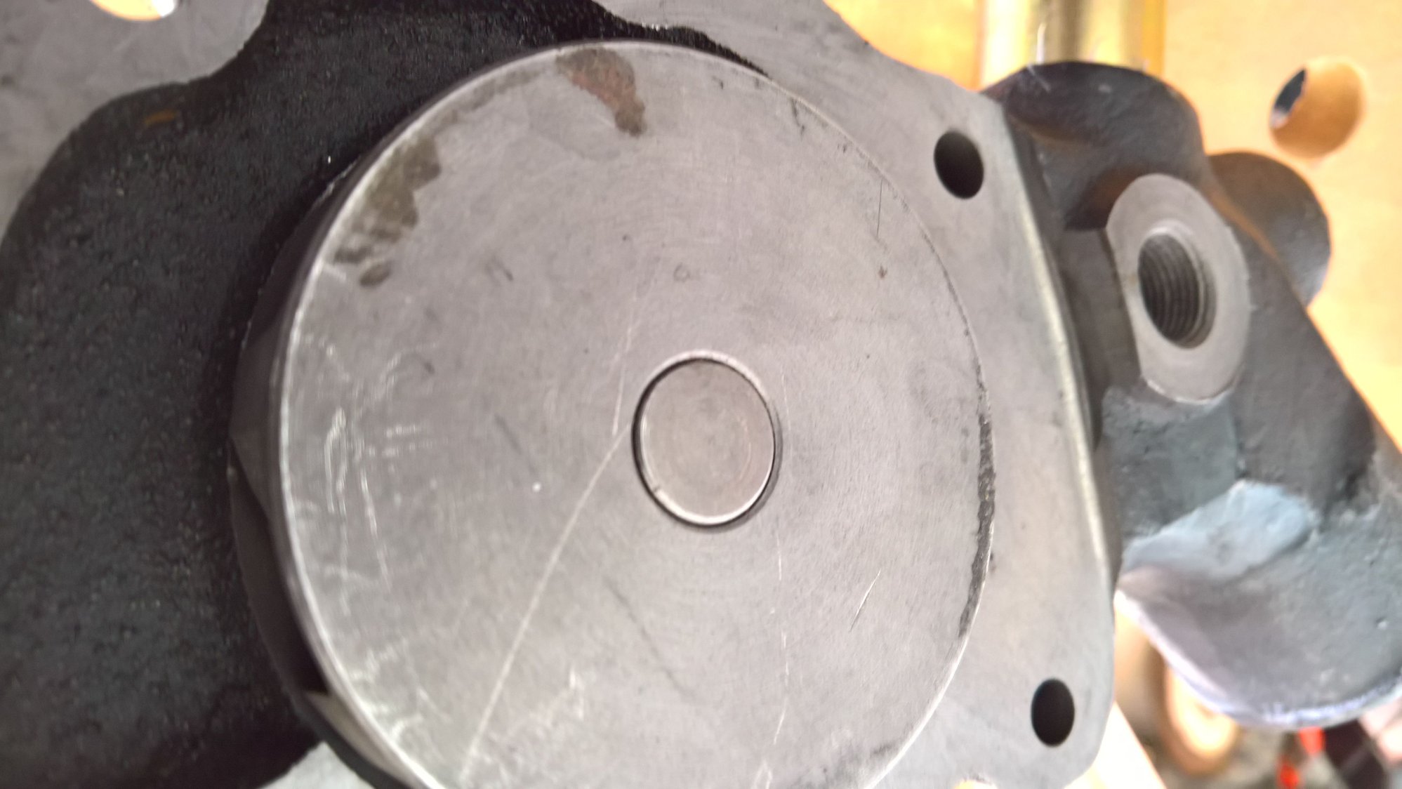

A1 Cardone Impeller
AC Delco Impeller
Ok all, I got my new water pump early. This difference is substantial and just goes to show that you can go cheap, but not too cheap. The A1 cardone impeller is considerably thinner and the casting is very poor. The AC Delco impeller comes all the way back flush with the shaft, and I don't believe that is just differences in installation, and although is machined in the back, doesn't have the same sandy/bubbly feel on the raw cast surfaces that the A1 Cardone pump does.
I installed the AC Delco water pump, but then ran out of daylight so wasn't able to finish. Hopefully I'll have it all put back together this weekend and the Jag will go back to my dailly driver monday next week. She has her work cut out for her, the main road into work is closed for bridge repairs and my drive to work is now 50 minutes each way.

ok ok, did I win anything?
I am starting to wonder if the original water pump was / is from General Motors?? These cars were built with many GM parts, examples being the Power Steering Saginaw Pump, the AC Delco Air Pump, the Harrison A/C compressor, the AC Delco Ignition Amplifier, the BW transmission, and the door electric mirrors were from American Motors.
Anyway, the GM water pump looks solid.

And, I sure do agree that the ACDelco water pump rebuild looks far more solid than the failed unit!!! An awful casting !!!
