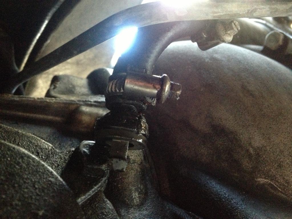

New update! Can anyone tell me what this is? I'm 75% sure it is a contributing factor if not the entire reason of my problem. It has 2 of those plastic "lock in place things" lol and one is broken off so it spins freely in the Passenger side of the trans and I was able to just pull it out.
Almost dead center attached to the hose with the hose clamp on it
Close up
Attached Thumbnails 84 xj6 will not shift out of 2nd...-image_zps37988f41.jpg   84 xj6 will not shift out of 2nd...-image_zps4dbd278b.jpg

I'm pretty sure that's the vent nipple and hose. If I'm right the hose connects to a pipe that heads upward and than comes back down alongside the starter.
If it IS the vent then just stick the nipple back into the hole. It wouldn't cause a shifting problem in and of itself. If the hole has been open long enough, though, water/dirt may have gotten into the trans. That would be a bad thing.

It was in there so nothing would have got in the hole I was just thinking because it was just sitting in there it could have been some sort of vacuum leak. I made sure to put it back in but like I said it's just sitting there with no pressure.
