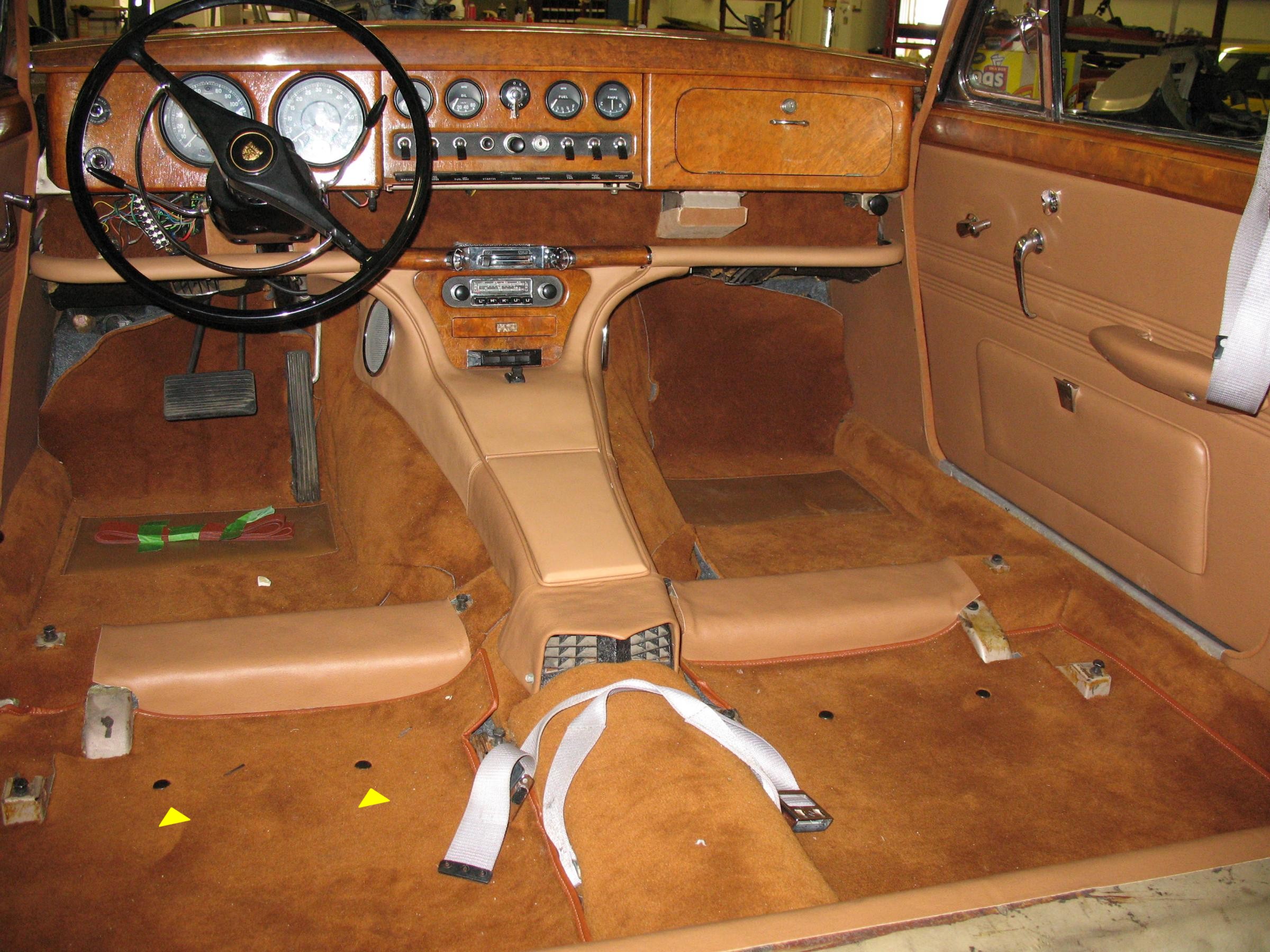

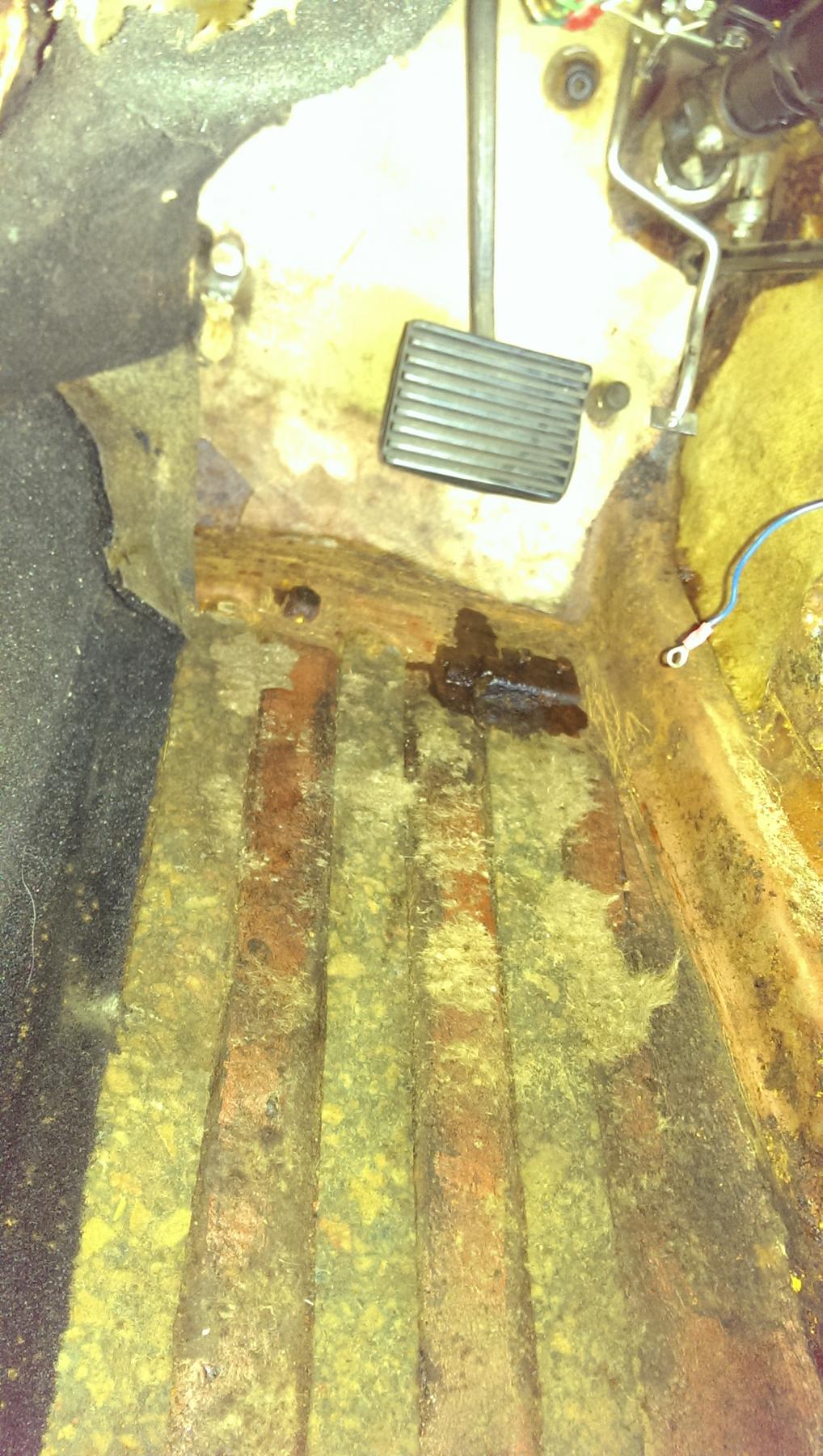

all Jaguars, classic and modern, use the same principle to hold the floor carpets in place,
the floor has welded "towers" at the rear and the front of each carpet mat. (picture 1)
each tower has a hole where the "female" part of a 2-piece rubber plug is first inserted. (picture 2)
then the carpet/mat is placed in the floor.

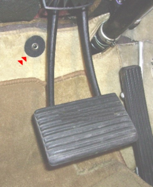

then the "male" part of the plug, (the "button"), is inserted over the mat into the "female" part of the plug. The carpet mat is "cut" with a punch at the point which the male plug goes through. (picture 3)

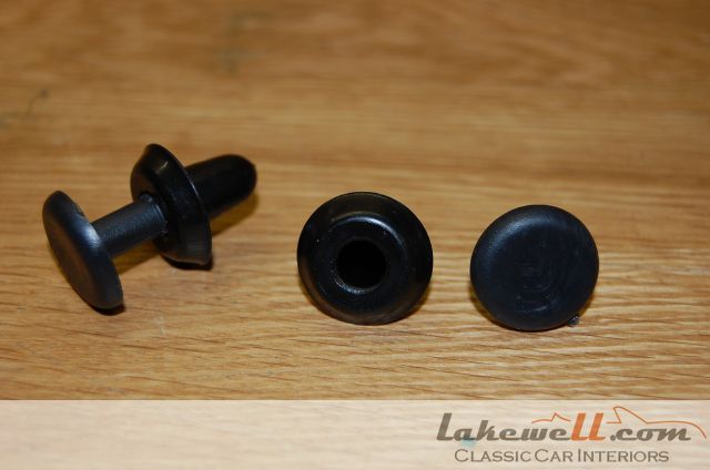

Chances are the cuts in your mats are stretched or torn, so the solution is to add a large
plastic, thin washer under the "male" plug for more grabbing power. (picture 4).
the 2-part plugs are still available. You can pull them from salvage yard cars or order new ones from the UK. (picture 2)

Just a tidbit that others might want to know. That second picture says lakewell.com. Awesome place to get upholstery, for the people here in the states, you can't get this quality in the states. real hides are unheard of here for that much. Highly recommend for anyone who needs upholstery for their autos.

Doug, all Jags use the same carpet / mat holdowns, the pictures I used are for a 1964 S type interior. My '65 S type has them too, identical welded floor "towers" and 2-piece buttons like in my '84 XJ-6.
amaezing: I tried to find them at SNG Barrat USA store but they do not show the buttons in either the "classic saloons" or the "XJ-6 Series". Lakewell's picture is the only one I found.

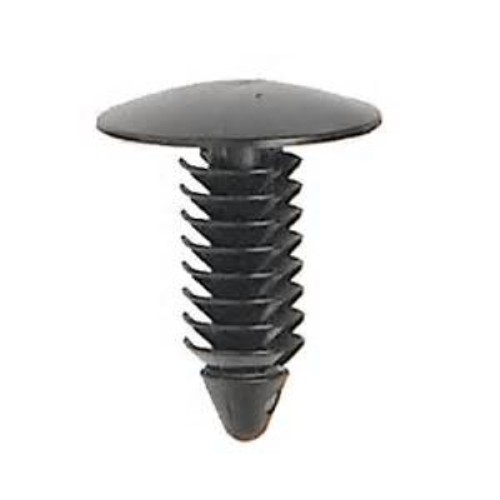

another option for carpet / mat holdown buttons is to go to any autoparts store like Autozone, Advance auto, NAPA, O'Reilly's, etc., and look for domestic car push-fasteners, although those are usually one-time use only, you can buy enough of them and keep them handy.
