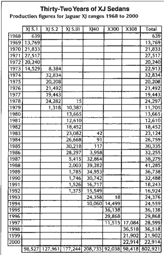

learn about the XJ-6 Series Production since 1968. The XJ-40 is un-oficially the Series 4, ad so on.
