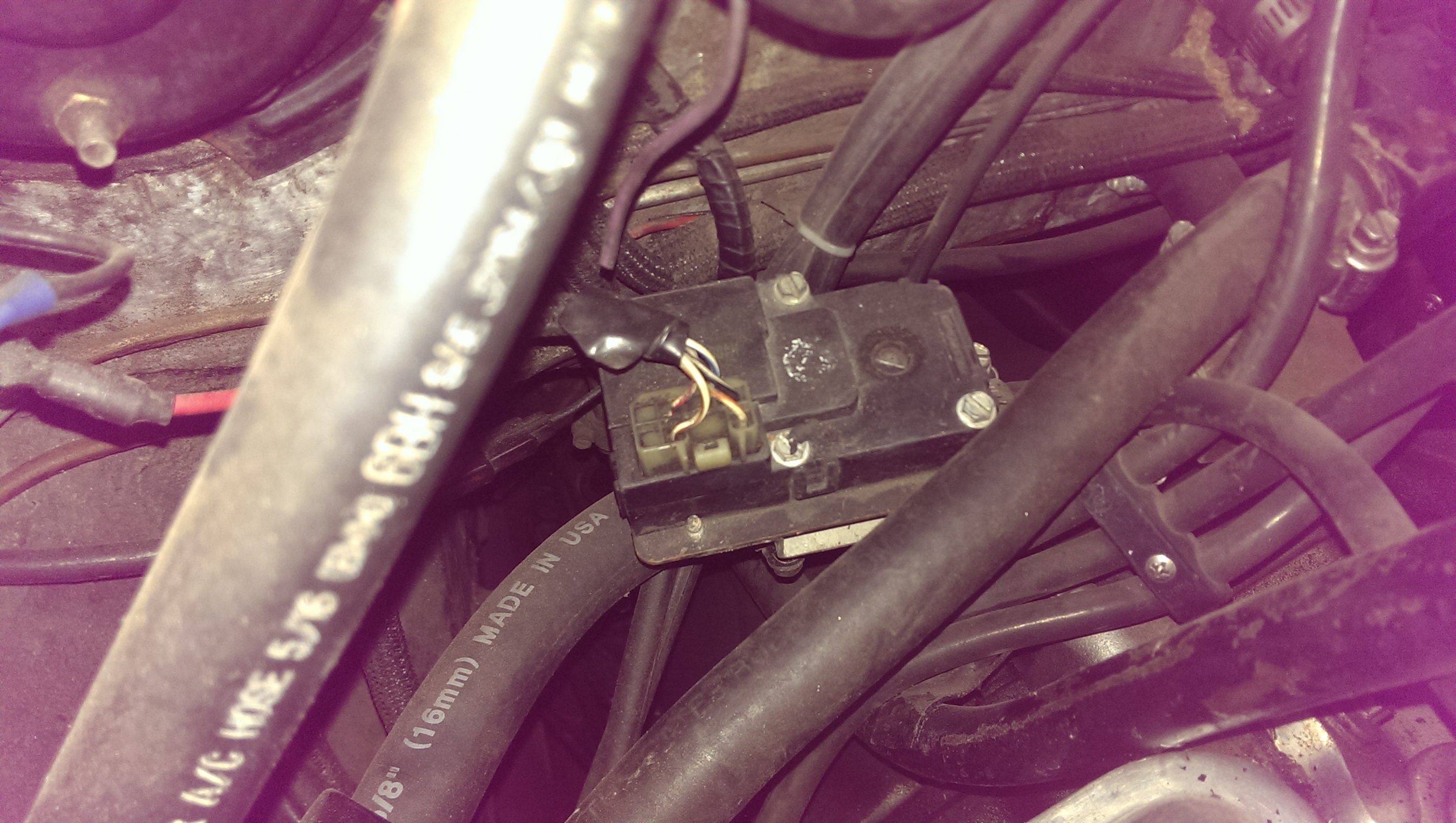

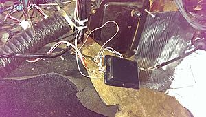

Upgrade to a VA Electronic Heater Servo... replaces the stock vacuum operated water valve with one with a small motor... works fine with GM engines or Jags.
Eliminate all future problems now...
Attached Thumbnails '88 XJS heater valve removal???-imag1802.jpg   '88 XJS heater valve removal???-imag1801.jpg
