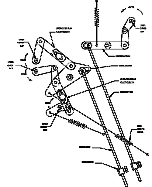

I pulled the check valve and can blow air through in one direction but not the other . Does this indicate the valve is stuck open and need attention?
Old May 26, 2014 | 04:41 PM
Jose's Avatar
Posts: 9,142
Likes: 2,664
no, it means the little valve is good. Make sure you reinstall it in the same orientation it was.
next check would be to visually check the vent flap linkages located on the passenger side, front of center console. Remove the side vent panel by unscrewing the two phillips screws on the black plastic vent grille, remove grille, pull finishing panel towards front of car, then you can see all the linkages.
with engine running, turn a/c ON and watch the linkages move up, sideways, and down to see if any of the adjusting detente/stop nuts are loose. But don't touch anything, like Doug said, "don't go there". If you see a lose link, first look for any marks where the STOP NUT may have scratched the link, that may be where it was originally.
