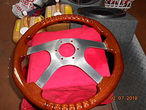

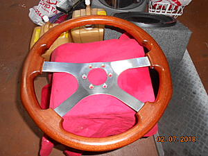

I was cleaning out a shed I have in my backyard and found this steering wheel which I did not know I even had. I can't remember where it came from. I guess it's been in the shed for more than 10 years since the box it was in said Misc/2006.
Anyway I cleaned it up and thought it might be a good idea????? to install it in my "LUMPED" Jag.
I am looking at installing it the way ALYN did his by using the center of an old series 3 steering wheel which I have already acquired.
The issue will be the horn button. The wheel looks like a Momo but upon cleaning I discovered the following. "Made in Italy by TC"
I looked at the Momo horn buttons and found out there were two sizes.
Small = 55mm and Large = 58mm.
The hole in the center of the steering wheel I have measures 2 1/4 inches = 56.11 mm.
I emailed TC racing in Tennessee and I am awaiting a response from them.
I don't even know if they are the manufacturers. I spoke to a rep from OG racing and sent him a picture of the steering wheel and he responded that the wheel is not a Momo since the bolt pattern does not match up with a Momo wheel. He referred me to the TC racing website.
In the meantime does anyone have any info re this steering wheel?
Attached are some pics of the wheel.

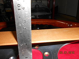

@ Jose:It only looks deep in the picture. It is two inches deep. Also most Grant wheels are either 3 or 5 bolts, not six.

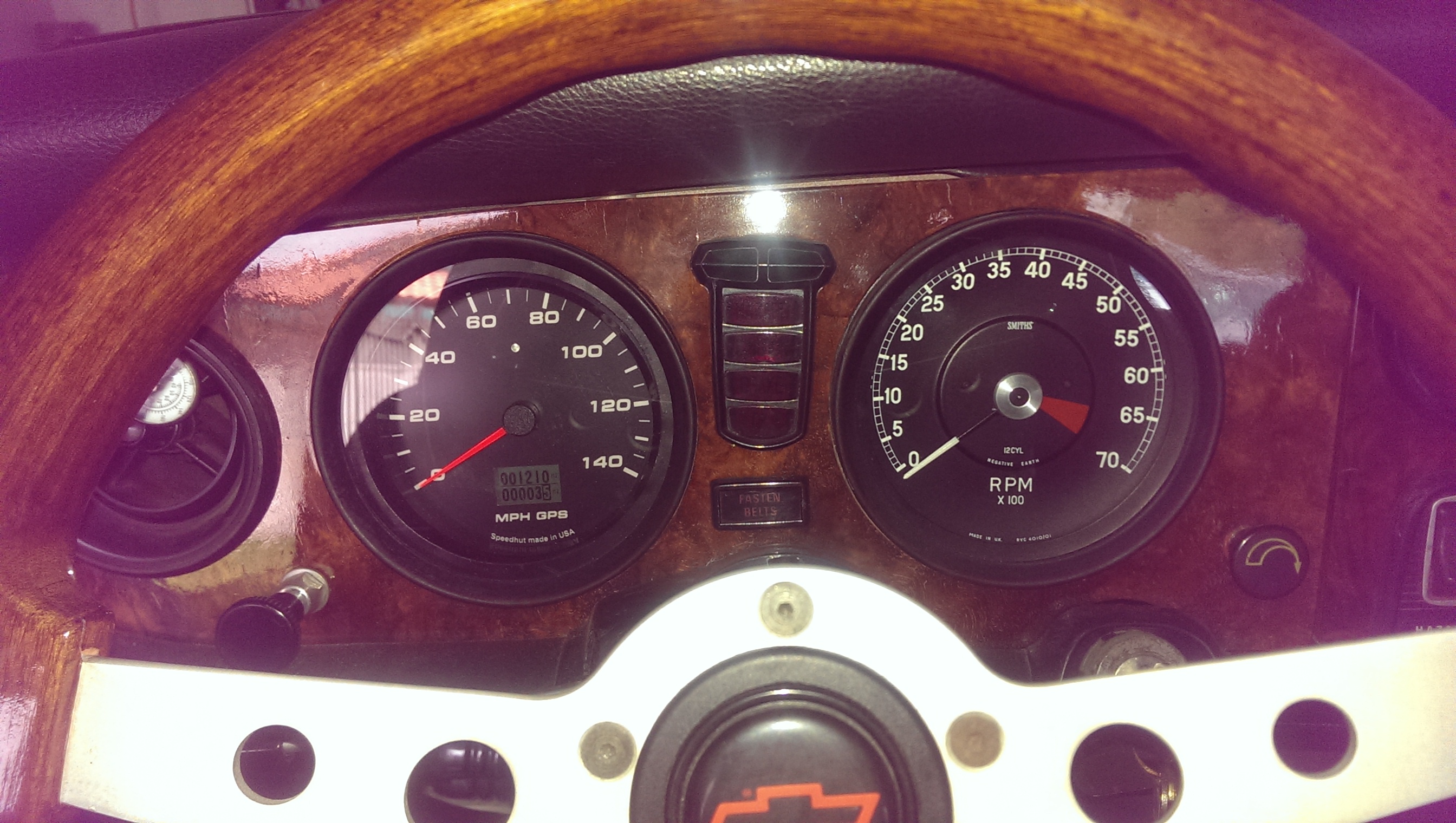

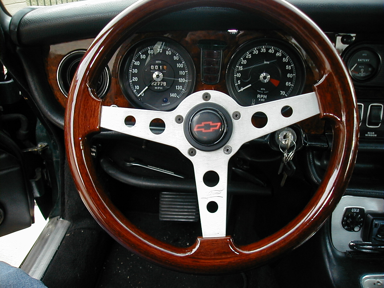

I love my Grant Signature wheel.. it is just the correct size. Someday a tilt steering column to place it downward in the exact spot...!!
Easy to install and the horn is just a wire around the center rod that clips onto the center horn button for ease of removal/install. It has their kit to make it fit.

After doing some research, my steering wheel was made in Italy by Tazio Corse. That's what the TC stands for.
If I can't get a horn button to fit--------no one is able to tell me, even though I provided them with dimensions of the center hole and bolt holes. I will have to dump the wheel and go with something else.
Bolt holes are in the 1st pic.
Center hole is 2 1/4 inches or 56.11mm.
2 inch dish.
If anyone with a Momo wheel and horn button could post the horn button dimensions, I would greatly appreciate it.

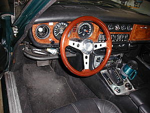

pic of my Moto-Lita wheel 9 bolts on hub, about 1-1/2" deep, hand stiched leather.
very comfortable ,feels just right for me!
