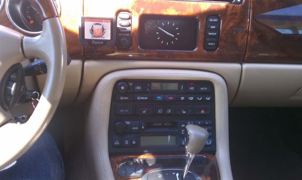

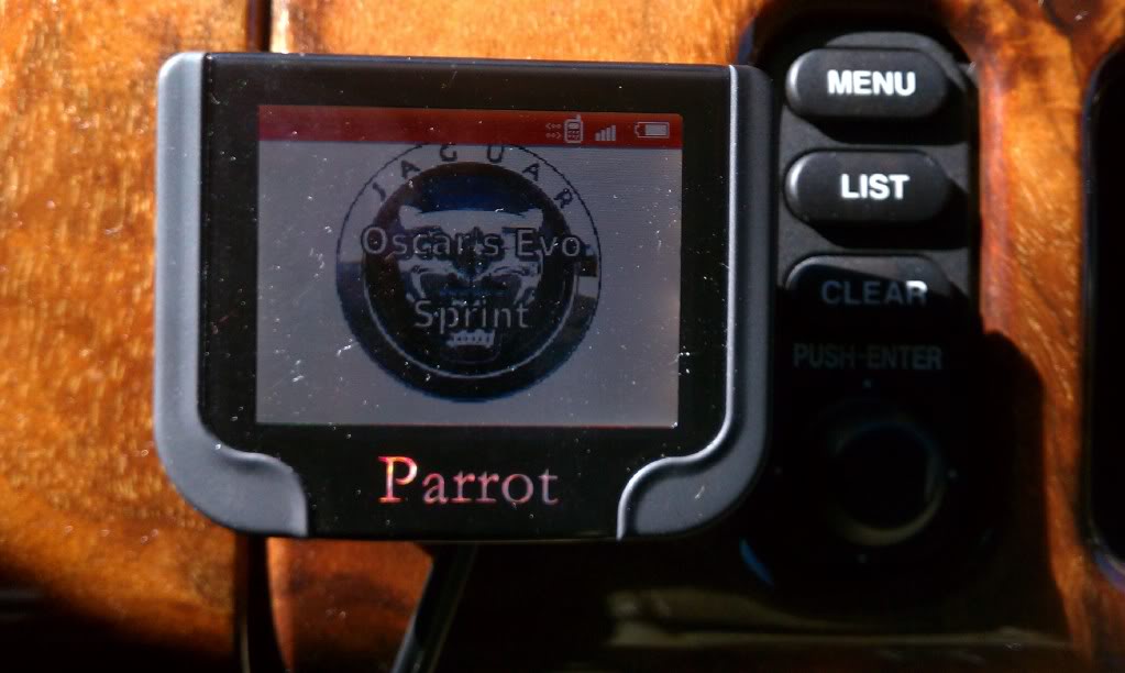

That head unit looks sleek H2Oboy! Smoggyx100 I got lucky because when I bought my XKR it had a Parrot MKi9200 (voice activated) which allows the use of USB,IPOD,SD and Bluetooth connectability without the removal of the original unit. It's awesome in my opinion. I will take some pics so you can see the setup. You can change the wallpapers to a Jag theme so it looks somewhat factory. Only problem is I can't find the wires to hook all those goodies up HAHA, so I just use bluetooth.

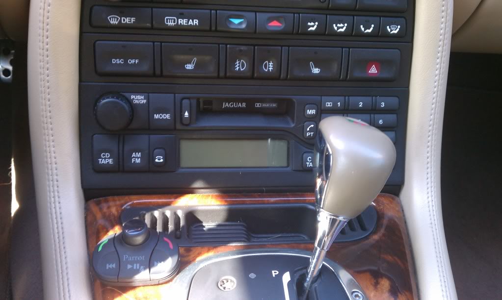

Olc101, have you looked under the center console? I installed a Parrot MKI-9200 in my daughter's 03 S-type and am glad to finally find another member who appreciates its marvelous utility! (Even if I had to depart my normal S-type and X300 haunts to find one) Great pc. of gear - blows the factory-installed BT module in the wife's S-type out of the water...dayum thing won't even stream audio! But I digress....they supply a special grommet for 3/4" hole in the center box (you have to drill it) to bring the wires through. Could be the PO of your car was skittish on hole-drilling, really just wanted BT and/or phone and just tucked 'em under the console. Or....maybe they zip-tied the cable in a small wad near the blue control module, wherever they mounted it. It will have an Apple connector, USB, and a 3.5 mm headphone jack all held together by a neat little molded-rubber cap.

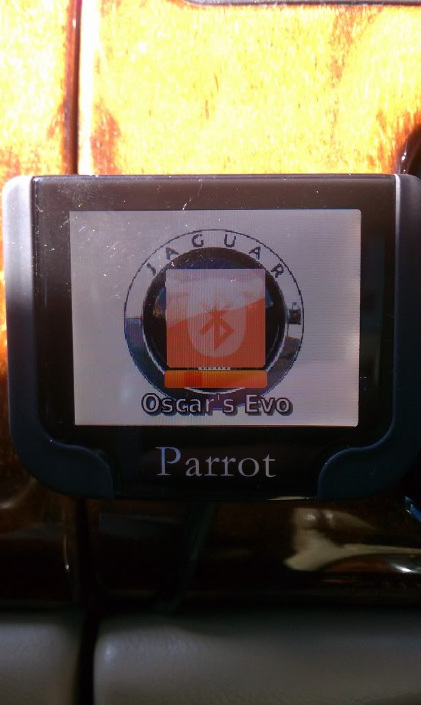

I finally got an account to upload pics. So here they are. I looked under the center console put the connections weren't there.
