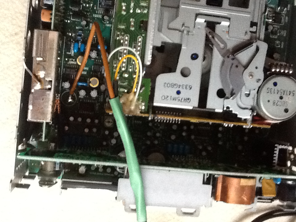

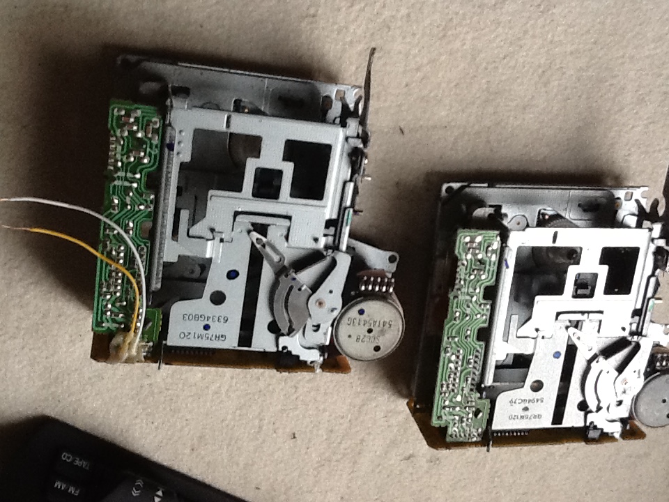

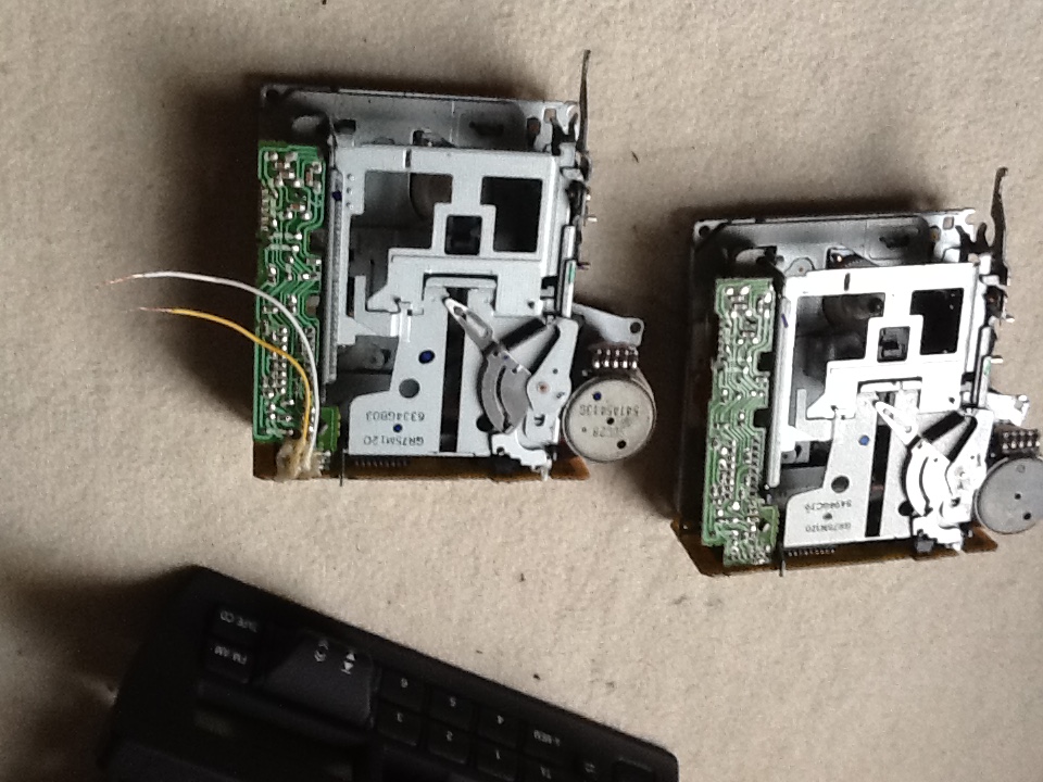

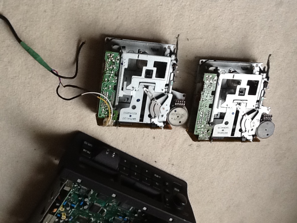

For the 1rst generation of XJ8 and XK8 radios (AJ9500) i have a (simple?)
solution for an aux-in.
You only have to open the unit and solder a cinch-cable on the tapedeck.
To find the correct points it´s better to use a magnifier,
the soldering points are marked(L-ch, S-ground, R).
For better contact i use another place for connecting/soldering the ground.
You can still use the tapedeck, for aux-in you have to insert a cassette without
a tape.
It could well be this solution works with the newer radios to.
PS: Sorry for my english,
my german is better.

It is essential to isolate the cable well, the backplate becomes very hot.
Attached Thumbnails 1999 Aftermarket ICE Upgrade with, ipod, bluetooth, facia and steering wheel controls-img_0030.jpg

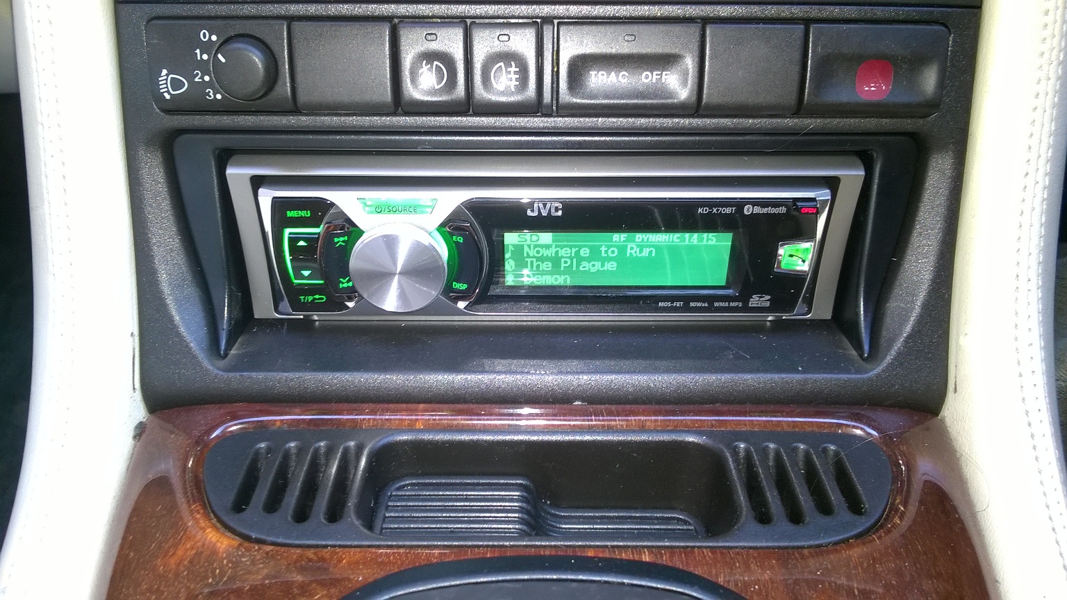

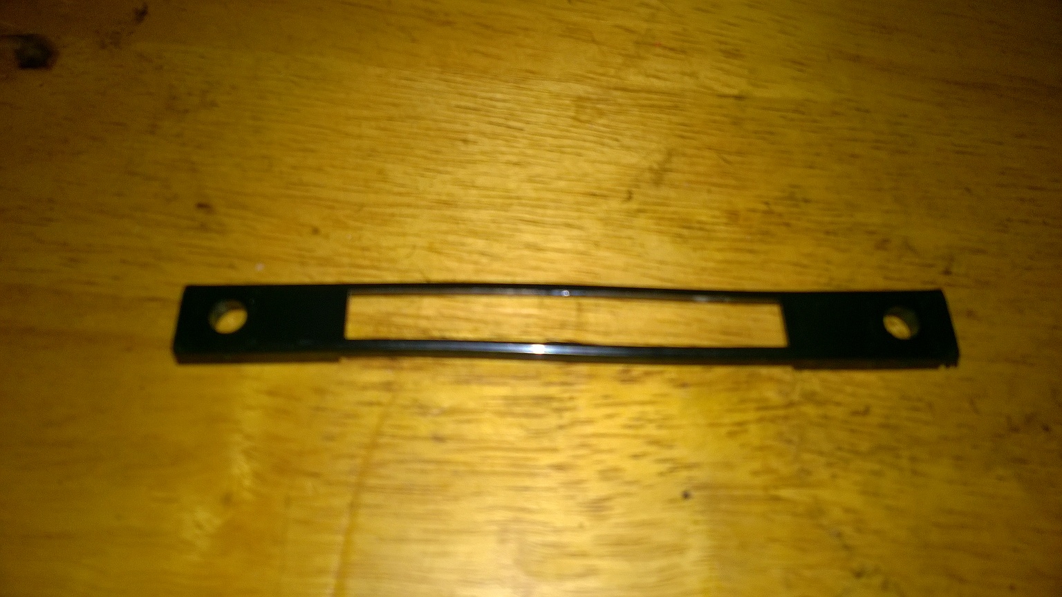

Well, thanks to this thread, I now have a spanking new stereo in the XK. It was a relatively painless install and works nicely.
I've used a JVC KD-X70BT mechless player with USB and SD capability, plus the ability to connect two phones at the same time (personal and work) so that solves my old problem of whichever phone isn't connected is the one that rings
On the downside, having put everything back together, I find I have a part left over and no idea where it came from. There's a picture of it attached in case any one else has a clue.
On top of that, the little flap that covers the cig lighter is now refusing to open, I wonder if the extra bit has any impact on that, or have I just messed up on reassembly?
1999 Aftermarket ICE Upgrade with, ipod, bluetooth, facia and steering wheel controls-stereo.jpg1999 Aftermarket ICE Upgrade with, ipod, bluetooth, facia and steering wheel controls-missing_link.jpg

I think that part goes under the armrest latch.
If the little door doesn't open, there is a wire getting in the way. Just pull the little tray from the inside of the armrest and you can move stuff/writes out of the way.
Good luck!
