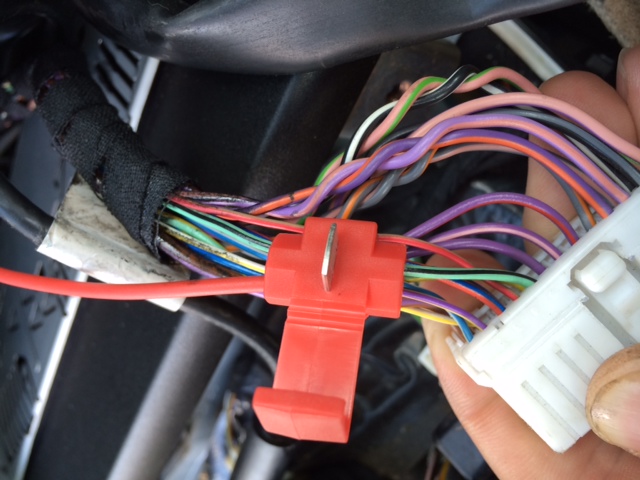

Just wanted to update all that follow this thread and put all the info i pulled together in one place.
I decided Like so many others that I wanted to change the radio in my XKR to something more modern, i.e. Bluetooth connectivity etc. My wife's old Alpine CDE-104BTi with Bluetooth and Ipod controls fitted the bill, and it was free.
Before you start this, unlike me, take out your CD's from your CD player in the boot!!
Things to by, which do appear on earlier pages..
Cable Harness/ Adapter CTSJG001.2 Jaguar XJ Steering Control Interface Nexxia UK £25
Steering Control Adapter/ Connects2 Alpine Patch Lead £3.50
Facia Adapter FP-14-00 FP-14-00 Jaguar XJ Facia adaptor online at Nexxia UK £25
Earlier Central Console Switch Cover Moulding Part No LJA6318AB £35 from Jaguar
Antenna Lead adapter PC5-28, ISO to Din Antenna Adapter Cable PC5-28 £2.46
30 pin to lightning adapter £30
I also wanted to control when the Antenna went up so also got
Snap-in Miniature Round Rocker Switch Black, from Maplins £2.49
I also removed the Phone kit that came with the car and replaced with a larger 2nd hand Chubby hole off ebay.
After reviewing you tube clips on how to remove the centre console I made a start.
The console came out quite quickly, the radio/heating control's etc took a bit longer, just take your time and don't drop any screws.

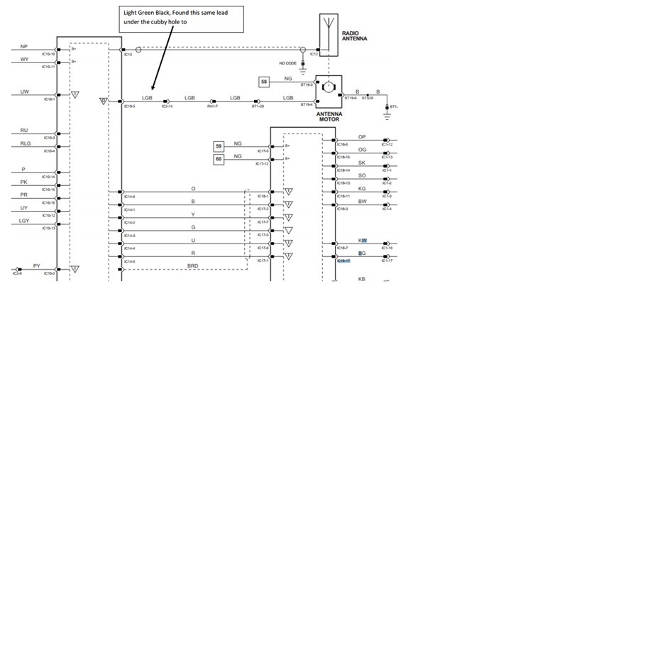

The Cable Harness/ Adapter CTSJG001.2 does NOT come with a cable to power the antenna. It had a lead from the radio, blue, but nothing from the first connector to the Jag wiring loom!!
As it did not just work and I would need to do some additional work I decided I would fit a switch so that I could control when the antenna went up and down.
The original radio connector (IC-10) on the Jag Loom had a Light Green/Black wire, pin position 5. This is the wire that powers the antenna.
I cut into this and wired to the mini switch, the other side of the mini switch I connected to the blue wire off the Cable Harness/ Adapter CTSJG001.2.
I mounted the switch to the right of the J gate.
The radio came with an Iphone connector cable, of course an Iphone connector cable for an Iphone 4 not 5!!, so needed a 30 pin to lightning adapter. Ran this cable to then new Chubby hole, under the centre console.
Turned it all on and it worked!! Then came the task of putting the console back, making it look good and squeezing the cables and radio in a very small hole. Be aware the Jag wiring loom is covered with black webbing that gets everywhere if you unlucky. Gloves are essential to stop you spreading it.
All finished now, will try and add some pictures.
oh one more thing, the steering wheel control works fine with the radio changing volume and station etc but does not answer the phone when it rings I still have to press the phone symbol on the radio.
Attached Thumbnails 1999 Aftermarket ICE Upgrade with, ipod, bluetooth, facia and steering wheel controls-wiring.jpg   1999 Aftermarket ICE Upgrade with, ipod, bluetooth, facia and steering wheel controls-switch-wiring.jpg   1999 Aftermarket ICE Upgrade with, ipod, bluetooth, facia and steering wheel controls-console-missing.jpg   1999 Aftermarket ICE Upgrade with, ipod, bluetooth, facia and steering wheel controls-antenna-connection.jpg   1999 Aftermarket ICE Upgrade with, ipod, bluetooth, facia and steering wheel controls-finished.jpg
