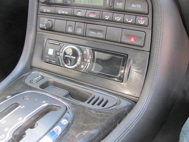

I make my own fascias as below and use Autoleads PC99-X10 for the stalk controls, if you have an Alpine amp you will not get it to work with any other head unit but if you have a Harman Kardon you can.
Not the best pic in the world but you get the idea

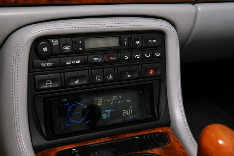

phil, you shoudn't need anything else but the 94-97 xj6 fascia, and that adapter you mentioned. The single-din radio just drops in. Your accessory buttons go right into the xj6 fascia like your original one did.
Attached Thumbnails 1999 Aftermarket ICE Upgrade with, ipod, bluetooth, facia and steering wheel controls-p189278163-4.jpg
