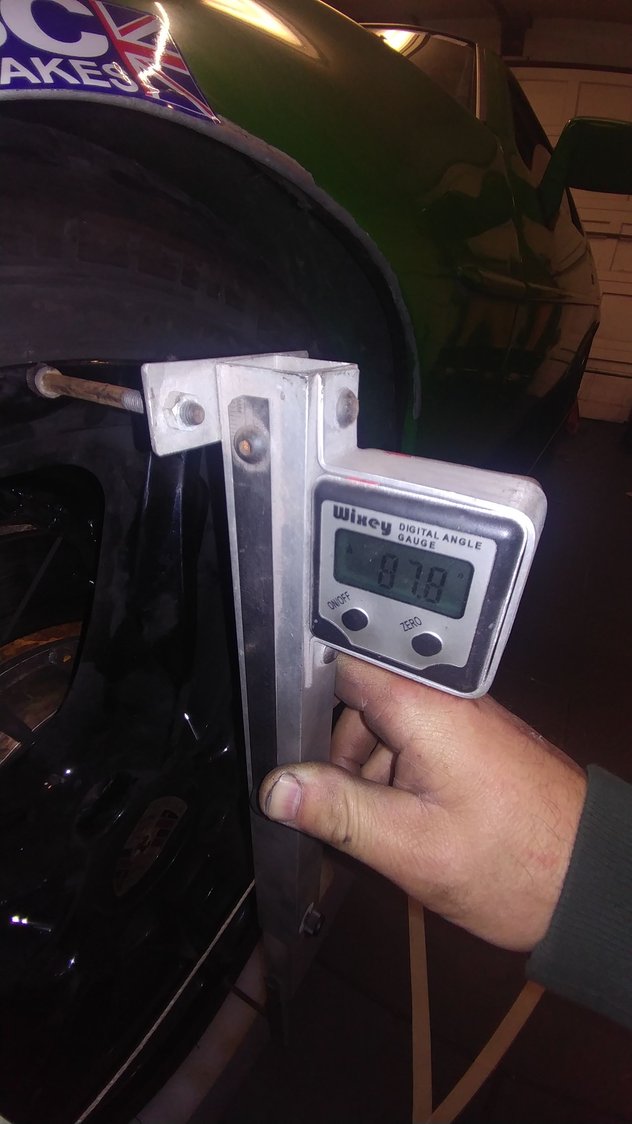

Camber... Just point the wheels ahead and measure. Then index the gauge to zero on the floor. Then measure on the wheel, the result minus 90 is your camber. As shown below -2.2 degrees.

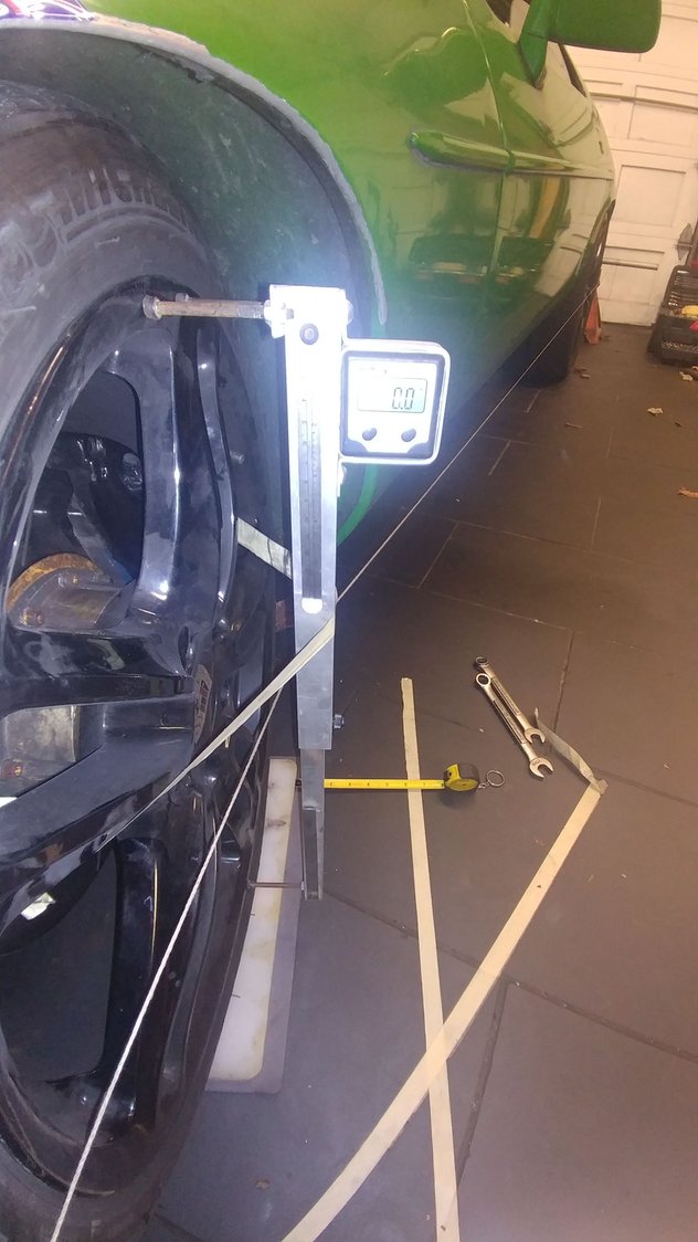

Caster... hardest to measure but easier if you know how.
1. Make a X on the floor in tape at 40 degrees, 20 in each direction.
2. Swing wheel in 20 degrees 1 direction. attach gauge and set to Zero.
3. Swing wheel in the other direction and the result is you caster. 3.4 degrees in my case, I was shooting for 3.5. Good enough.
No fancy tools or lasers. Just a simple camber gauge, masking tape, angle guide, and a tape measure.
