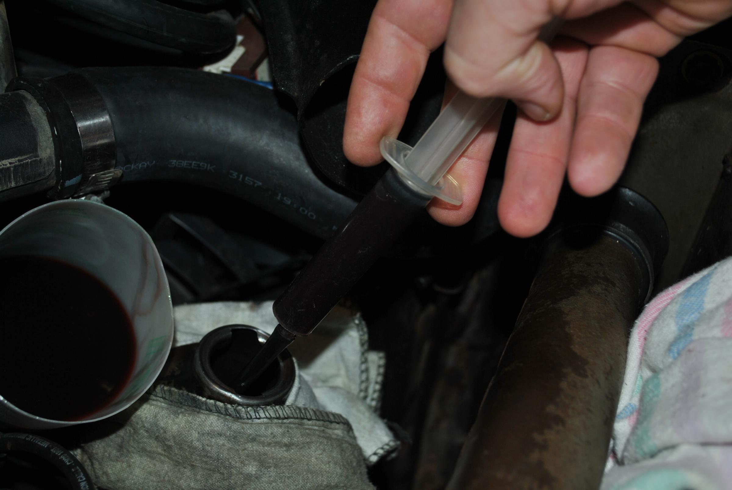

seems better so far
Grant ,I drained and refilled 4 times as you suggested. The first drain was black,the 4th was slightly brown. Steering is altogether quiter and feels lighter,but that might be my imagination.

Grant, I flushed the system twice more this morning. It seems to be quiet and vibration free so far, the last two days I have covered about 300 km in city driving and have not heard one complaint from the pump.

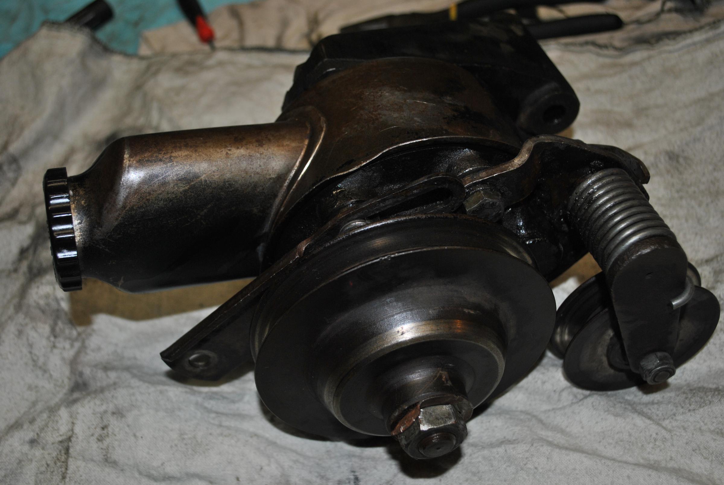

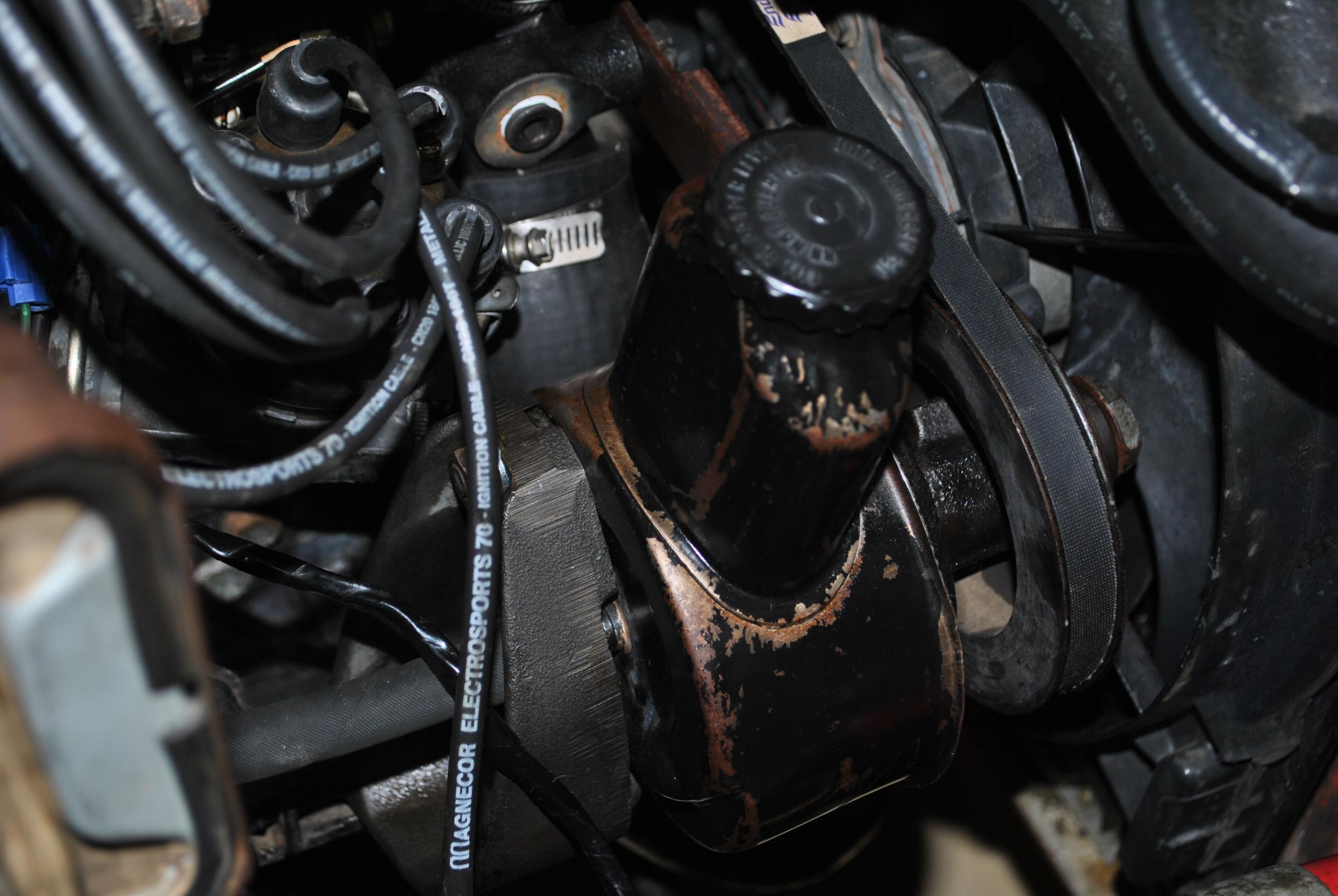

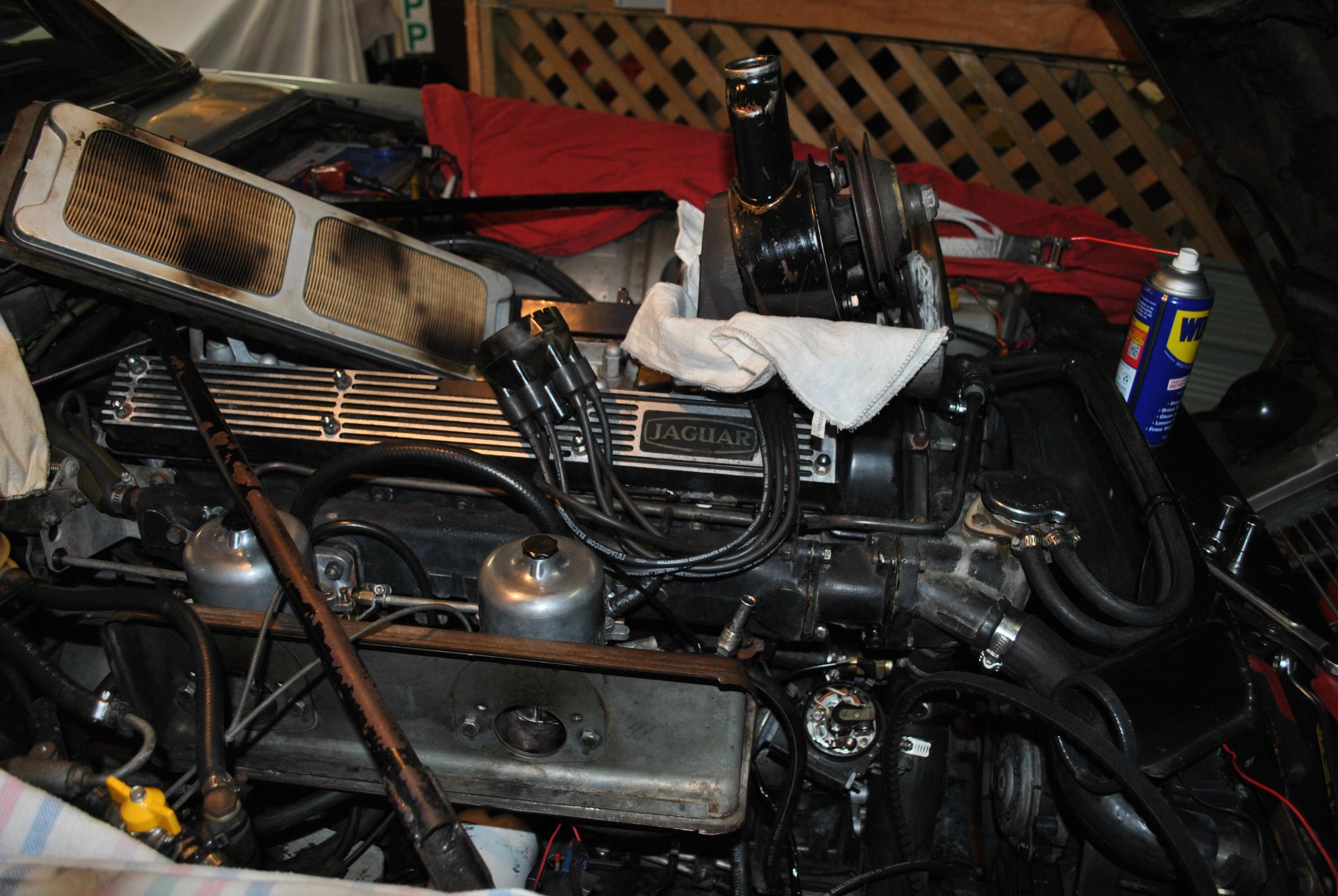

Remove power steering pump
Since I disturbed the PS pump two weeks ago the replace water pump and belts,it has been losing about 100 ml of fluid a week,and the groan when turning left had reappeared.
I assumed I had cracked a 40 year old hose when moving the pump,but after putting car up on stands I can see no fluid anywhere near the hoses and they are fairly new. There is fluid dripping off bottom of pump cover and the lower radiator hose below it so I removed the pump for a closer look(glad it's not a V12 after seeing the work space under Paul's bonnet yesterday,I can almost slide down beside my engine to work on it).
Ordered a new seal kit this morning from Repco,$15. They delivered it at 3.30 pm. They do three runs a day to local garages to deliver parts and I am on the route so I get home delivery as a bonus.(pays to use the same shop for 20 + years)

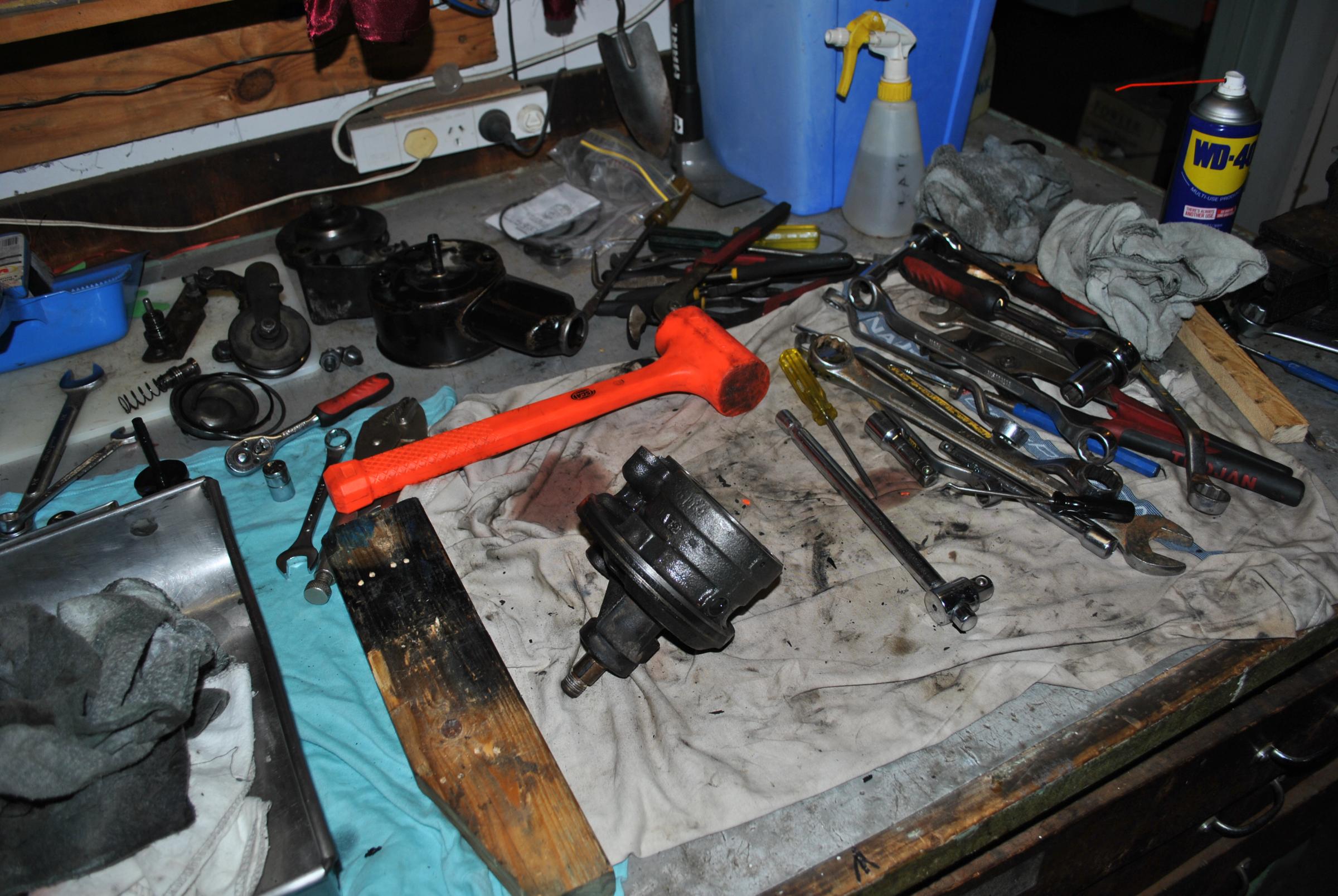

The book says undo nut and remove pulley, well that part took me an hour. My vice wasn't big enough to hold the pulley,after much swearing and hitting my fingers with a mallet I ended up wedging the pulley in a wooden draw under my workbench and pushing it shut with my knees while hammering the nut until it relinquished it grip.
Used a lot of tools for a small job,nearly every nut and bolt for this job is a different size.

I didn't really think of the pump being a miniature hydraulic pump, but once I got it apart the internals were very familiar to me. While it is out I replaced the bearing on the tensioner pulley,old one was ok but I replaced bearing anyway.
The flow control valve was a bit burred so cleaned that up and it moves freely now. All back together now and ready to go back on the car.
The local Lucas distributor paid to replace pump and lines without argument other than sending in the invoice.
