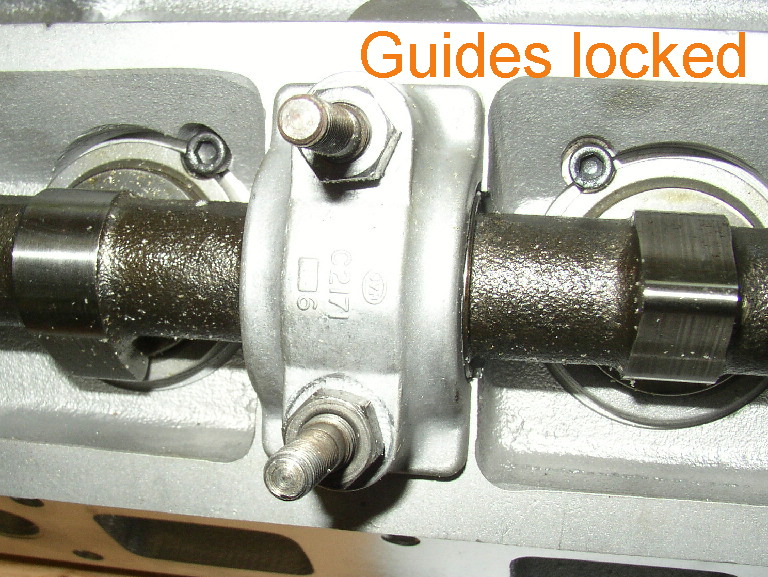

Forgot to mention, you may have the problem of the tappet guides coming loose, which caused the gouging and noise. If you search for "tappet guide stakedown kit" you will find more info.
Here is a link about it:
http://www.jag-lovers.org/xjlovers/x...akedownkit.htm
A photo showing a stakedown kit (the allen head bolt simply keeps the tappet guide held down), this kit was installed by Coventry West and supplied on a replacement cylinder head:
This is Alex Cannara's photo. He replaced the head after having a tappet guide come loose and cause catastrophic damage.
The thread about his experience is linked below, and may be helpful to read through:
http://forums.jag-lovers.org/av.php?1158276j01
