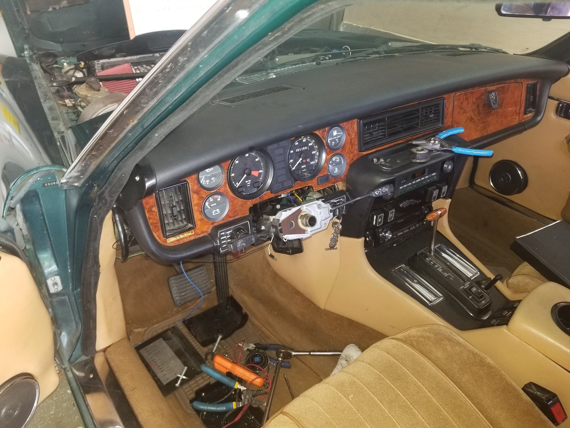

Anyone have their steering column opened up??
Trying to figure out the cruise control on my lump, gm takes all the 12 volt signals whereas the jag uses grounds for the circuits, i have rewired the power/resume button to be hot, but am having hell of a time finding the right wires for the set button.
i need to seperate it from the ground, and hopefully make it hot. I can find two grounds that go into the stalk switch, one is for the high beams, therefore theoretically other should be for cruise, s57 says black and pink out to old cruise module, when i finally found that black and pink, its attached to a white wire coming out of stalk harness, s57 says nothing about white.. and no matter whereni hook my multimeter i cannot get continuity to ground when i push the button. I am thinking my stalk set button is defective, but am still unsure about that white wire... i know that whoever owned this before me had all sort of electrical issues as shown by the numerous wire nuts and splices i have found...

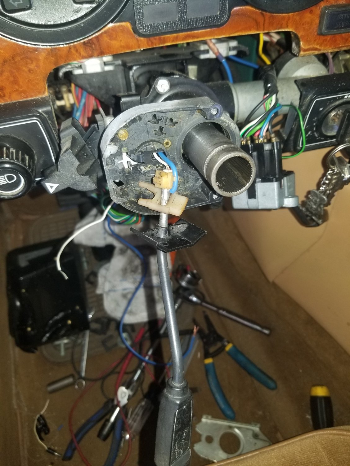

I alreadyalrd all shrouds off, had to go further, took wheel off and had to dismantle the turn lever switch, that was fun!!!!
Dound the ground wire feeding set switch has been cut, leaving about 1 inch of wore, not enough to splice to inaide the turn aognal switch, so i managed to the the old ground wire off of the stalk as its only interference fit between the stalk itself and the plastic base. All good now!!!

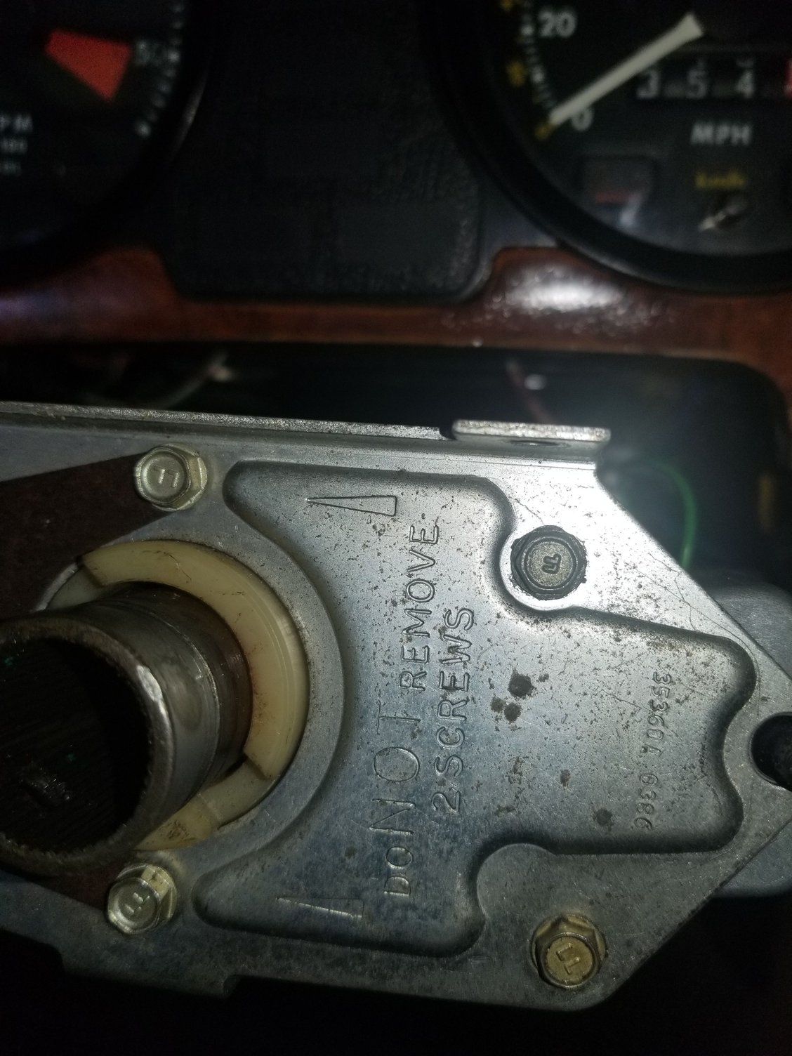

They really mean it!!!! Once you remove those two screws pay attention, inside there are 3 spring, 4 plastic caps, 1 ball bearing, 1 plastic sleeve and 1 metal contactor that goes in sideways!!!
you can see the new blue wire, that i ran.. entire switch housing is plastic, so no worries about floating grounds, and as you can see, the white wire is from factory!
