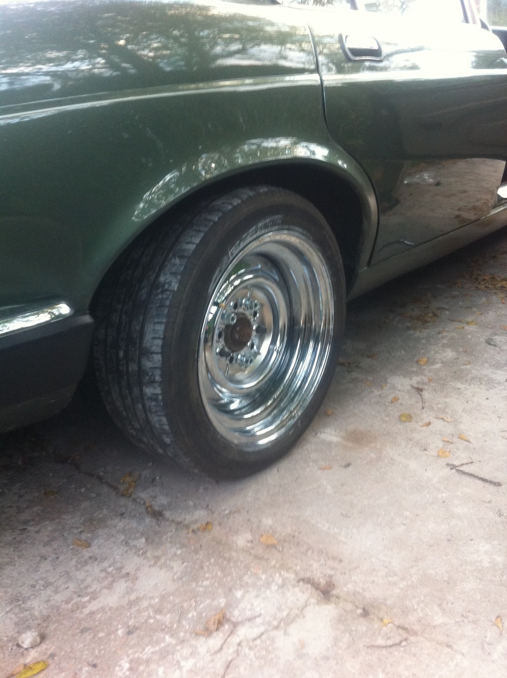

Right, i've dug my paperwork out and on my 7" x 15" Cragar chrome smoothies the back space is 4 & 1/8" (104.78mm) and the front space is 3 & 7/8" (98.43mm)
Here's a few mock up pictures - ignore the tyres though as they were too low a profile

Nice wheels, where did you get them from and did you modify your arches to fit them?
