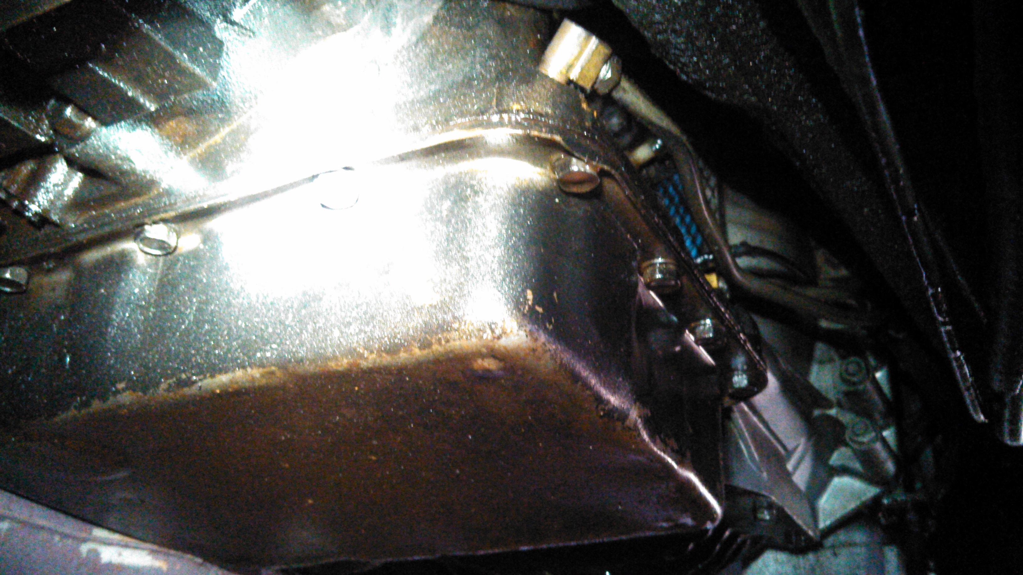

Well, I'm not sure if this is good or bad.
My mate came round yesterday and we lifted the car. We felt good just doing that much b/c that takes some care.
No wetness around the seal or the propeller. We couldn't test whether there was u-joint movement because on the BW12 set up the shaft is encased, or at least is in my car. We could get our hands between gaps in the casing but only enough to feel that it was good and dry in there (casing has bolts but we'd need to be on a lift for access).
However, we were amazed that the reservoir type thing into which shaft goes -- from my manual I think it's officially called the transmission extension housing -- was all wet from where the two parts of the reservoir bolt together. To touch the screws/bolts seemed tight. This left us puzzled for awhile until we just put on a wrench to see what would happen and all 16 could be turned 3 or 4 times with a wrench!! To the eye it wasn't gaping open, but to a liquid or gas it was wide open.
I will start the car and move her back and forth a bit later today but I expect this explains the leak.
Will it also explain the bump b/w R and P? I'll see what happens when I move her.
I don't think I understand how the tranny works well but the manuals talk about pressure in the system: Has mine been way under pressure b/c of the leak/soft screws?
Is this a red herring? Is it wishful thinking that closing up the reservoir right will have a big impact?
Thanks!

You have been super helpful, Amazeing. Thanks.
I'm positing a pic of the reservoir at the back end of the tranny and this also shows the bolts that were really soft.
Test drive and update soonish.
If problems persist I'll make a separate post and see if people have pointers.
