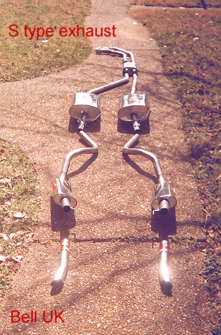

below is a picture of the Bell Exhausts system I purchased from SNG Barrat for my '65 S type.

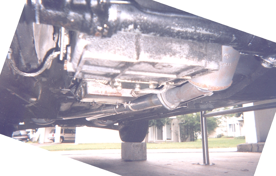

I hope this answers your questions. The only picture I took is below, you can see the front "Y"-pipe-to-catalytic-connection, the transmission-to-"Y"-pipe clamp, and the two new mufflers in the distance.
