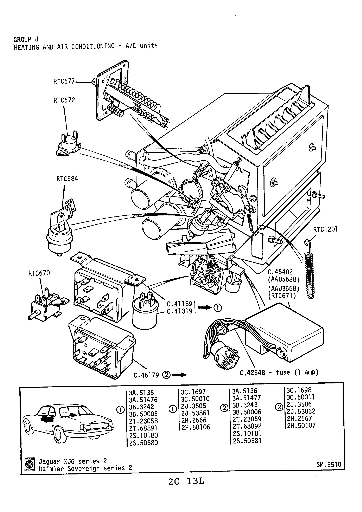

Hi Everyone,
The aircon on my S2 is blowing at maximum speed no matter the setting that it's on. I'm thinking it's the fan resistor and I've picked up a used one from David at everyday XJ some time ago.
Would anyone be able to point me to the location of the resistor? Hoping to tackle this over a weekend.

Upper left corner of the HVAC case
While you're there clean/check/tighten all the connectors at the big blower motor relay (part # C46179 in the illustration). This is more likely where the problem lies. It is actually four relays in one box.
